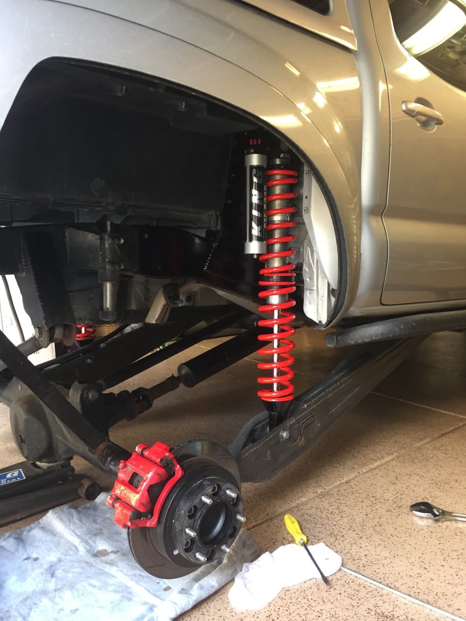

    NO the Ruffstuff links will not work on a second or third gen taco the length vs CO mounting point are all wrong. This same issue holds true for every generic pre fab link I have seen. If you are going to buy pre fab links go with taco specific links IE: Solo or as someone else mentioned the complete 3 link kit from @dirt designs he has really dialed in the geometry amazingly well. I am going to mod my pan hard to match his design as I made a mild mis calculation in my design...nothing wrong really just that DD dialed in the pan hard positioning so well that from full bump to droop his kit only has 3/4” of lateral sway.
    about the lateral sway - I only noticed it for the first week, it’s no big deal at all compared to the massive benefits gained IMO
    ...it’s actually just a well positioned 12” CO. We crawled under the truck with rulers, tape measures, string etc for a few days mocking it up and laughed when we realized it would still pull 18-20” with the CO’s under the bed. All said and done right at 20” bumped and strapped. Front link pivot is on the side of the frame and it bumps at the bottom of the frame.
    You can kinda make out the angle of the dangles in this pic. The one admitted real pain in the ass with links is that you need massive jacks stands to be able to droop the fahka out in the garage...
