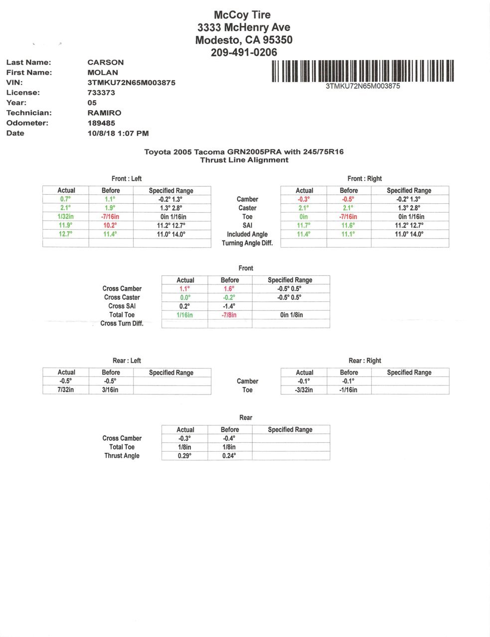

    So hoping for some help I installed an All-Pro(blems) +2"LT kit and the alignment shop cant get my alignment set properly
    they said the camber is maxed out
    any ideas how to fix this
    it tracks straight but feels like it doesn't want to come back to center (hopefully that makes sense)

    You need to get camber set the same on both sides, that will cause all sorts of fuckery. Also probably want to to get the toe tweaked a little so it's slightly negative on both sides, not nuetral on one and negative on the other.

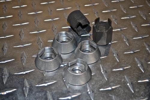

    Chromed out radiator cap
    @VolcomTacoma
    The part number I got was from grainger.
    2FB72

    Thanks man, I already order 4 I found for the lower bolts and 4 I found for the upper bolt. When they show up, along with everything else I ordered I'll be ripping apart the front end to replace some stuff, and I'll check to see if they match up well

    I'm taking it in tomorrow to have them fix the camber issue thanks

    Good luck. I like to run -.75 for camber, but any slightly negstneg and symmetric number will work.

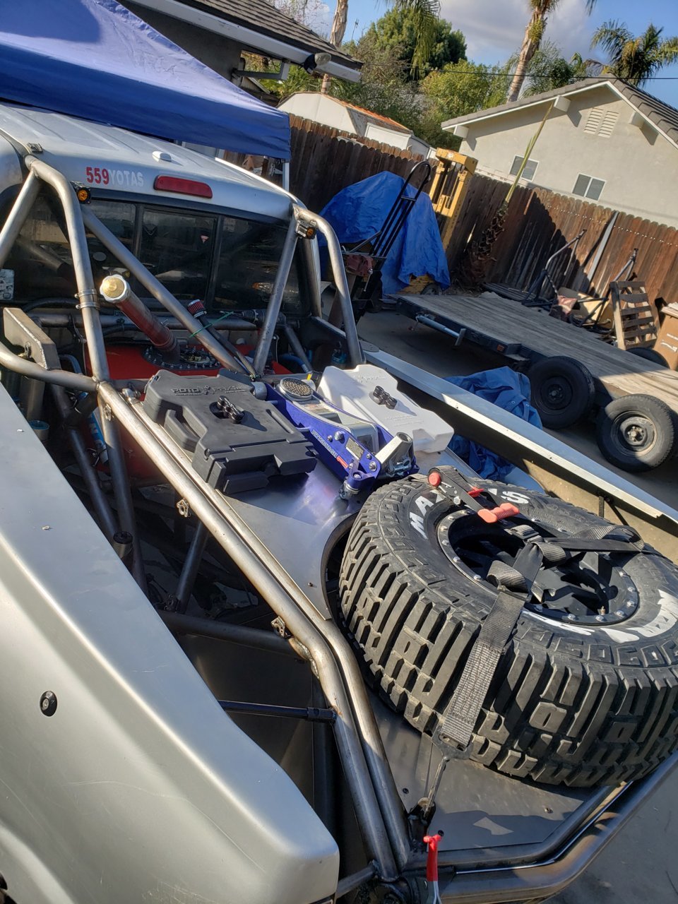

    Trunk is all boxed in now...just need to make two outside cover panels and bead roll a few of em then that can get checked off....shit never ends

    Is that full bump? Or will you limit it a little higher?

    That's full bump lowest point on the rear is like 8" off the ground lol
    If your referring to the shock shaft that's showing, when it's at bump and articulated with the swaybar on theres like 3/8" of shaft still showing

    When you bead roll the panels aren't the panels going to shrink up a bit and you'll loose your pre drilled bolt hole locations ?

    Nice. Nice. picture makes me like your rig more.
    I also like your jack...
