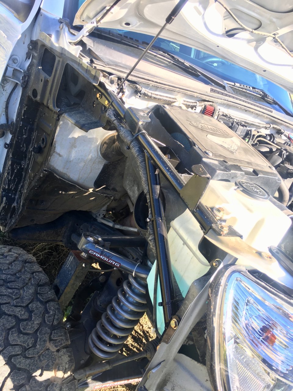

    Well today's original game plan was to solid mount and gusset the lowers since I'm tired of alignment going out.
    Checked the alignment before starting since my steering wheel got donked crooked after my last rip through the forest. Castor and camber are spot on, so apparently it's just toe that I keep fucking up. I mean I do have the tc cam tab gussets and after my last alignment I tacked the cams in place so I'm glad they are doing their job finally.
    So new game plan is to just gusset everything up, throw some heavy tacks on the cams that will still allow me to remove the lowers and keep them in place and call it good. Just need to find someone with a lathe since my tie rod extensions are not allowing me anymore adjustment. Gonna take 1/2" off and wait for the rack to blow out and then upgrade.

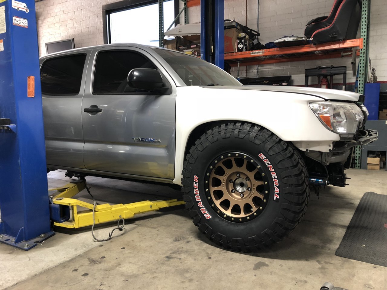

    Hey, So im probably gonna jump up to 3.0s in the rear, talked to my shock guy he said it should be fine. What do you guys think I know a couple of you have ran them before with dmz. Keep in mind I have a full bedcage in the back and 2 full size spares so have a good amount of weight in the back.
    nate232 and Dalandser like this.

    I say go for it, of course plenty of tuning will be needed.
    nate232 and Tbasch[QUOTED] like this.

    You might need to do some clearancing for the 3.0 depending on your mounting location. Other than that, 3.0 would be benificial (in my opinion) with the extra weight.

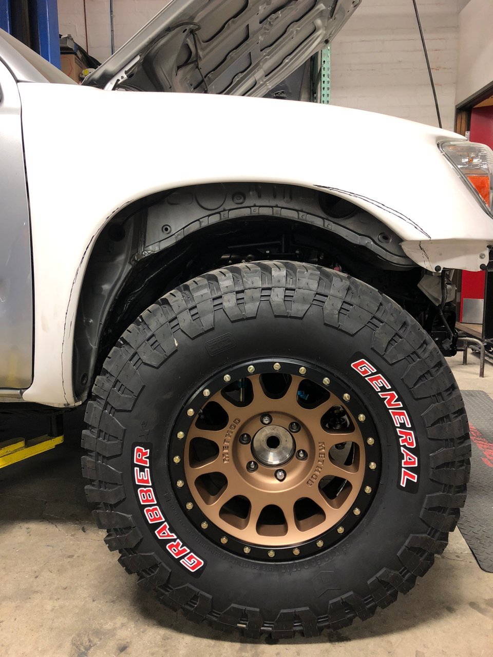

    Stuffed tacos are the best :headbang: Also, they are having to trim up the glass for clearancing, and also the wheel wells a bit. I’m surprised that not a lot of people do this. Out of all the LT trucks I look at, I’ve only seen a couple do something like this...

    Yea Ill probably need to trim the inner fenders a bit, but other than that I think I'll be fine,

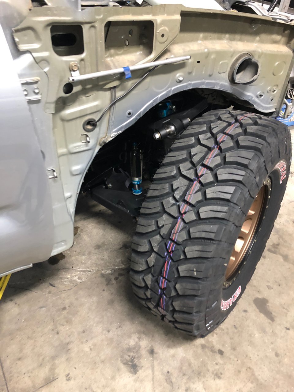

    I was thinking more of the frame side or tire side. I’ve heard of people notching the frame so can mount the shock more inboard and away from the tire to help clear. I know you have to run spacers to clear the 2.5’s.... could be wrong though.

    My frame is already notched :thumbsup: and I'm running spacers 1.5s or 2s idk I forgot which ones lol

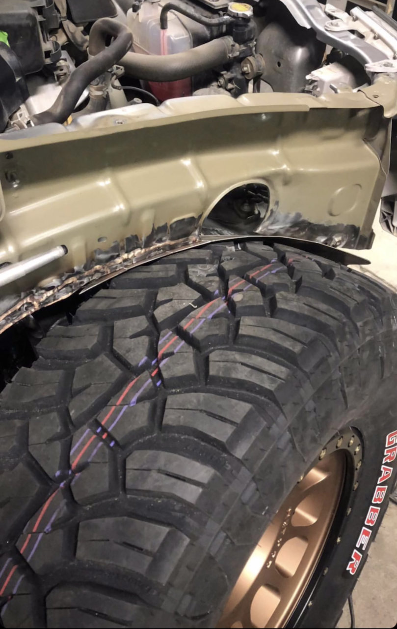

    Ive done it for the some Lsk trucks I have built in the past, it sucks cutting that stuff out and remaking new platework its a lot of nasty work.

    Yeah it looks like it. Especially moving around the internal components around the wheel well. Maybe that’s why it’s not done much

    Mine is just self clearancing for now lol. Though when I start on the cage/ engine cage this spring, I'm just gonna chop the whole core support out. All the clearance you need
