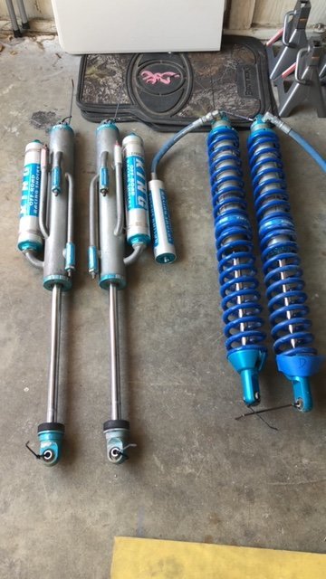

    According to Tim at DMZ you can mount the shock 1/2" from the frame and it won't rub. His words.

    Yea my frame is already notched so may have to open it a bit more by the resi, or overall. gonna have to see if I can get some 3.0s to test fit. If not probably get them on and do some extra clearance from there. We shall see :fingerscrossed:

    Gotta find a set to test fit is best. going new or used? Ive seen a few sets right now, what brand?

    Used Kings, Im talking to 454 in norcal about some hopeing he can ship. But ima try to see if I can find some to test fit first.

    I believe mine are mounted about 1" from the frame and can confirm that with that, the shocks will not rub the frame. 2" wheel spacers and all bypasses layed out forward and the tire won't rub the shocks either.

    Too bad you weren't asking this two weeks ago had my 3.0s pulled. Could of test fitted them. But truck is at solo now with them back on...

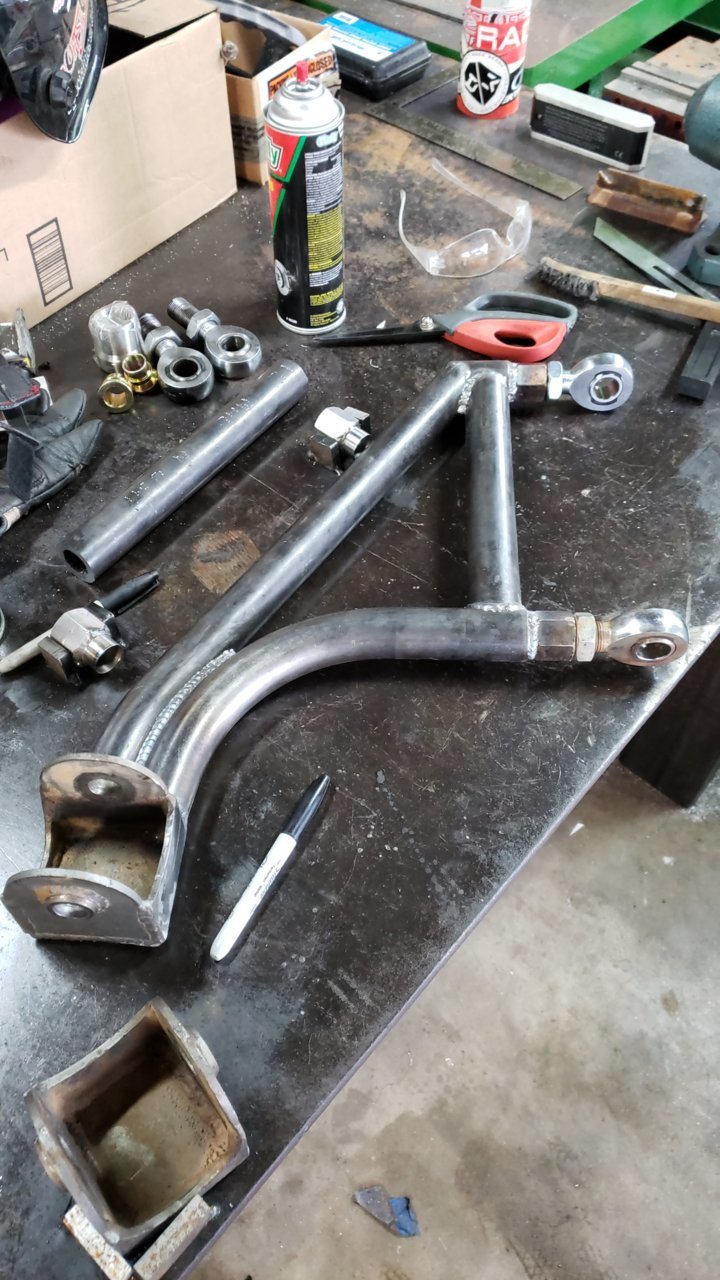

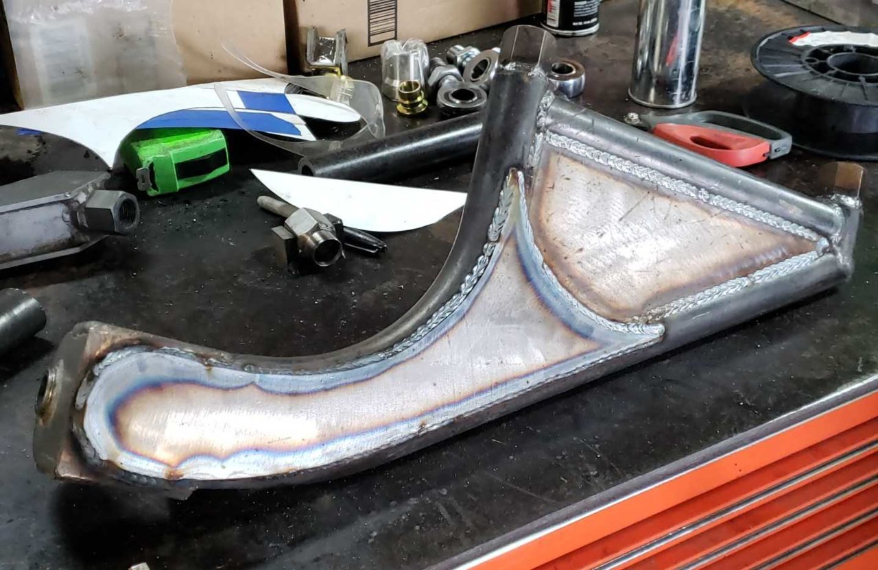

    Since my version 1s seem to have failed (bent and cracked) Version 2 uppers or goin for all the beef lol. 1.5x.25" DOM boxed in with 3/16" plate and overplayed top and bottom with 3/16". If these fail the arms were ripped off along with the frame of the truck lol

    Those are sexy! Nice work! You have a fancy tube bender or just a JD2 with a ram?

    Thanks!...just a JD2 with a ram bends it no problem

    I was curious about 0.25, but I’ve barely used mine

    Well I got the model 32 with the bigger pins...it says it can bend 2" .25 wall....I was using my roommates model 3 to bend this since he has a 1.5 die and it did it no prob

    I also have the 32 haha. But good to hear!
