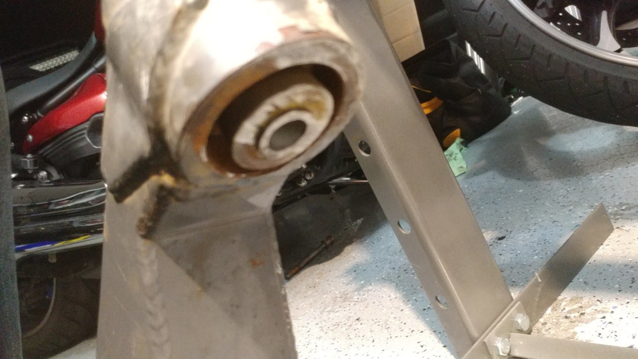

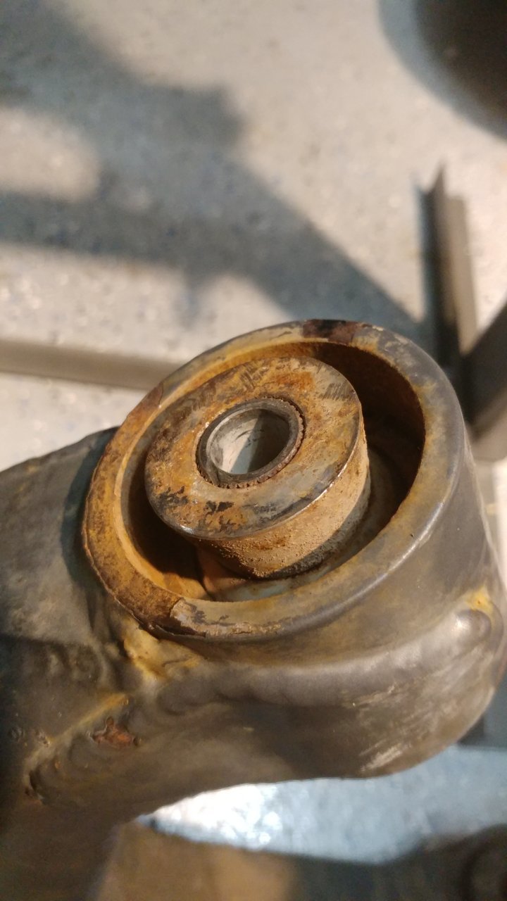

    Get some Mastinox slather the misalignments and the new bolt in that shit when u put it back together...it will never seize in there...use the stuff on helicopters all the time...have pulled out close tolerance bolts out of old crusty airframes from Vietnam and they still look new cause of the stuff lol

    Try heating it up with a propane torch and touch some candle wax to it. It's an old trick I learned for seized bolts. The wax will wick into the tightest nooks and should free up some movement. It doesn't have to be cherry red for this to work either, just hot to enough to melt the wax. Once it cools, you can try working out the seized sleeve. Also don't use your wife's soy candles either, soy wax doesn't wick the same as regular candle wax. I use cheap birthday candles and it works really well.
    Edit: just saw you got it out. Still a good trick to keep in your toolbox for the future.
