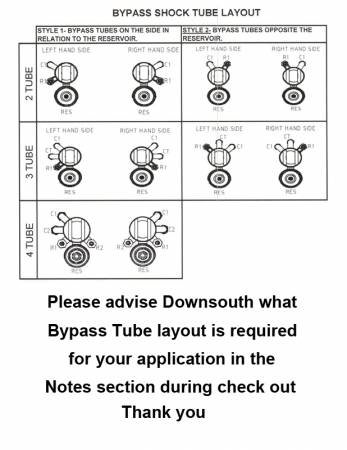

    2.5 x 16” triple bypass, and piggyback will work fine. If your order with the bypasses all layed out facing forward you will have more tire clearance under articulation. If you think you’re a badass you can run 3.0’s but will likely have to notch your frame
    Style 2 is the bypass layout I am talking about. B4054DBE-7546-46D4-BA7A-1DEF64ADF841.jpg

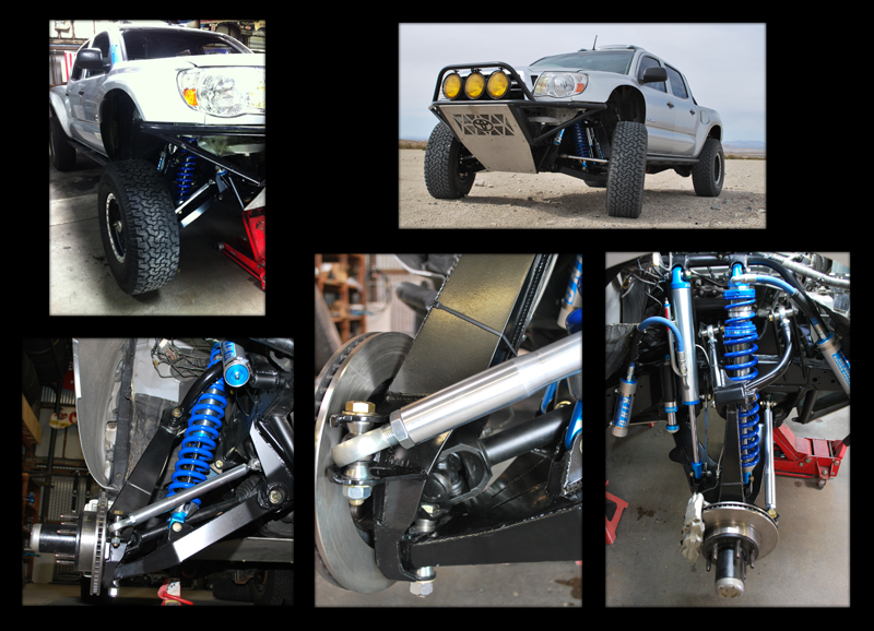

    Would these work for a TC +2 @glorifiedwelder ? Just know you put a lot of kits together. Might pick them up and ship them for another member. 8"

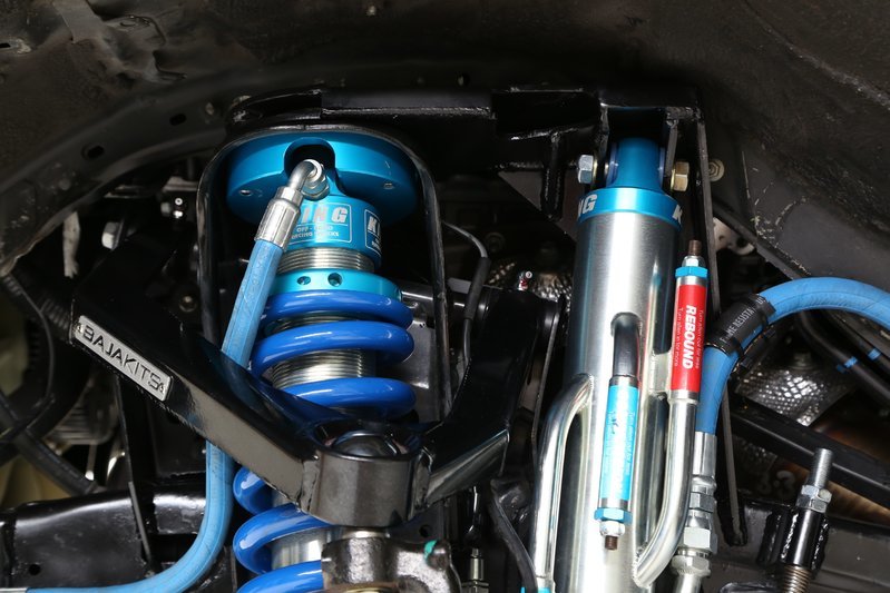

    Most long travel kits w/ piggyback secondaries have that tube layout, but not sure about the +2 kit - the BajaKits one is the only one I found in a quick google images search that uses another tube layout.

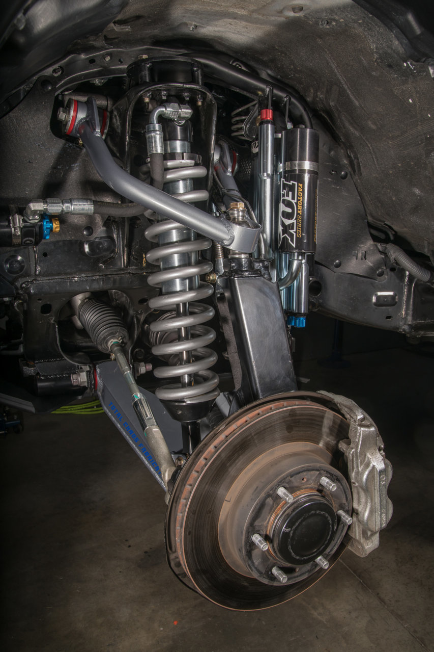

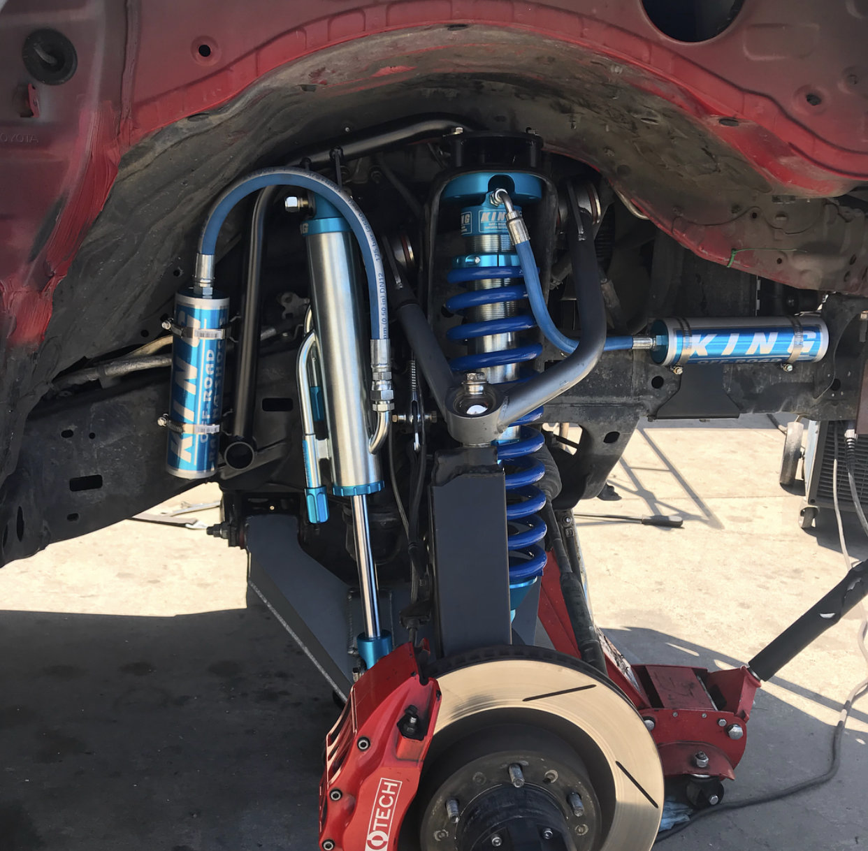

    It’s hard to say. The shock configuration is a little different. Swapping to a remote reservoir will free up some space, but the overall shock is also a little shorter than the tc spec’d bypass since it has the weld on rod end. The price isn’t bad, but it’s not an insane deal either. If the buyer likes to fabricate and tinker with shocks it could save them a few hundred bucks. But if they plan on using tc’s shock hoops and don’t want want to have to deal with possible fit issues and converting shocks to remote reservoir I’d spend the $150-200 and buy new.
    Here’s a pic of a tc supplied bypass
    LTDSC, tacomgee and Dalandser[QUOTED] like this.

    @tacomgee
    Thanks Jason.
    tacomgee likes this.

    I've never seen a piggyback secondary used on a Tacoma. The tube layout shown in BajaKits photos makes the most sense to me.

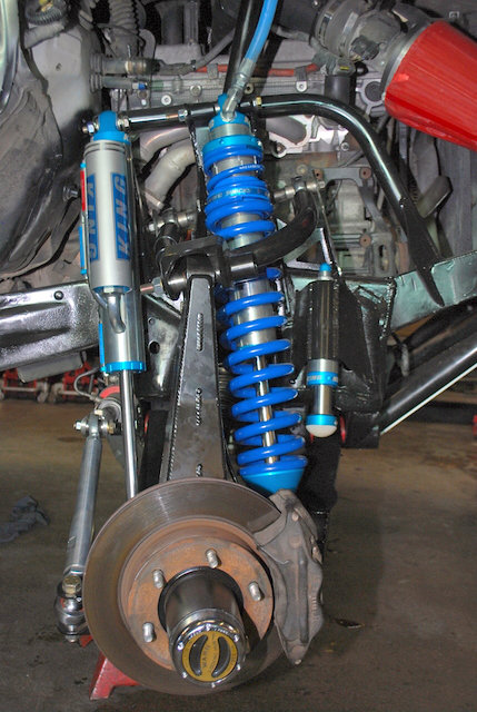

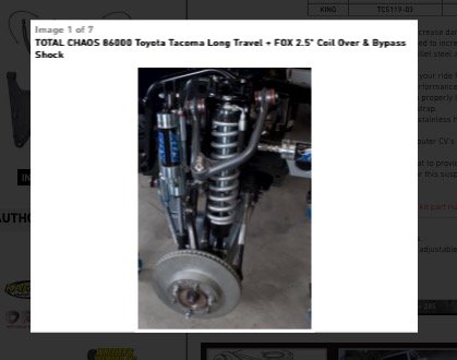

    TC has a couple pics on their site - that first one I posted was from their regular 3.5 kit fenderwell pics
    and here's one from their 3rd Gen Overland build.
    https://www.chaosfab.com/2016-Toyota-Tacoma-Double-Cab-Long-Bed-4WD
    Here's one on a first gen
    Piggy backs are less common for sure. Tubes towards the firewall may keep them further from things like upper control arms and wheels / tires. Baja Kits layout seems nice as far as access to the tubes though.
