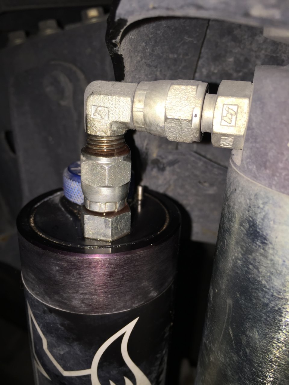

    Alright guys, so i got a little too exited with my new fenders that a new problem just happened.
    The rear shock seems to be leaking from the valve. Im not sure if this is an easy fix (i hope it is) or if i just pretty much fucked up the shock. :(

    Throw a wrench on it and see if you can snug it up. Don’t use too much force, but my guess is that fitting is just a little loose

    Yep wrench on the 90 degree fitting to hold it and tighten up the nut.

    Alright cool, thanks man. Hadnt seen that before. I already tighten the valve. Hope it was just loose.

    Yeah if it was leaking from under the 90* fitting then that's pipe thread that seals as it is tightened more.

    Actually I don’t think Fox uses NPT which is a good thing because you can clock their fitting however you need too and then snug em’ up

    It seemed like this kind of fitting that I was messing around with on my coilovers when I needed to swap out this 45 for a 90. Thought the part on the right was pipe thread, but maybe it's just like a brake line fitting where the conical piece seats to hold pressure - those threads on the fox fitting looked thicker for some reason, but I guess it could be the same fitting I have.
