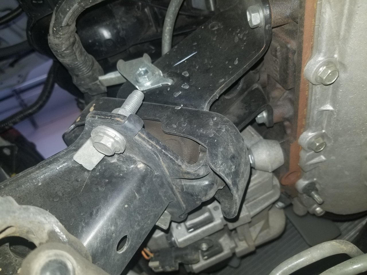

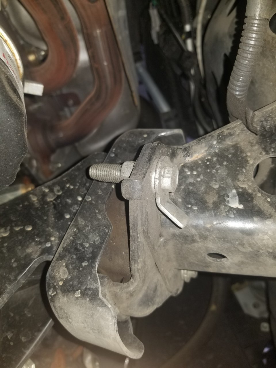

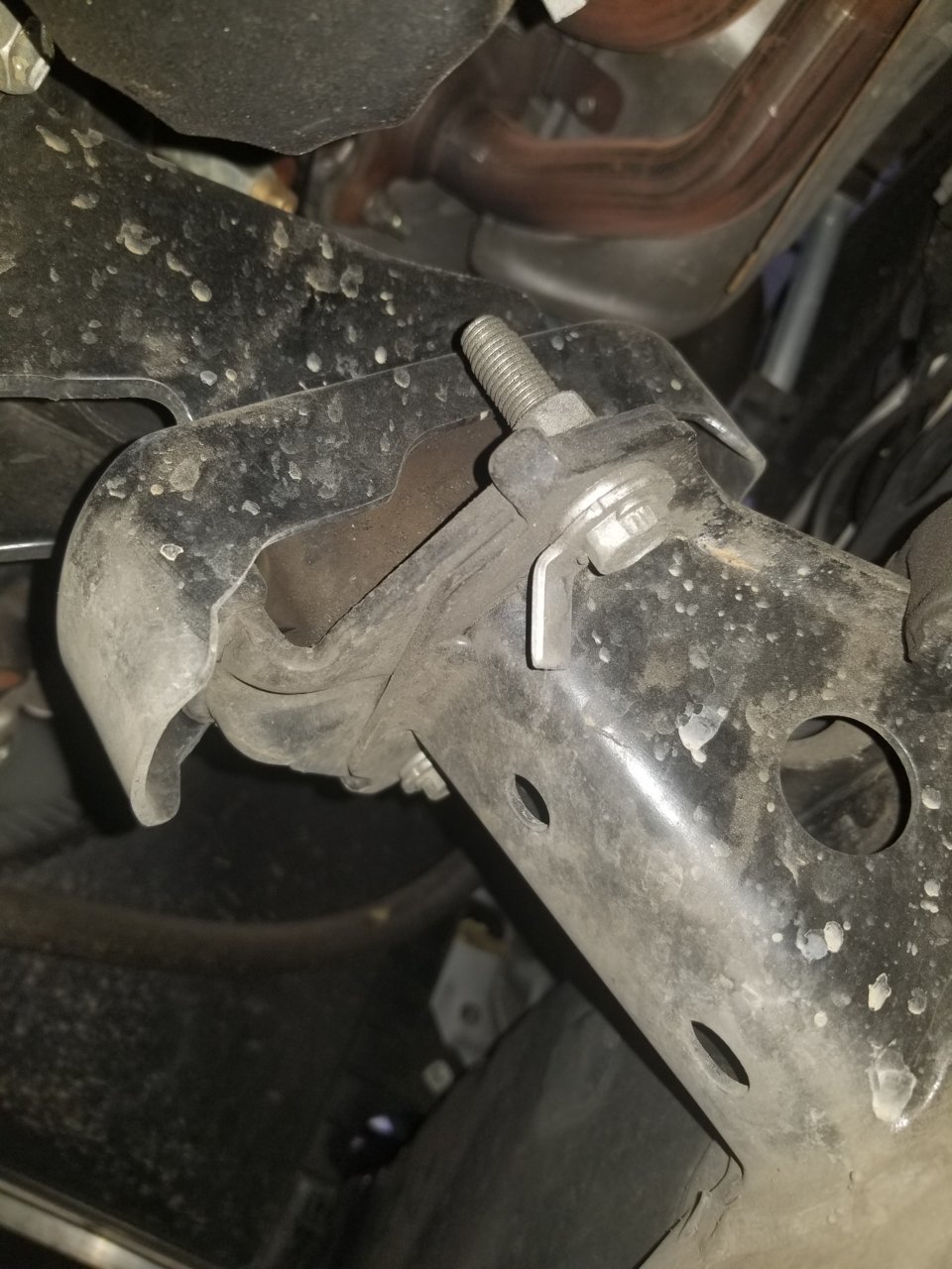

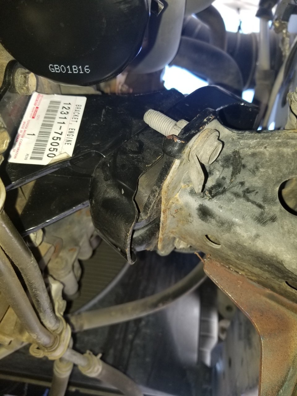

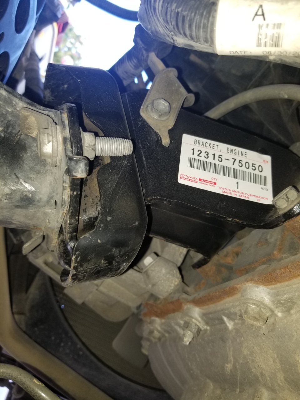

    The bombproof mounts are the same on both sides. Maybe that'll be alright for this.

    A thing or two...
    For 1st gens, the isolators are the same on both sides.
    It looks like the TG mounts replace the isolators, so maybe they could work if they provide enough adjustment.

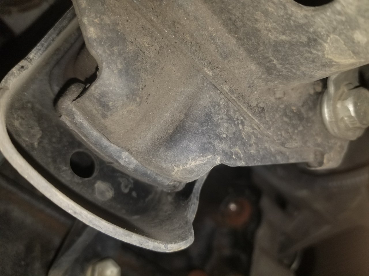

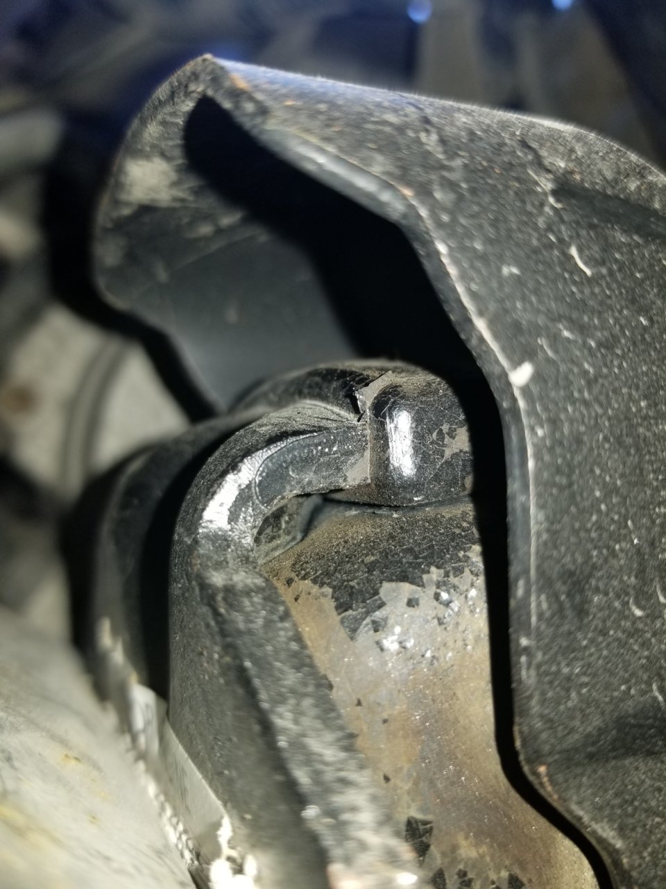

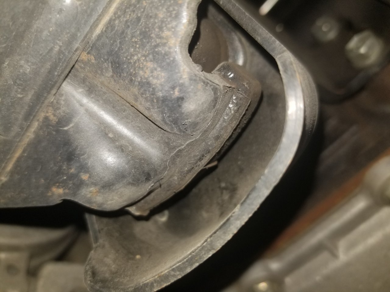

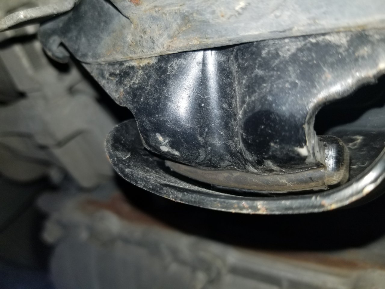

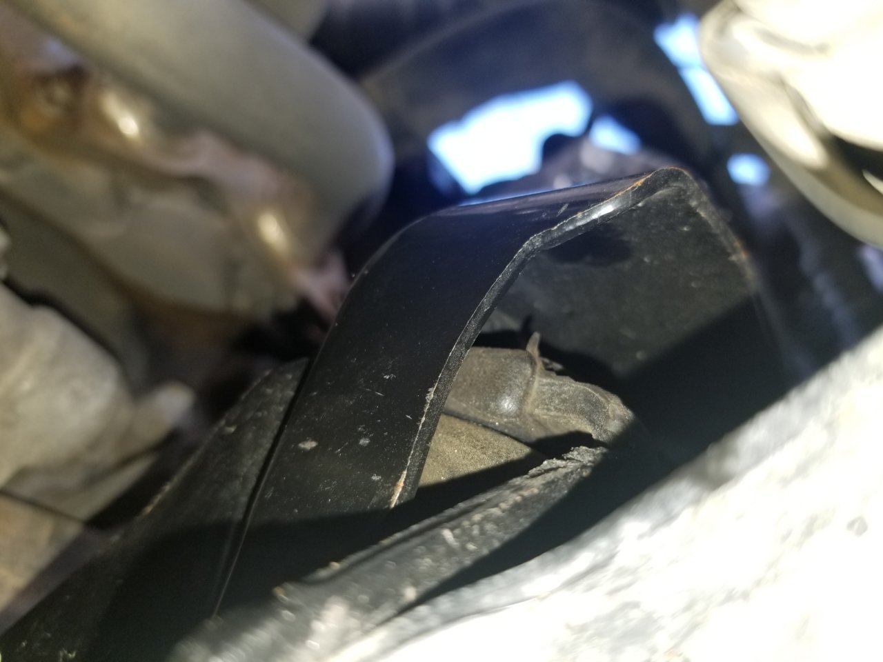

    ya so mounts are done hahah went to hard i guess

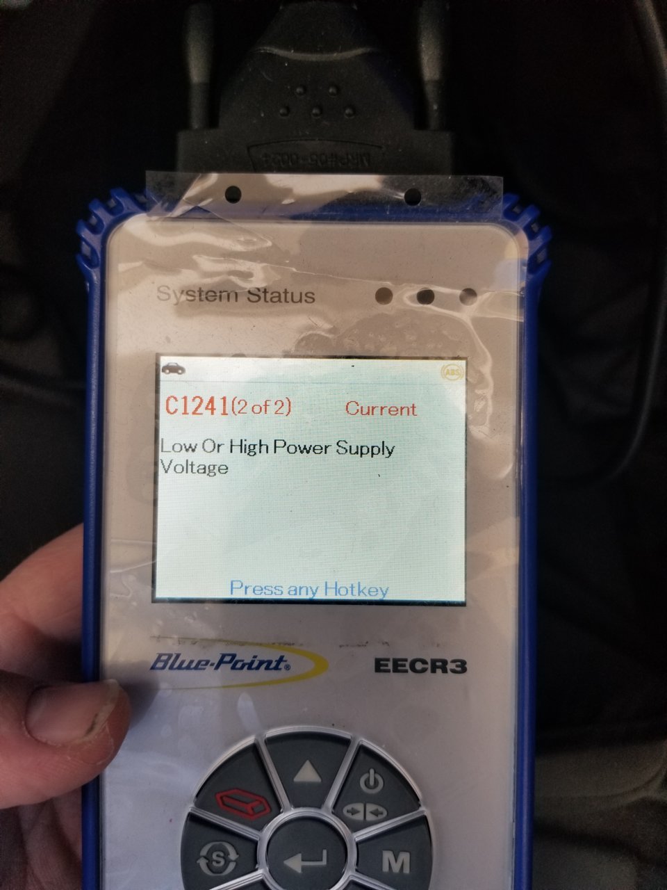

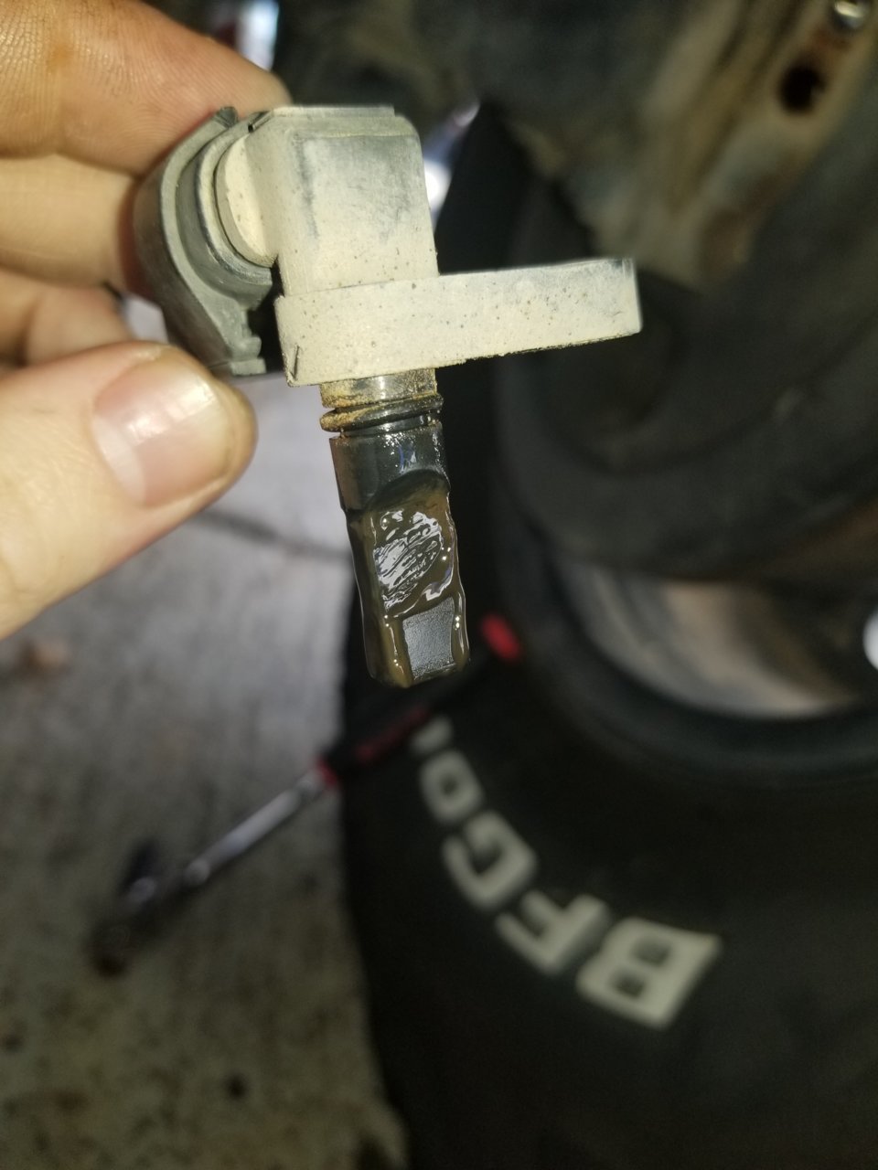

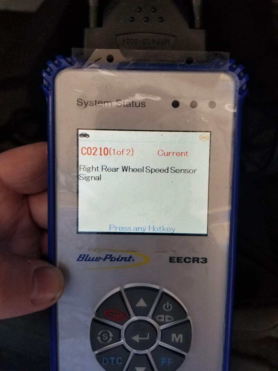

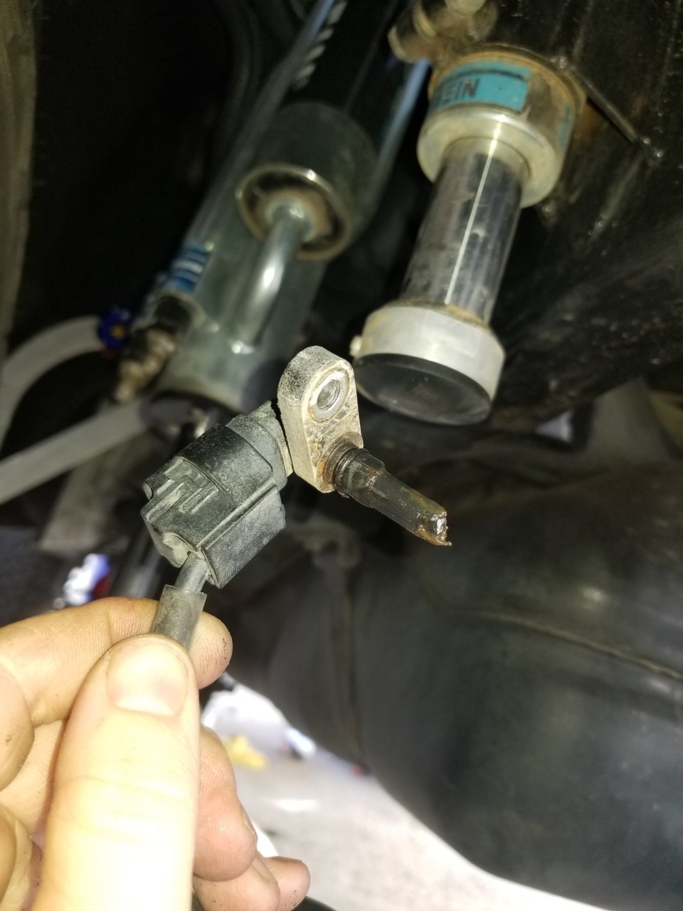

    That ABS light is most likely a wheel bearing thats gone bad. Ive had it happen to me and a couple of others that I know. The bearing goes bad and the magnetic strip on the bearing stops spinning and the the ABS gets no signal and gives you the ABS and brakle light at the same time.
