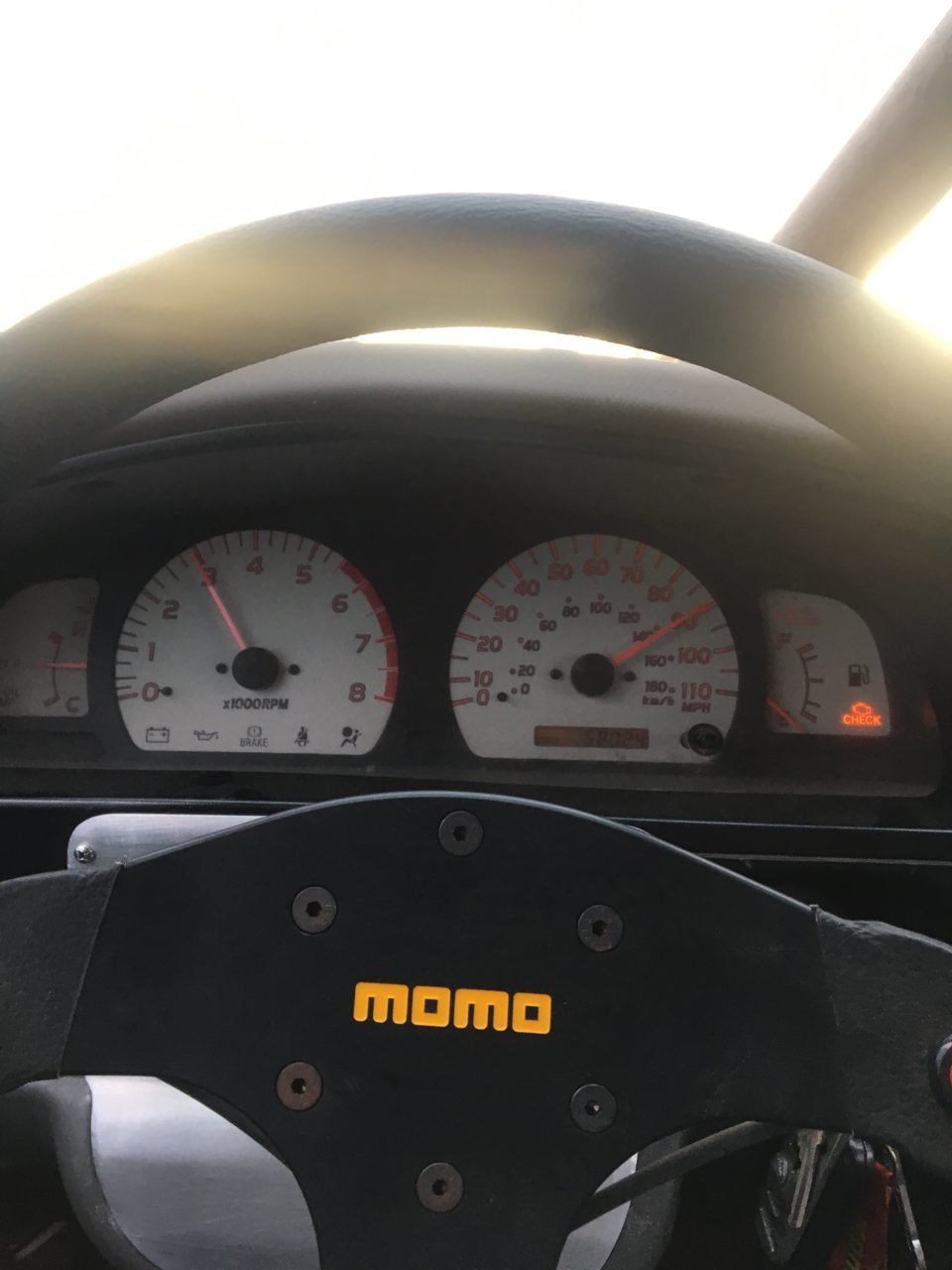

    I'm like 3k rpms going about 70 with 5.29s 35s. Auto. I mean our trucks are built/modified for dirt so is it really that big of a deal lol :facepalm:

    i agree it gets up and goes pretty good in my opinion
