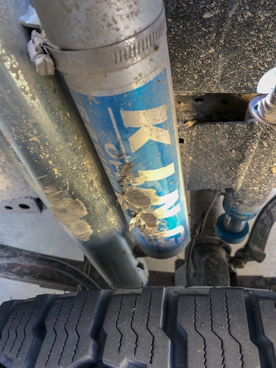

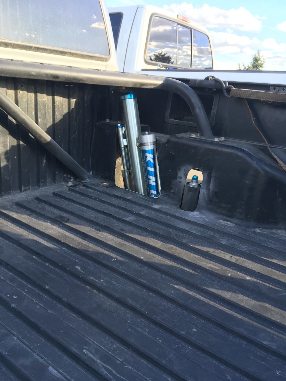

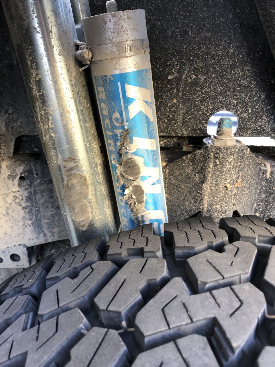

    Looking for some advice/suggestions. Here's the back story:
    Had a DMZ sua, with 16" bypasses and a bed-cage, installed at a reputable shop. At the time of install, I was running a 285 tire on a wheel with 4.5" bs. A 1.5" spacer was added at the time of install. Taking it out and fully articulating the rear, I noticed the tire rubbed the bypass tubes. Soon after, I went to a 315 tire. Knowing it would really rub, I swapped sides so the bypass tubes face the bed. I thought this would give enough space.
    After last weekend, still rubbing the bypass body. I don't do much flexy stuff. Mostly go-fast type driving and smaller jumps. I'm going to put on a 2" spacer for now, but looking for a long term solution. It seems if I can move the top of the bypass over about an inch, it should give enough space. (Driver side rubs worse obviously, see pics)
    Question: should I contact the shop that did the install with their bed-cage and see if they can help with a solution, or even just to let them know it's an issue? Doubtful they'll respond, but who knows.

    Looks like the bed cage and lower shock mounts are off. Both upper and lower shock mounts could be easily 1” further inboard. Just leave yourself 1/2”-1” of clearance to the frame from the shock. I run 2” spacers and do a good chunk of articulating/ crawling stuff and don’t rub my shocks at all
    MostEpic[QUOTED] likes this.

    They definitely tucked them in the bed. I know they can be in more too after talking with other guys running the dmz kits.
    I'll run the 2" spacer for now too.

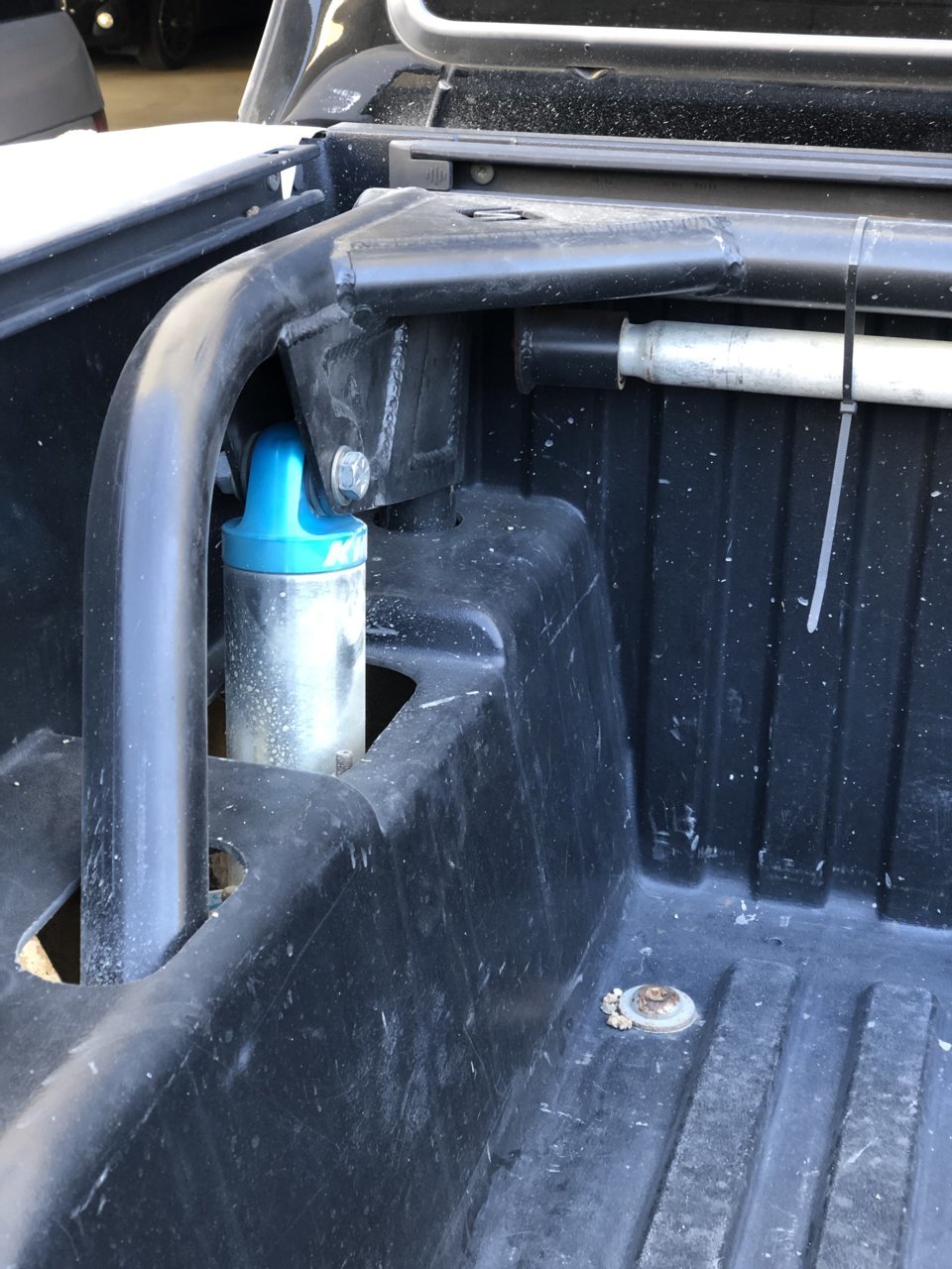

    If you’re having them redo it, here’s aomewhat of a reference to how far in the top can be. This is the DMZ bedcage and they have you completely cut the side of the wheel well to clear the shocks.

    looks like a solo logo on the bed cage, moving the lower mount wont do anything, that bed cage is what needs to move, put a 2" spacer and run it, only way to fix it without hacking up that bed cage.
    MostEpic likes this.

    Yea it is. The install is super clean. But I need functional. Haha. Friends and I were debating running another mount at the top and just moving the bypass over an 1” on the bed cage. Just a lot of work, that cage is tucked and no way to remove the bed to make it easier.
    I was more curious on the consensus of getting the shop involved and see if they’d be willing to address the placement. They have way more resources and a shop. Haha
