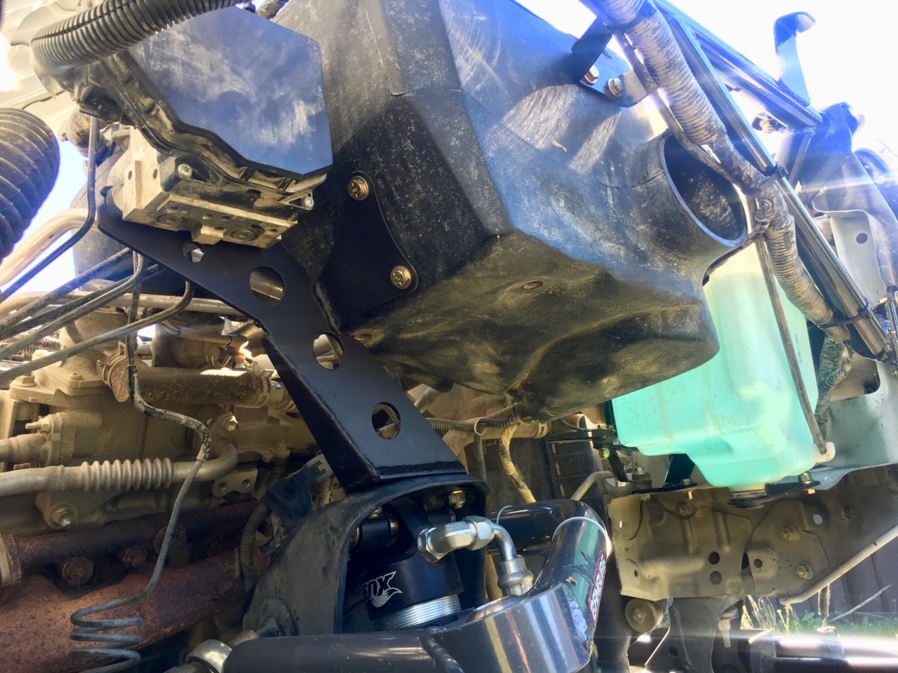

    This is what I had done, left it to my fab guys own descretion
