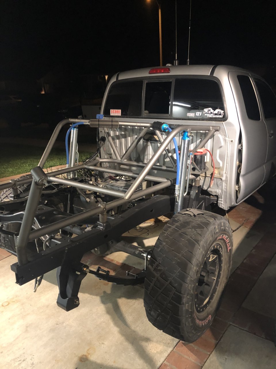

    Well, I am getting carried away with my rear LT install. Want to do all the welding I may ever want in the back now so I don’t have to strip paint off down the road. After seeing the hatch that @89ztrain had on his to put gear in I decided to do one too. Since I didn’t originally plan it and the frame cross braces I did are in the way the opening will be a bit smaller but I should still be able to get my jack, some straps, and some spare parts in there.
    Stayed tuned while I figure out how to box this thing in.

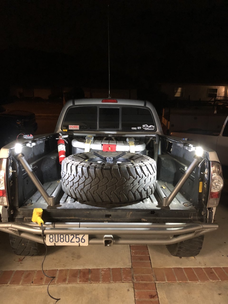

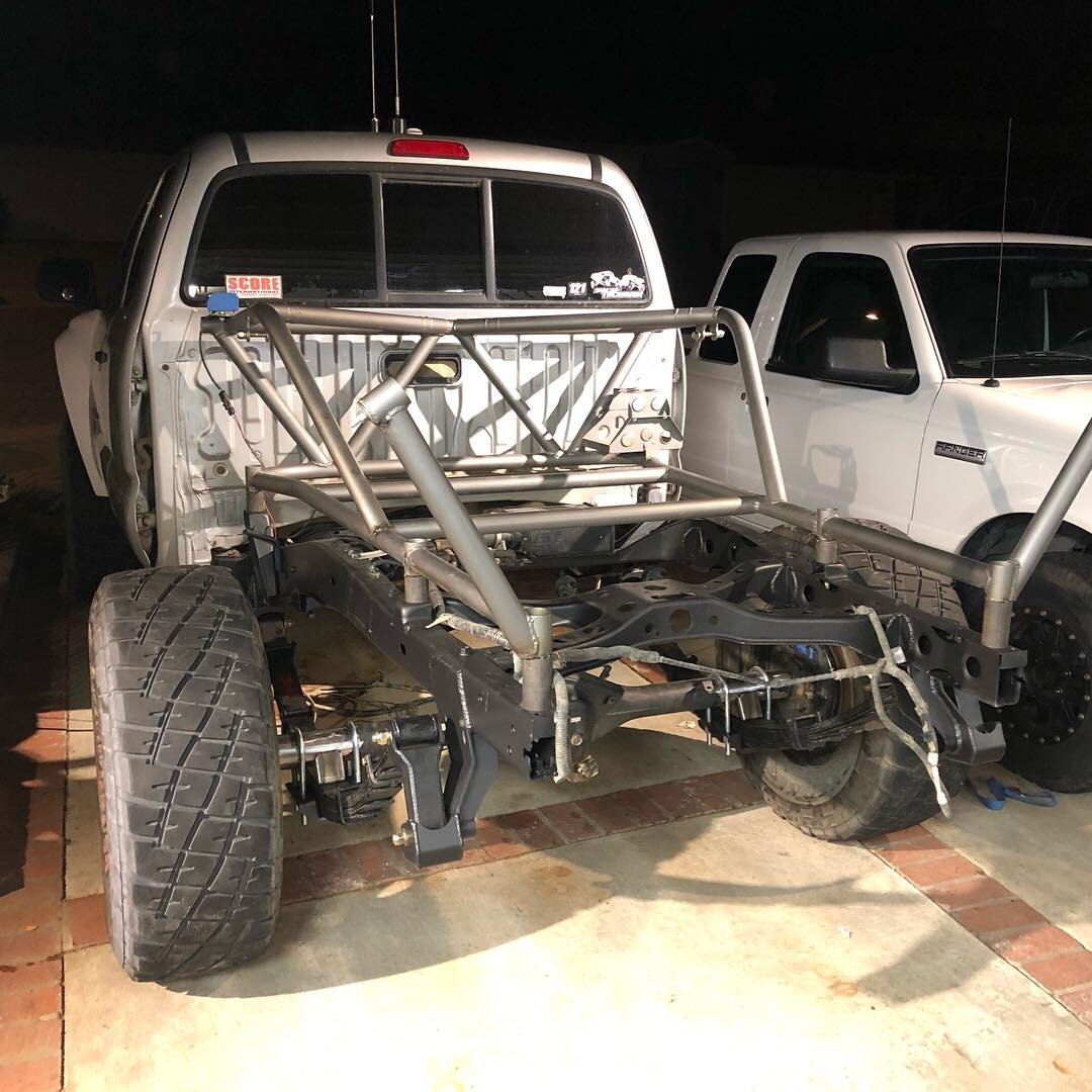

    Yup. Their 11 leaf design is good up to about 1200# above stock weight, even in the DMZ long travel version. They can build an HD pack that will handle any weight you want, but it's thicker leaves and less travel.
    What really got me going on the ford route was seeing the Deaver f150 version of the 11 leaf pack, which has exactly the same increments of weight above stock as the taco packs.
    The relationship between length of the pack, width of the pack and leaf thickness all have to be traded off to hit a particular set of travel and load rates.
    So it's either do some pointless and difficult fabrication work, or put the truck on a 600# diet :) I think we all know which way that's going to go.

    That's based on certified CAT scales, the truck weights in around 6800#
    The first problem is DCLB (all the weights used for springs are based on the short body) so I'm down on cargo capacity to start with, then add armor for north east rocks(1/4" plate), then RTT, Camping Gear, Recovery gear, water, RTT, two spares, etc. I can do it, but not easily, and I'm still right at the top of the weight class.
    I'm also building to move camp every night, so it's not like I can unload a bunch of gear at camp then go hit the trails fast, and come back to camp.
    TL;DR version: why compromise when you have a welder?
