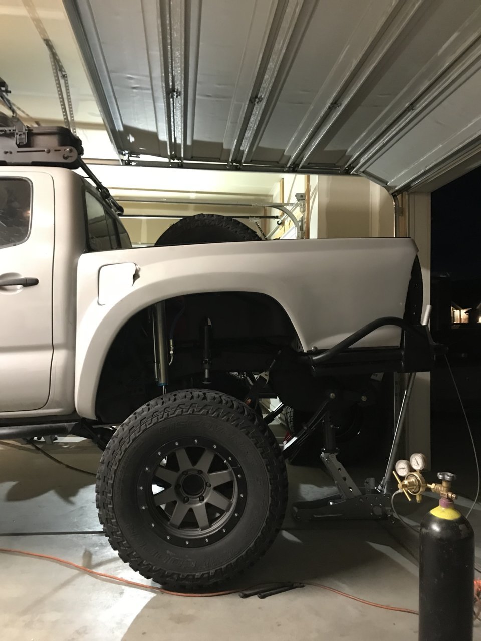

    Final rolled the truck out of the garage yesterday. Took everything the pro eagle jack had to fully droop the suspension out to charge the shocks.
    Just need to bleed my brakes, mount my resis and replace the diff fluid and she is good to go.

    Looks good man! Those bumpstops look really tall for such a short stroke...what length are they?

    They were 3" stroke originally when i bought them. I shortened them to 2". I am pretty sure though that with this model of fox they can be 2-4" depending on which spacer you add or remove.

    Cool, gotcha. The top part just looked far longer than the stroke out the bottom. Truck looks dope.
