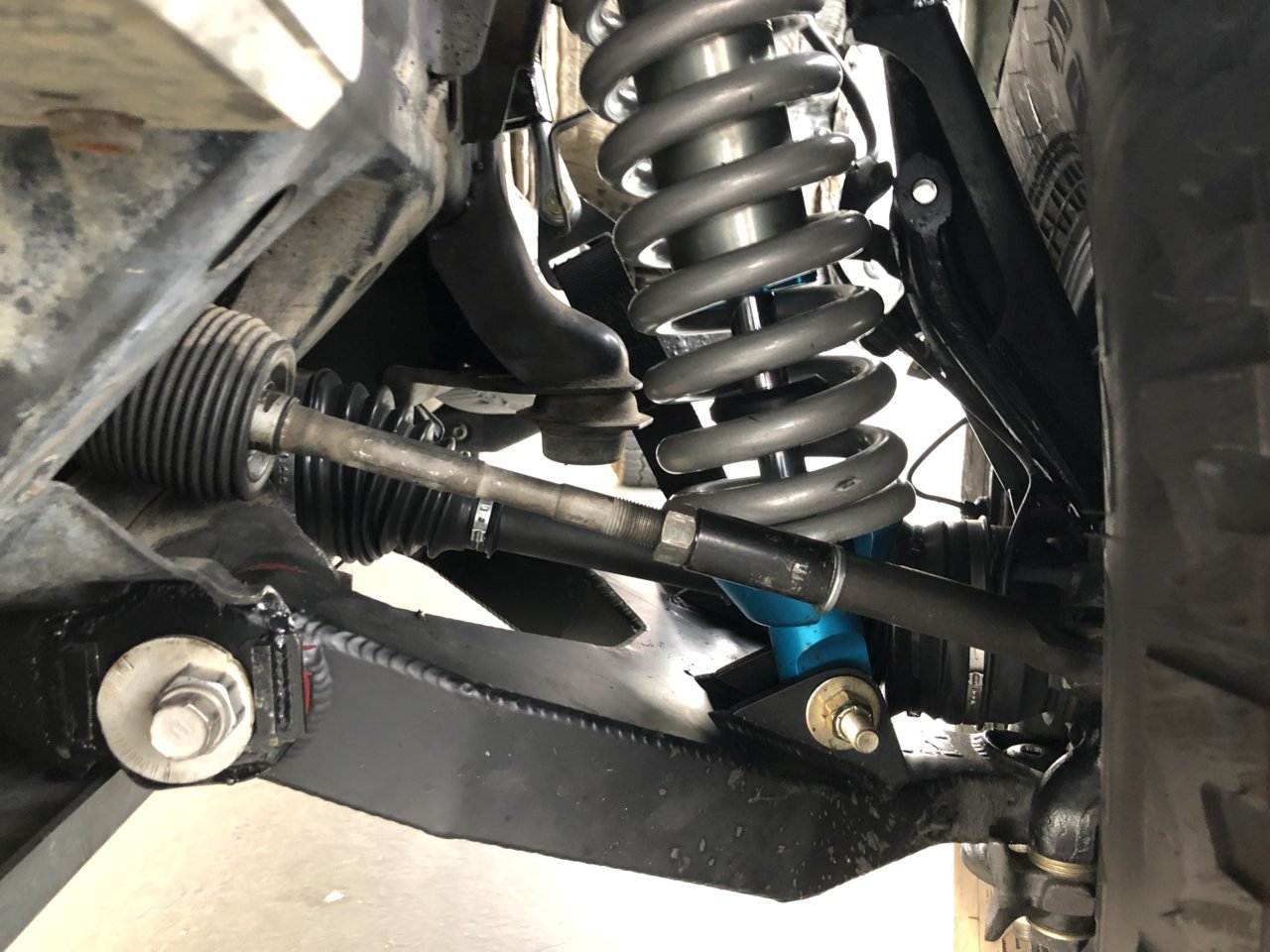

    Roger, thank you for getting back.
    I meant to ask you - Do you have rod extensions on your Kings? I couldn't clear tie rod with the standard ones, had to buy 2" extensions.
    Ignore how the tie rod extension is setup right now.
    94jdmeg6civic likes this.
  13. Apr 10, 2019 at 7:01 PM
    Evenflow
    Evenflow Well-Known Member
    Jul 15, 2013
    #108344
    5,766
    Jason
    San Diego, CA
    06' DCSB 4x4
    Yes
    no bypasses
    eyemajeenyus[QUOTED] likes this.
  14. Apr 10, 2019 at 7:07 PM
    Evenflow
    Jul 15, 2013
    #108344
    5,766
    Jason
    San Diego, CA
    06' DCSB 4x4
    Yes
    if you look close you can see that i do not have an extended rod end but i have the extended lower coil seat
  15. Apr 10, 2019 at 7:15 PM
    socalexpeditions
    socalexpeditions IG: @socalexpeditions
    Sep 22, 2017
    #230791
    5,405
    Got it I can see it, thanks!
