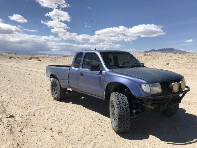

    Made it out to Ocotillo Wells for the first time in a few years now, forgot how rocky that place is.. definitely need to do some valving and maybe lighter springs up front.
