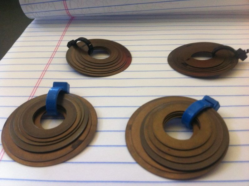

    I found this in my old folder from 2011 when I revalved.
    The first two shims are 0.012" then there is a small spacer then the final shims are 0.020" I think the ones with the blue zip tie are the comp stack and you can see the gap

    First two shims meaning the two largest shims?

    Correct

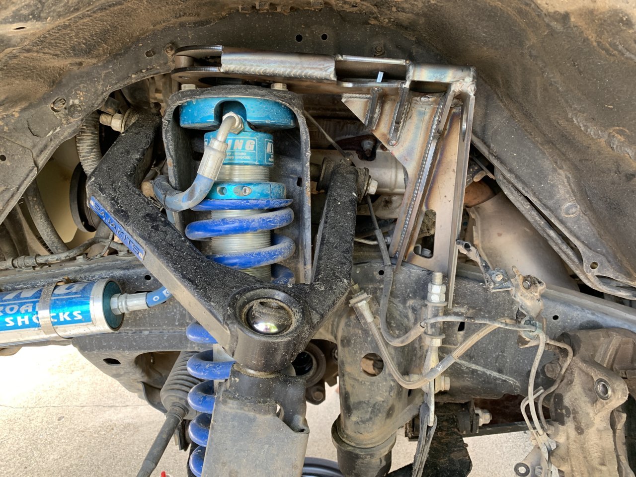

    Test fit

    Good god that’s beefy. Who’s design?

    BajaKits
