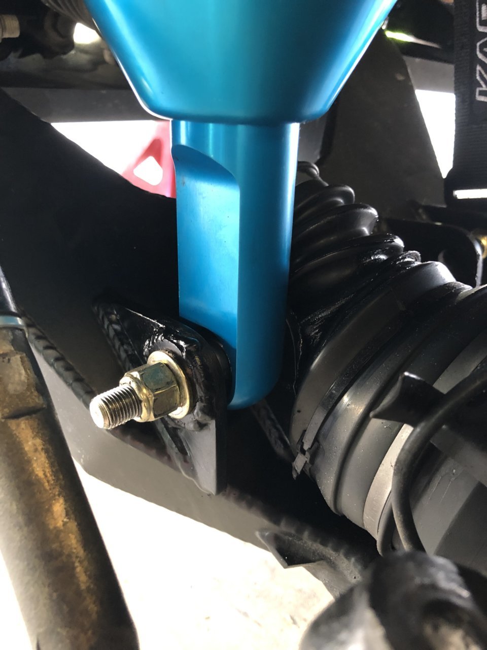

    About done trying to figure this kit out... @Evenflow do your CV boots rub your shock tabs like this? I've tried OEM boots, OEM replicas, and a different style boot (which is pictured).

    2012 Baja TX
    TC 3.5 LT, RCV axles, Demello sliders, BD light bar/fogs, LP6, DMZ rear, SOS skids, custom bumper, King 16" triples, Locked-on hydro rear bumps...
    Sorry to hear the frustration continues...did BK ever state whats going on with it?

    No it's a Solo Kit. They practically said "best of luck." Fuck Solo (excuse my French).

    If anyone is 2wd and wants a +2 kit...hit me up :rofl:
    Honestly probably keep the kit and just let this cv boot keep squirting out grease. I'll end up ordering a different kit one day since I already have the full setup, just need new UCA's and LCA's.
    I honestly wonder what would happen if I just ran a different brand LCA but I'm sure it's a bad idea.

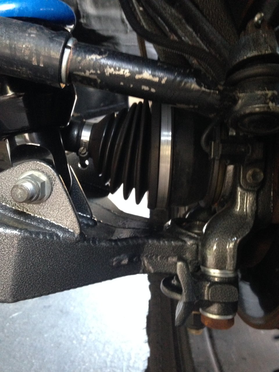

    nope mine don’t rub at all, just had to use the SDHQ boots everyone else uses for long travel and clamp it in the proper positionA8E10E72-8D81-4A85-ADBD-98C9DF945D4C.jpg

    That side's already aligned? The other side isn't rubbing?
  18. Apr 23, 2019 at 9:39 PM
    socalexpeditions
    socalexpeditions IG: @socalexpeditions
    Sep 22, 2017
    #230791
    5,405
    other side rubs as well - the kit is just all sorts of f'd up.

    I worked on it , its just so odd the boot its just right up on the bolt and tab really badly.

    Something is wrong. Your cv looks way to close (duh) compared to the other picture. Is the lower tab on the correct orientation? Arm the arms and spindles on the right side? Is the stub axle seated all the way?
