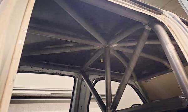

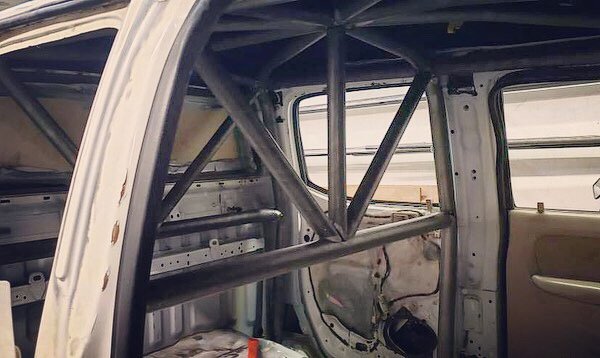

    FlapJack935
    FlapJack935 i member
    Nov 25, 2013
    #117294
    3,196
    Jack
    Abq New Mexico
    Wannabe Trophy Truck
    Sick Gnar Trophy Truck Tacoma and King Ranch Raptor Killer
    Tubes going places
    3pooches, Tacomoto23, Hawk373 and 9 others like this.

  15. May 2, 2019 at 8:12 PM
    snowsk8air2
    snowsk8air2 how hard can it be?
    Sep 16, 2011
    #63607
    10,541
    Flagstaff, AZ
    Supercharged TX Pro
    2011 S/C and basic mods
    Looks good. Hoping to start making progress on mine again soon. Been sitting with just the dash bar done for a few weeks now.
  16. May 2, 2019 at 9:15 PM
    FlapJack935
    Nov 25, 2013
    #117294
    3,196
    Jack
    Abq New Mexico
    Truck sat for a while at his shop but he’s knock it out. Will be done next week and I’ll pick it up next Saturday. He has another double cab there getting a secret kit...
  17. May 2, 2019 at 9:20 PM
    Radarninja
    Radarninja Safety 3rd
    Jun 10, 2017
    #221167
    1,229
    Northern California
    06 taco
    Chromed out radiator cap
    I need a cage. I’m too dumb to make one and too cheap to buy one.
  18. May 3, 2019 at 4:49 AM
    Evenflow
    Evenflow Well-Known Member
    Jul 15, 2013
    #108344
    5,766
    Jason
    San Diego, CA
    06' DCSB 4x4
    Yes
    well...they say admitting you have a problem is the first step to recovery
