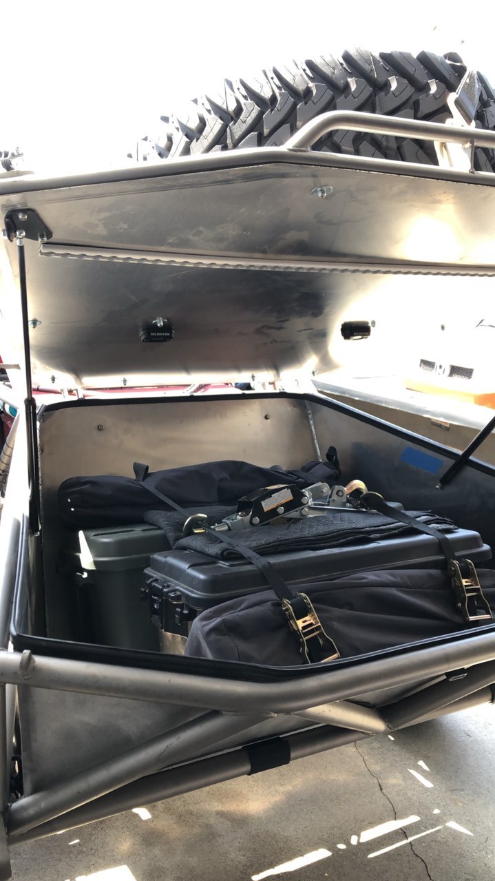

    Finally put trunk lights in now just have to get mounts made in the cab to mount the two interior ones. Supercharger coming soon.
