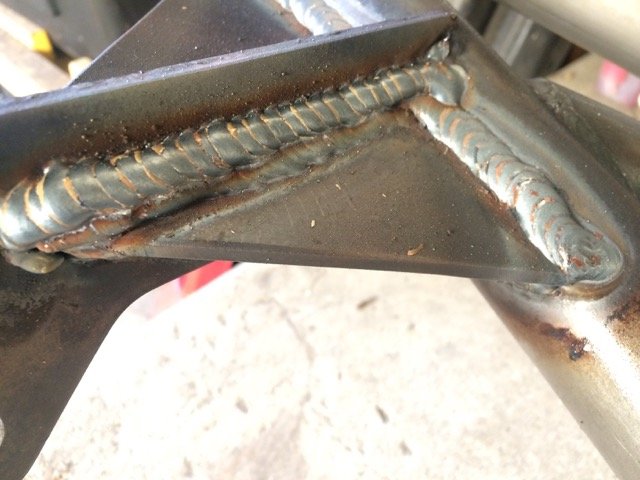

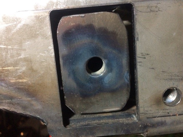

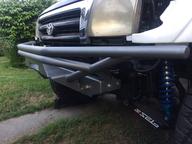

  17. May 16, 2019 at 11:36 AM
    Dalandser
    Dalandser ¡Me Gustan Las Tacos-mas!
    Feb 19, 2015
    #149090
    17,634
    Anthony
    Downey
    08 PreRunner Regular Cab / 98 4x4 Extra Cab
    Empty Wallet Mod
    Not too bad - the more you fab stuff up, eventually it gets faster. Here's some frame caps, gussets, and fill-in plates for my bumper - not too bad of a project that has most of the same processes needed to make the tower gussets. I bought a big scrap sheet of metal for $30. I save whatever I can and use it towards things I can't make on my truck. I've got a lot of time though.
