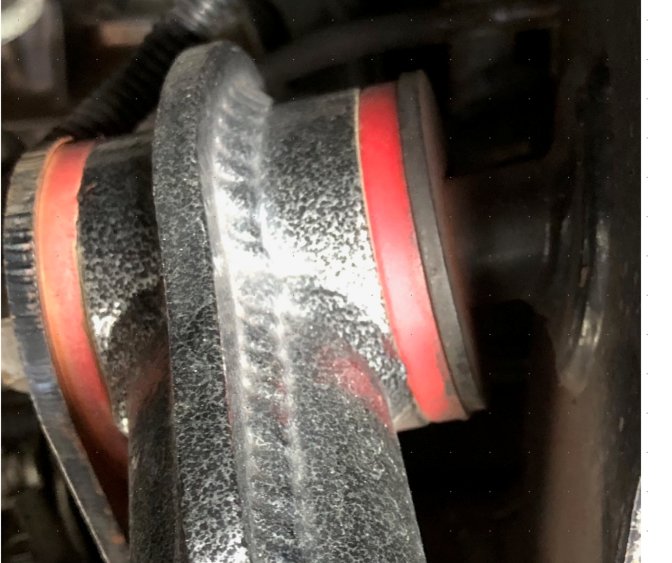

    Same for mine, had to stack some washers to close the gap between the heim and the mount
