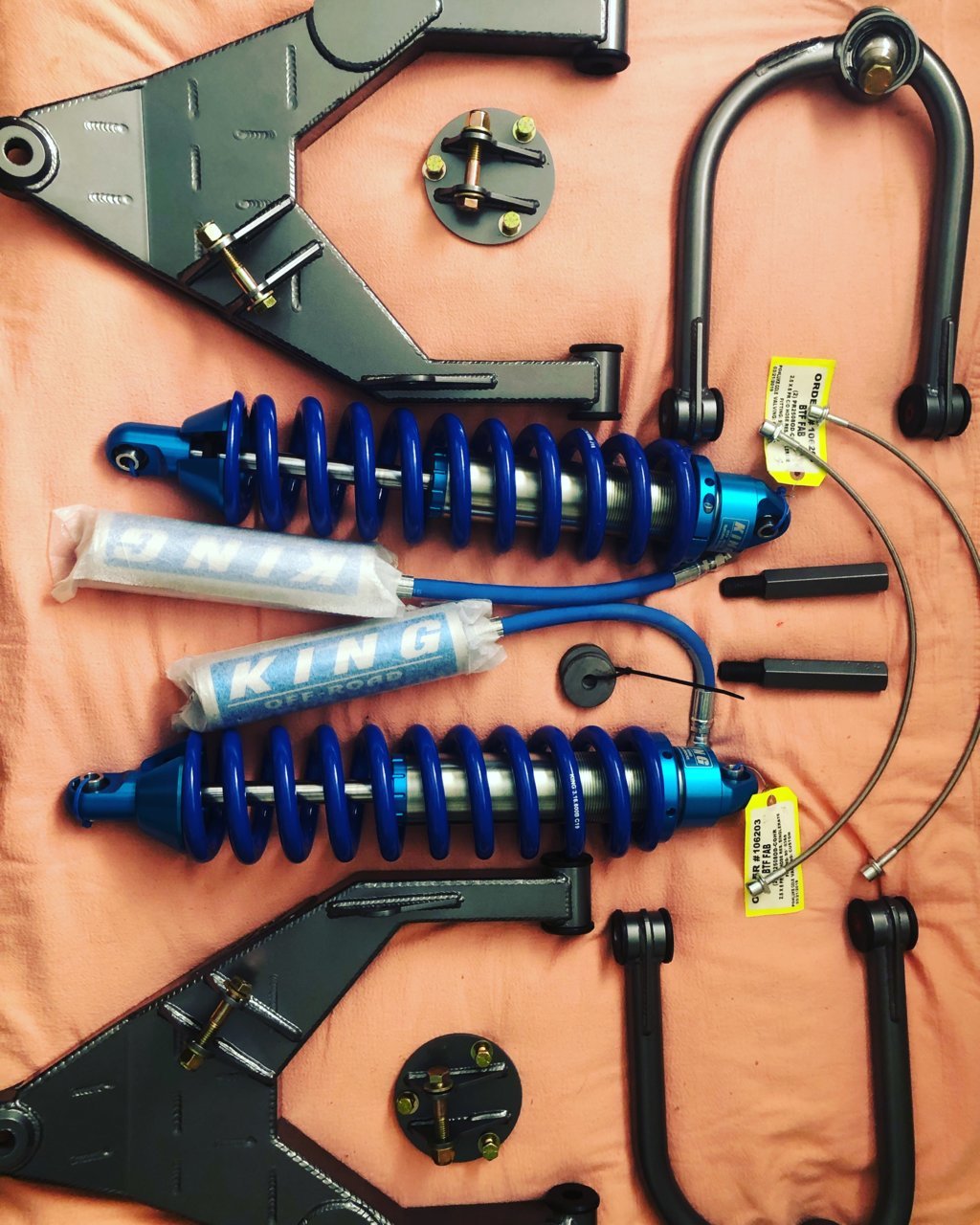

    Is that BTF for 2WD?? After spending over 5 hours putting my front shocks back in yesterday I'm looking for a better solution to the upper TC shock mount. With all the tweaking and welding over the years the bolt holes don't line up into the billet shock mount. The BTF upper shock mount looks simple but it looks like the bolt can only be under the plate thus making the shock shorter. For TC 4wd application the billet mount flips and the bolt needs to be above the plate. I'm looking for solutions because the next time the front shocks come off I'm putting it together different, not sure how, but it won't be the same.

    Yes, the kit I got is for 2WD but I know he makes 4WD applications aswell. You might be able to buy just the shock mounts so you can replace the TC ones. Hit him up. Super cool guy.

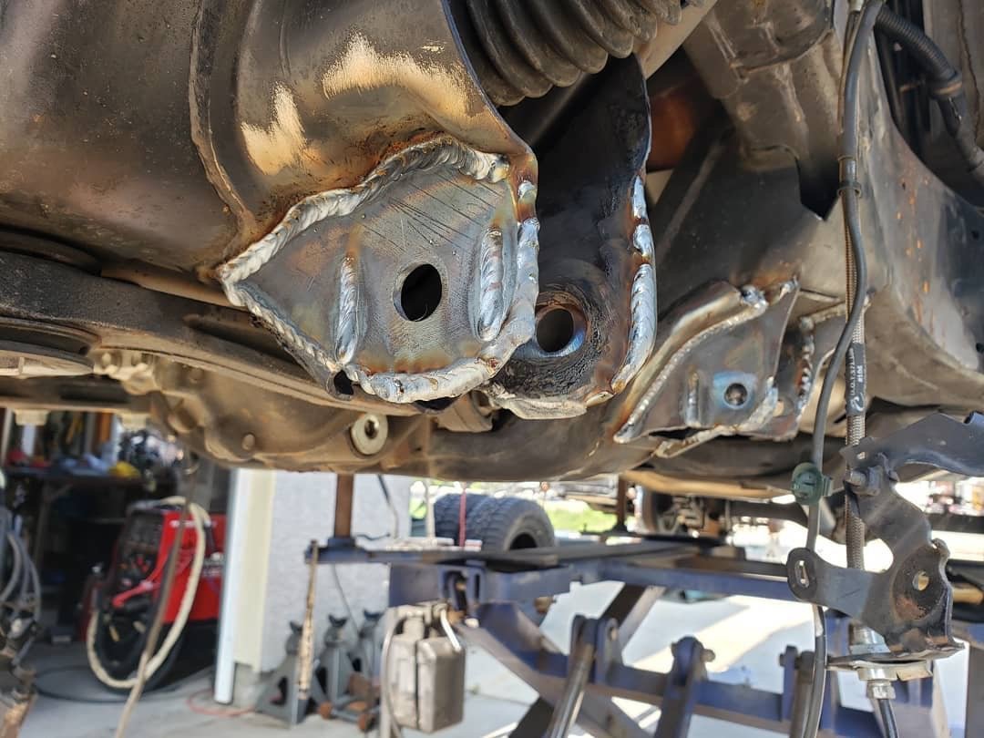

    I would still get gussets in some capacity. I know a guy who bashed up one of his LCA cam tabs to the point where until he got the gussets, he couldnt maintain an alignment. This helps prevent that from taking place on trail although nothing is ever guaranteed.

    smashed this, broke that, covered it up with tape and paint
    I’m debating on grabbing these to stack onto this

    If you're that deep I would just make the horizontal plates.

    For sure. That’s what I was thinking
    I had seen someone in here post something similar a couple years back and told myself I’d do that as a preventative upgrade when I did the Cam tab gussets but totally spaced on it when the time came
