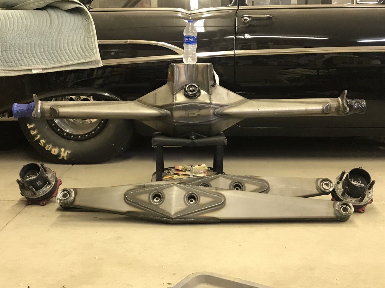

  14. Jun 3, 2019 at 9:54 PM
    foxrcing07
    foxrcing07 KO7FOX
    Aug 12, 2016
    #194389
    4,024
    Morgan
    Modesto, CA
    2019 Raptard 2001 TJ
    Dirt
    Well this part sucked
    Finished disassembling them, reassembly soonish
