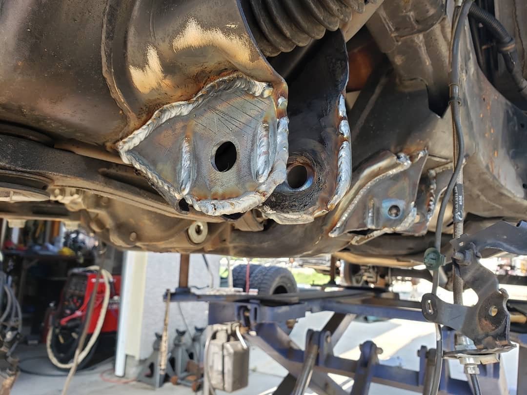

    I've cracked mine on my first 3.5 kit from stuffing a wash...broken 3 bumpers have since welded a bumper on and welded lots of metal around the LCA mounts...there's nothing wrong with gussetting crucial parts of your truck like suspension pivot points... and beefing the drivetrain up. Anyone who drives there truck hard repeatedly is going to break that stuff...the weight issue really isnt a factor when your sitting on the trail with a wheel snapped off or a broken frame. I even cracked the frame in the rear when I was on leafsprings to where it was gunna depart the vehicle in a couple.more outings. And talkin with shock tuning experts like ODR and stuff they all say a truck with a lil weight to it handles bumps better and is easier to tune. Tacomas are gutless for the most part reguardless what weight ur gunna stack onto em even if you have a supercharger lol. Rather have piece of mind than a broken rig IMO.
    And Dana 80? Now your just being dramatic... swapping to any 1 ton drivetrain is more than plenty for these trucks. 14 bolt Dana 60 Ford 9 all are plenty assurance u wont have rear end problems especially if they're full floaters.
    The marlin kit is kinda ugly but its user friendly...the Dirt Designs kit looks pretty good especially if you still run cams....
    Ultimate solution for the more serious folk...hiemed upper, solid mount the lower arms with bolts deleting the cams entirely and running a tube around the bolt head that gets boxed in to the frame...that version wont break till you wreck the crap out of your truck....which is perfect lol

    Look up any solid mounted lca’s. That’s basically how they do it.

    yea super easy I used 2"x.120 DOM tubing since all my pivots are 3/4 bolts(easier to fit a socket into. and just some 3/16 plate..i only did the front on the front mount and the rear on the rear mount. ill prolly box em in more down the road. but its pretty solid as is for now
