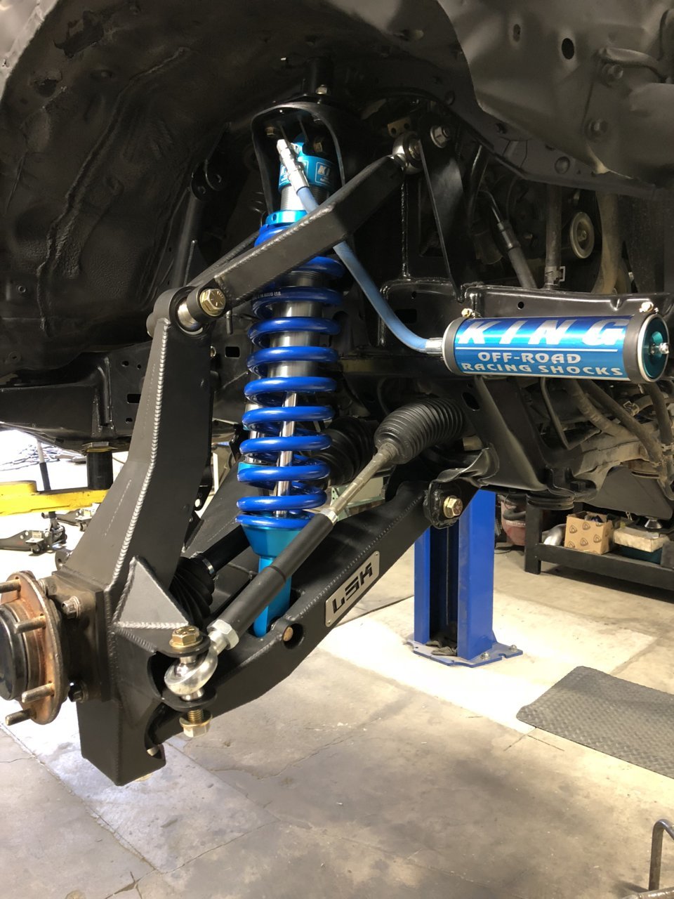

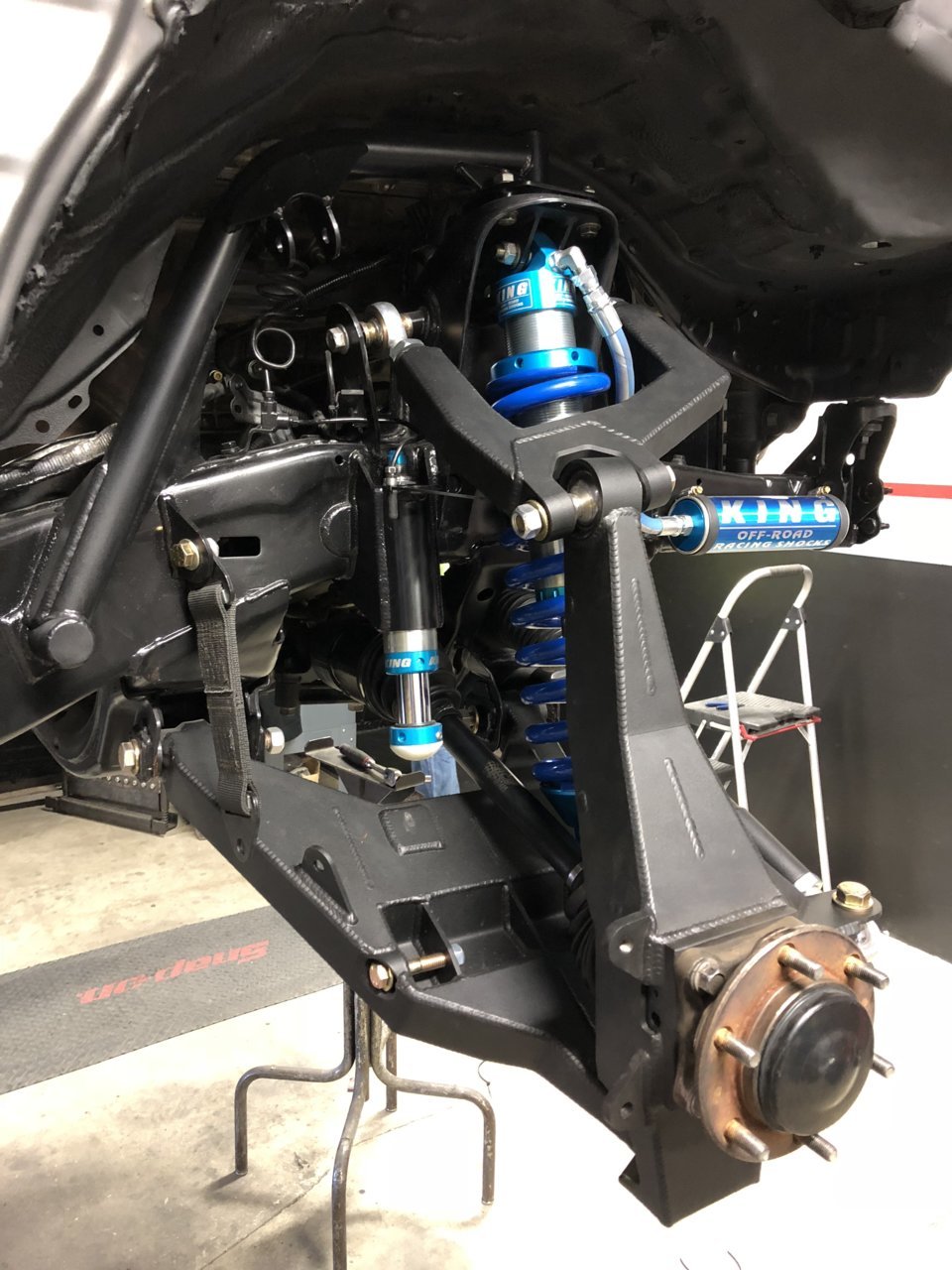

    Anyone running the LSK +4.5 kit ? Any feedback ? @Anthony250 ?

    That kit looks amazing. They just came out with a 4.5 for 4wd 2nd gens with a fully fabbed spindle if I’m not mistaken.
    Gunshot-6A, nate232 and whatstcp like this.
