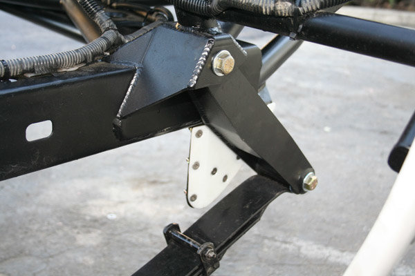

    I've been chasing this issue for years and cannot figure it out. It's gotten much worse that it's dangerous and scary to drive over 50mph when the road has lateral ruts in it including the freeway. I80 over Donner summit is a 45mph handful. I checked the ubolts and while they weren't super tight they were secure. It still did it after tightening. All the rear leaf spring bushings are new Energy poly bushings. Leaf springs only have 3 trips after re-arch. As I said, I've been chasing for years so it's not leaf springs as this is the 3rd set (went from Deaver and now 2 re-works on the current set). The only thing I can think of now is the shackles are moving side to side. Pictured is how it was built. There is, pending how the truck is sitting, up to a 1/4 inch gap between the shackle and the guide plate. But the truck doesn't move side to side when you shake it any more than 4 other LT trucks I shook this weekend. I'm going to try and double the glide plate material so there is no gap all the time and see if this works. I am open to any other suggestions. Front end is all new from the hub to the steering wheel. Again, this issue has been going on for a long, long, long time so it's nothing "new".

    Whats under the gusseted shackle mount on the frame?
    Is that where you've notice 1/4" of play?
