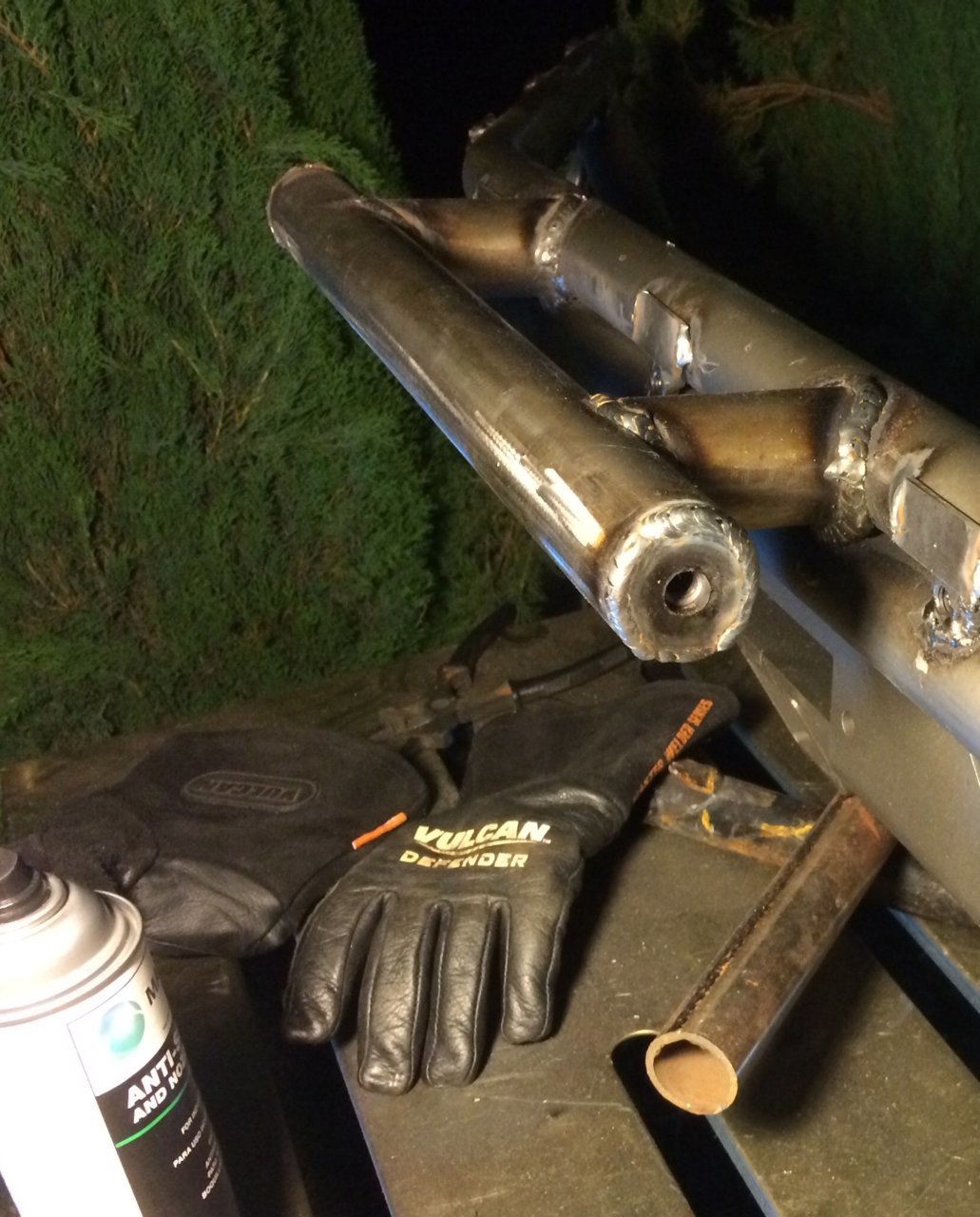

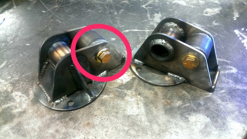

    Anyone know where I can source 1/4-3/16" thick washers with a 1/2" ID and at least a 1.5" OD? Looking to make the "barrel" part of this with the bolt through it:

    Image isn't working. However, what about just getting some 1/4 or 3/16" plate and cutting what you need with a 1.5" hole saw and opening up the center hole to 1/2".

    Because I'd have to buy a 1.5" hole saw and getting 1/2" holes dead center w/ my crappy drill isn't always as successful as I'd like it to be. I can do it - I did these with a grinder and my HF drill press, but to get the fit I want I'd like to tack everything all square - I can totally do it with my hand tools, but I wouldn't mind paying a few bucks to save the time and have nice clean parts.

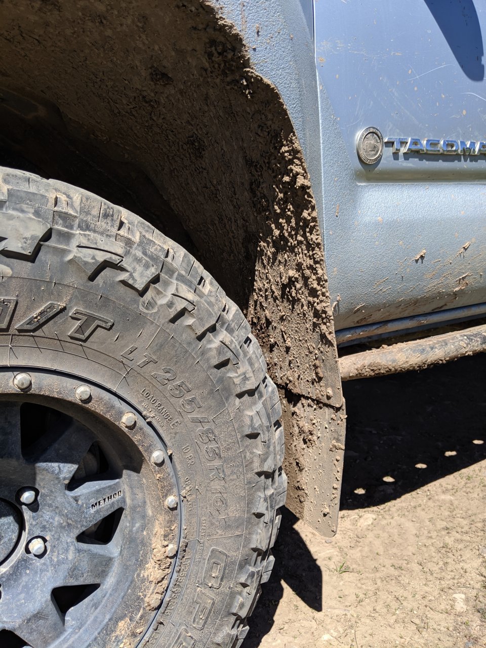

    My new mud flap configuration works perfectly. My old mud flaps needed updating. I used some remaining ABS sheet that I had when I made my fender liners and made a hard section that contours the fender and then I got some 1/8" EPDM rubber sheet from a local gasket supplier.
    Without my mud flaps, my truck gets plastered with Mud as shown in this first pic.
