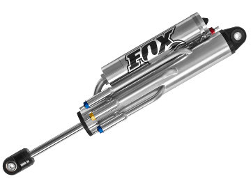

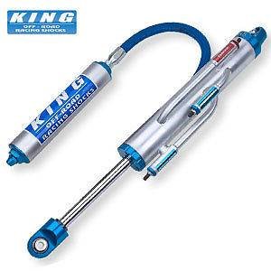

    Notice on the king shock how the compression tube adjusters are so far apart from each other? Basically when the long tube ends/ stops coming into play, the short tube begins.
    Now look at this fox shock. Notice all adjusting ends of the bypasses are lined up. This means all bypass tubes will be open/ functioning for the majority of the time and will close/ not be in play sequentially as the piston moves further up the shock body.
    Sorry if it is not the best description, but hopefully the pictures help. But basically overlapping = more fluid capable of being being bypassed throughout the stroke. Non-overlapping = one bypass tube at a time.

    Yep that ^^

    That fox is an overlapping setup where that king isnt...
