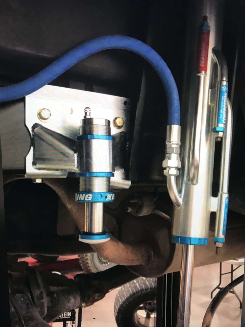

    My understanding is that with a long bed you can pull a clean 16+" out of your DMZ kit with proper shock length / mounting. A 14" shock mounted under the bed would be a limiting factor, likely limiting bump travel because the shock is lower. In my opinion if you are already committed to all of the fab work of a DMZ kit it would be best to maximize the performance and capability of the setup with a 16" shock and low profile bed cage that retains most of the usable bed space.

    14” is max you can go without getting into the mess of putting holes in the bed and taking it intirely new direction which it didn’t sound like he wanted to loose bed space. Like he said at that point might as well go link the bitch lol. You have to draw a line somewhere. 14” is already maxed out TC sells 10” kit for their LT so going 14 is already a huge step up.

    I don’t understand for the life of me, why no one orders the correct tube layout for these kits. You’re giving away atleast an inch of shock clearance by running this layout, and it doesn’t cost anymore to get the style 2 layout

    You’re correct sir. king messed up the order and was shipping a new shock body with a different tube layout this was taken prior to the new body arrival and rebuilding of a shock.
