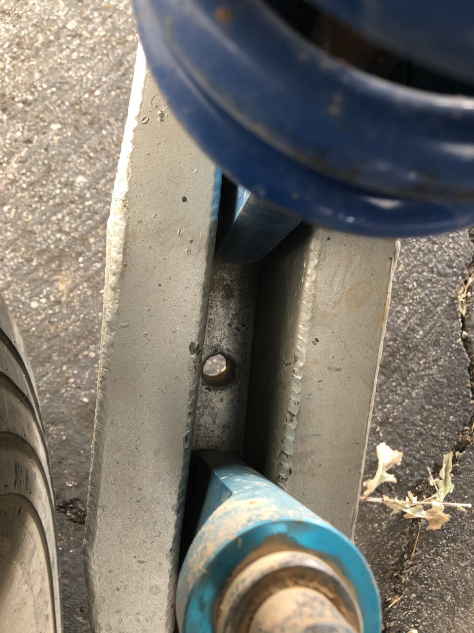

    *drain holes not installed

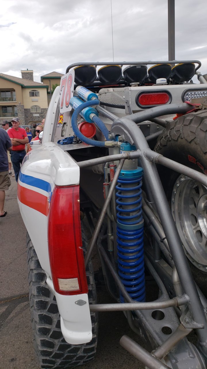

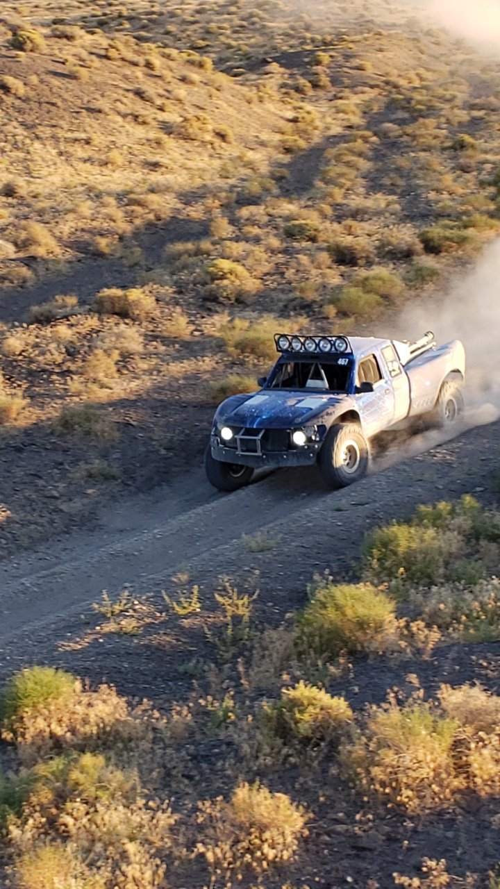

    Fallon 250 put on by Vorra was a blast last weekend. You could of meet and talked to a few guys who have built linked trucks. I had a blast met some awsome people. Talked with crews that do shit I only wish I had the money and time to do.
    If your out here on the west coast, I recommend checking out Vorra. Next yr is going to be awsome.
