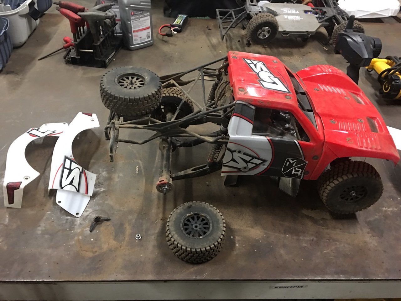

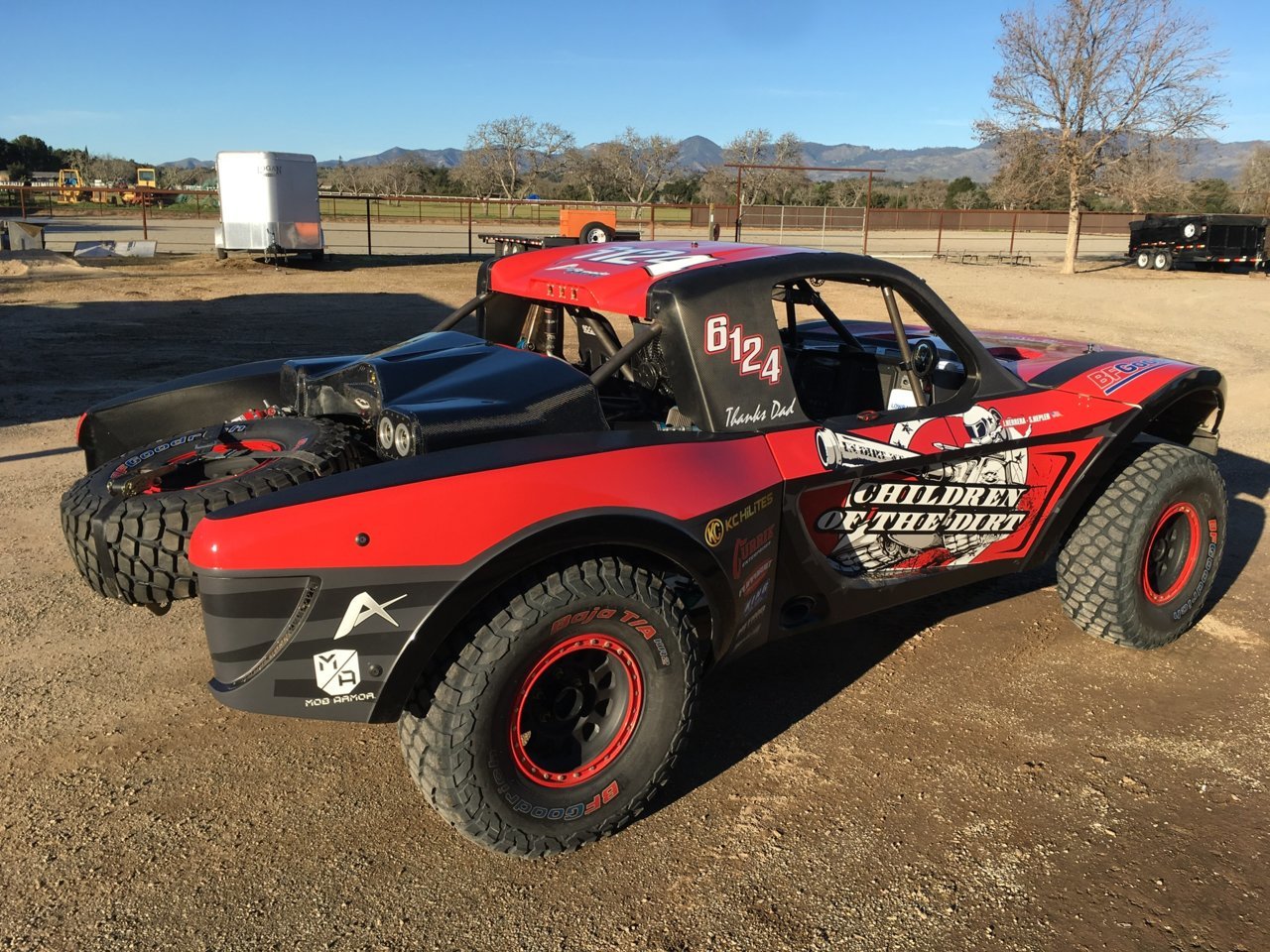

    Like this?
    Truck rides like a Cadillac going 65mph anywhere in Barstow OHV.
    Or Like this?

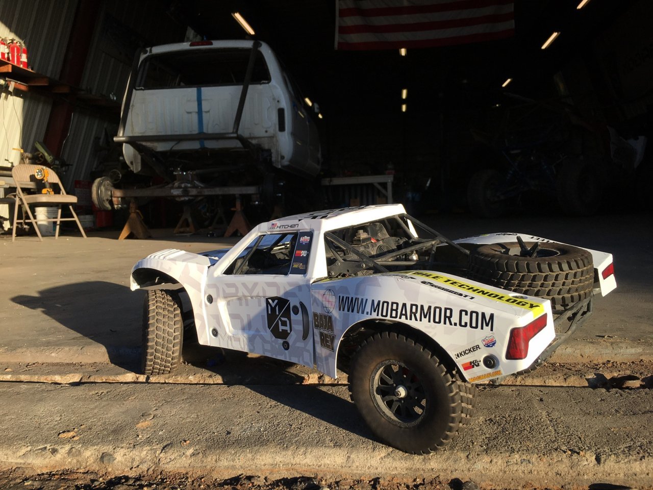

    6124 Spec TT is for sale BTW, I was setting up a tablet gps package before V2R. This trucks not my favorite because I’m too tall for it. Other than that both are incredible machines.

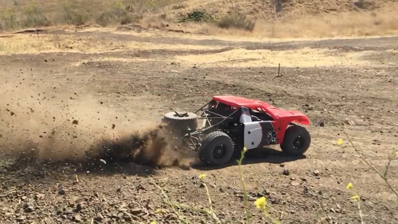

    And my favorite linked truck to date
    The good ol losi Baja rey

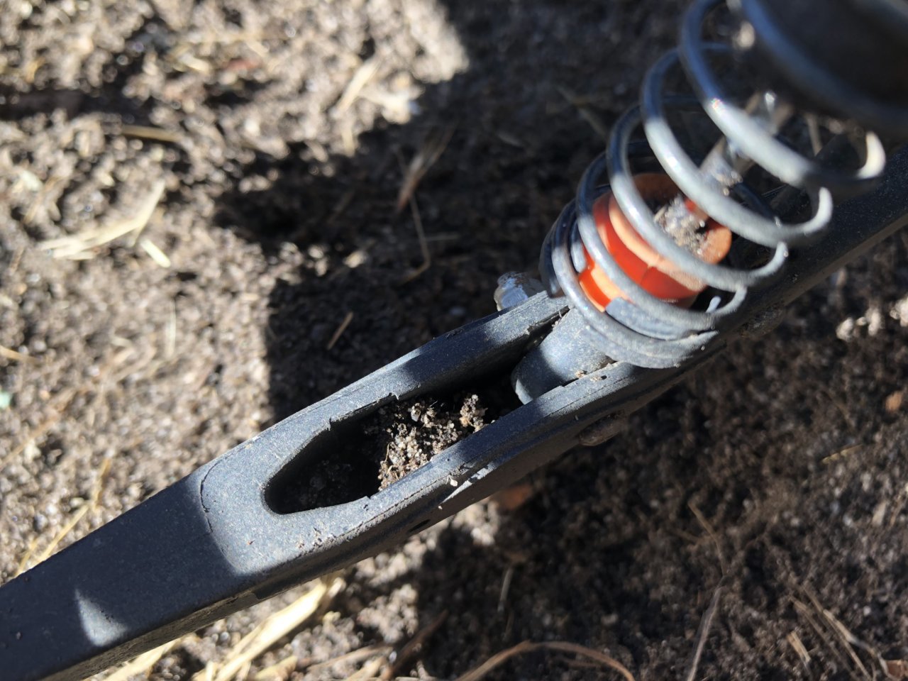

    :deadhorse:

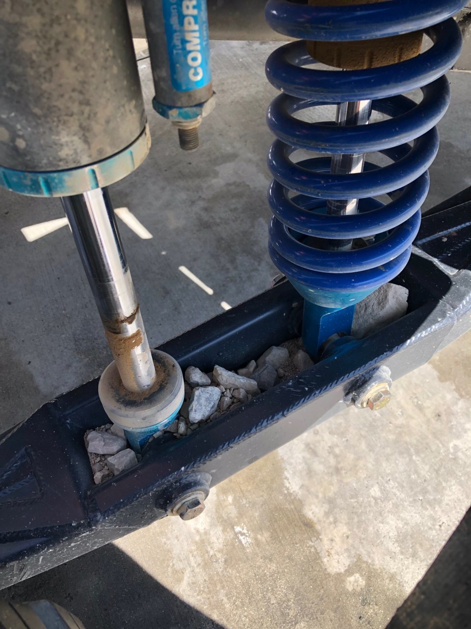

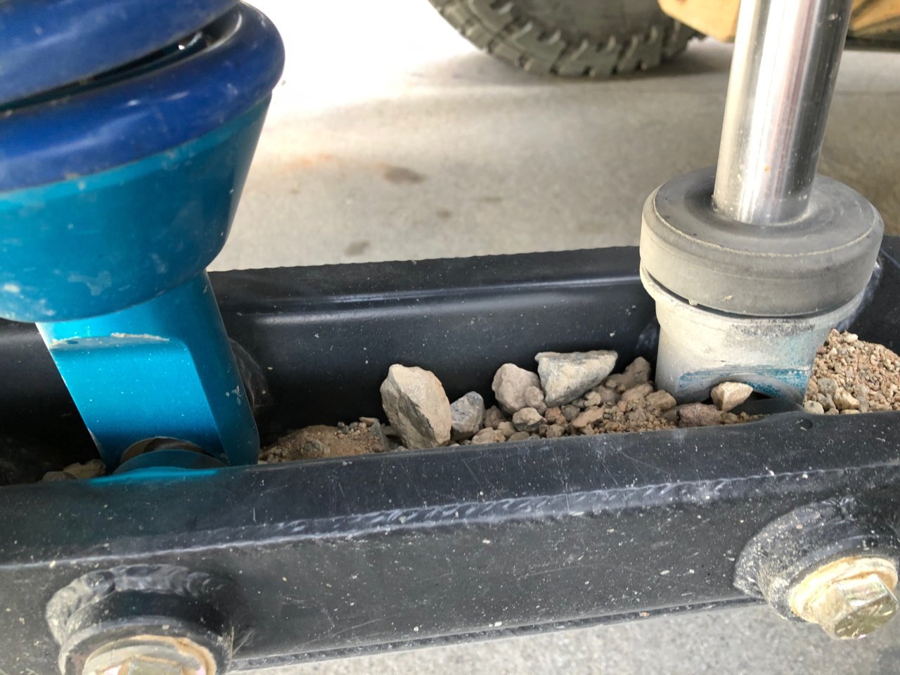

    I know we keep going around and beating this dead horse about drain holes in links... but I have that problem too in my other truck :anonymous:

    You should look at how some of the rock bouncers do their trailing arms to combat this. SE mud and rock tends to collect like that really bad eating up the lower shock mounts. Tim Cameron with his fully machined aluminum ones are the cream of the crop, completely open where the shocks are.
