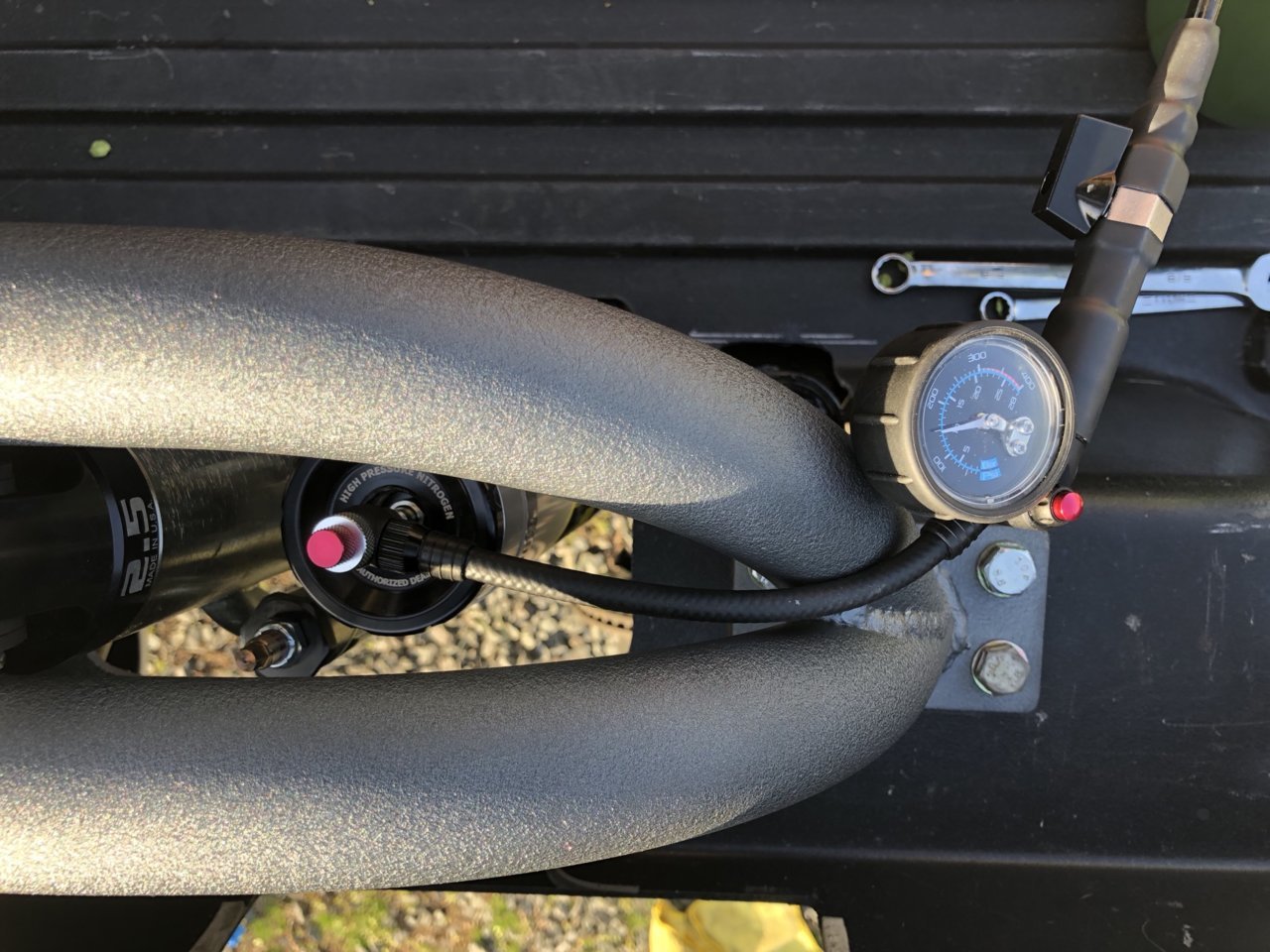

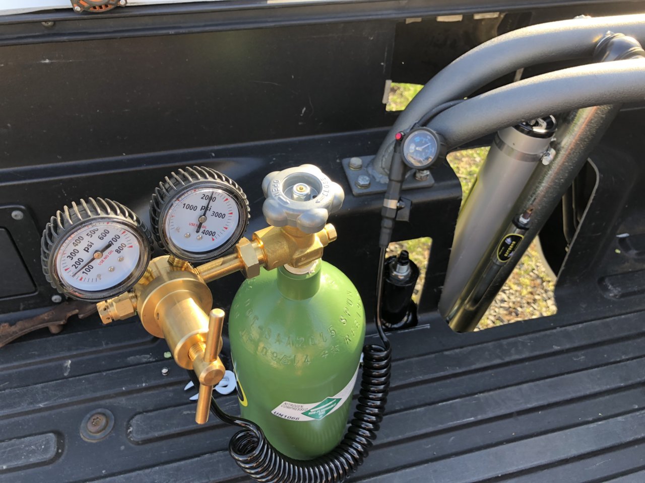

    C25 filled shocks? Nice. Lmao

    No...like I said Argon....from dat der tig welder o mine....c25 is for the squirtgun
    And shock oil.....ATF works pretty good and is ALOT cheaper

    Yep, so to make it seem like I am contradicting myself, in the case of Argon, nitrogen, helium, and mixes within those, they all utilize a CGA580 because they are all classified as an inert non-flammable gasses.
    ... I actually use argon for everything on my shop, including filling tires... but I work for a compressed gas company so #freegas :p

    Isnt argon more expensive than nitrogen? Other than that they have similar properties basically the same.

    Its alot cheaper if you have a huge bottle of it already for your welder...and already have a nitrogen regulator...why buy a bottle? For me it's a waste

    Yea that's probably the better way to go if you already have a huge bottle for welding if I welded a lot id honesty do the same.

    About twice the cost. But to justify another tank you'll have to fill a few thousand shocks...
