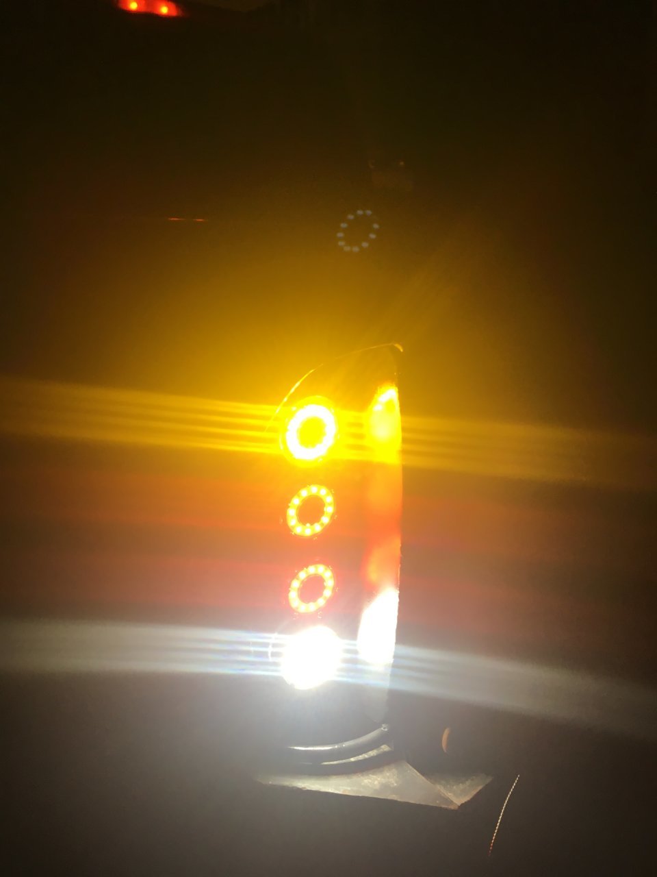

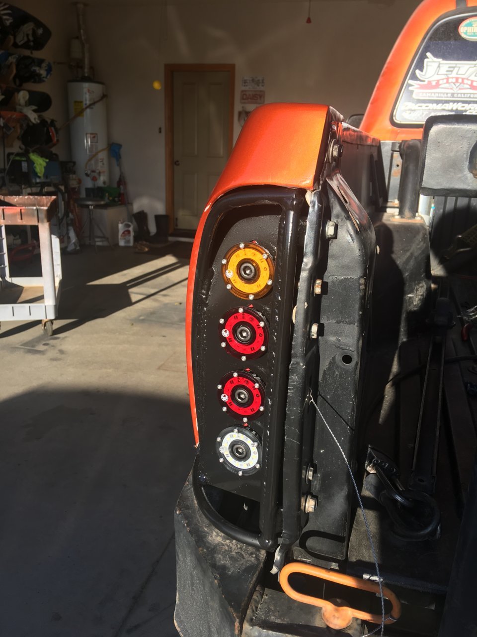

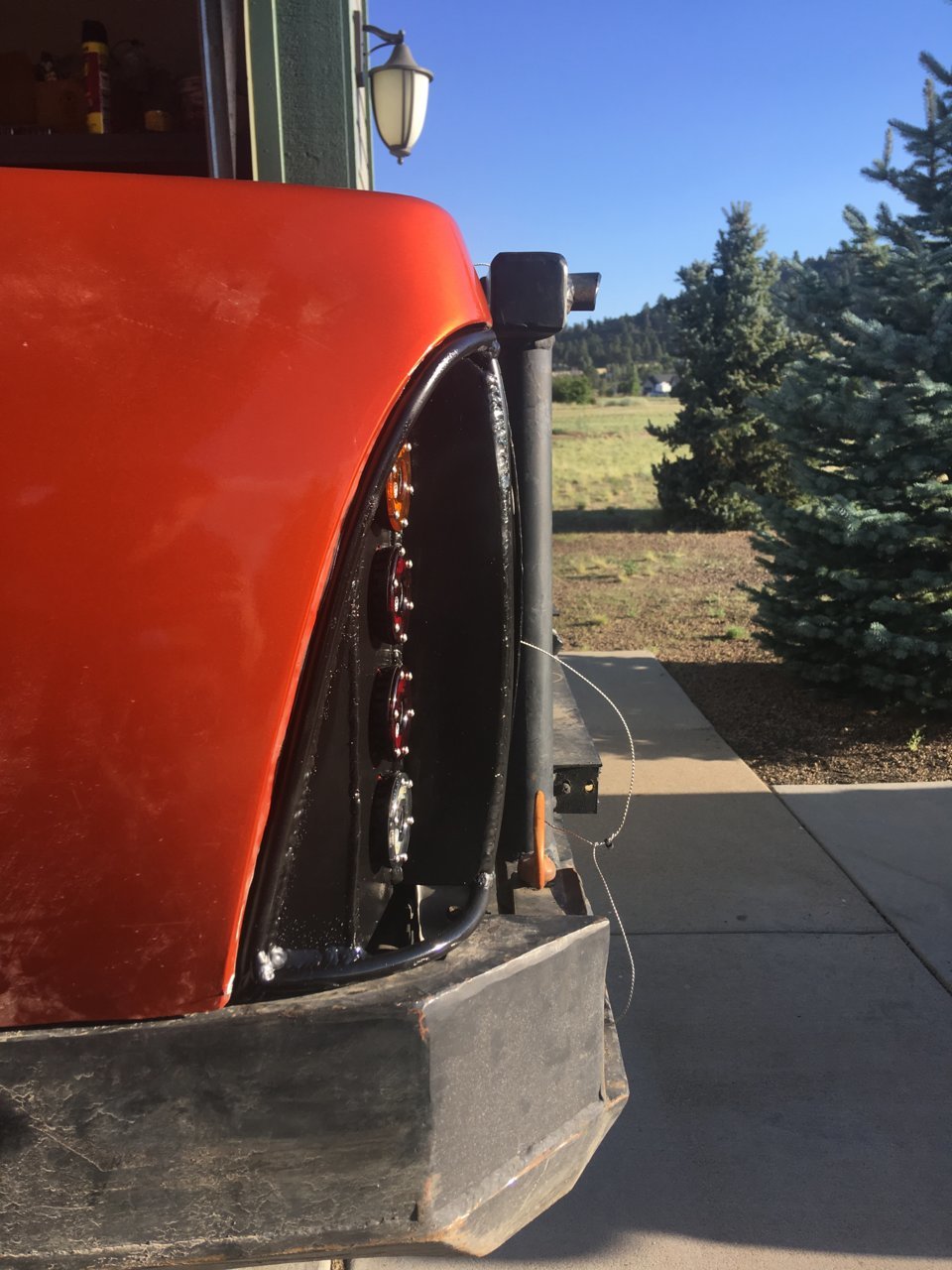

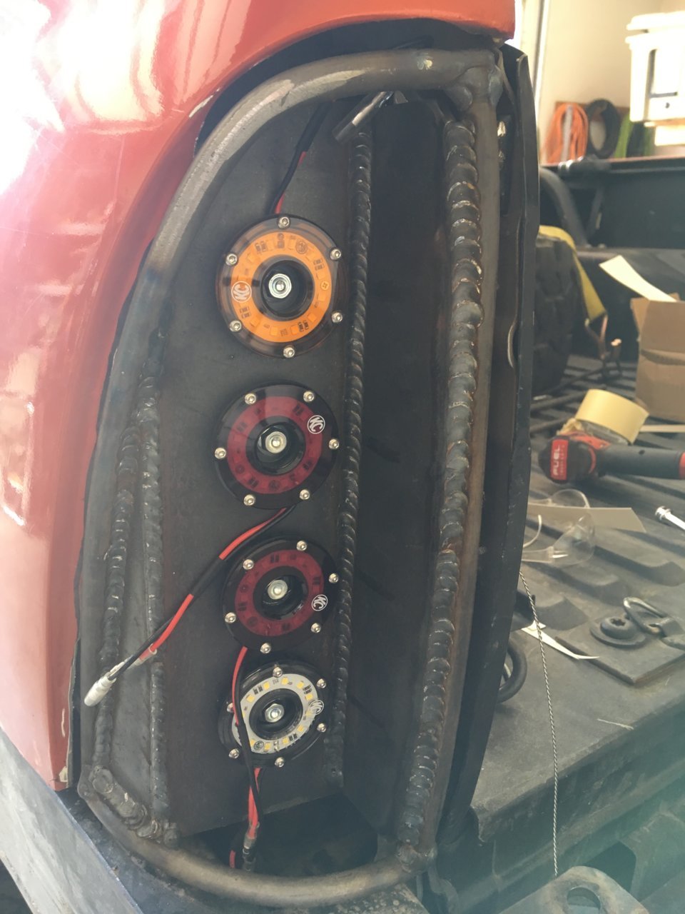

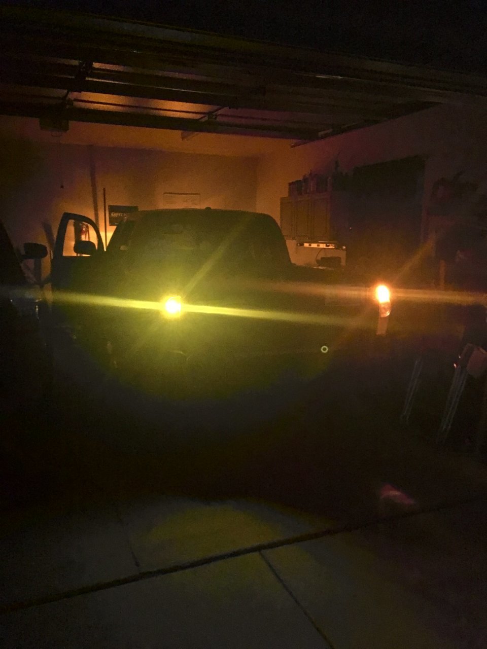

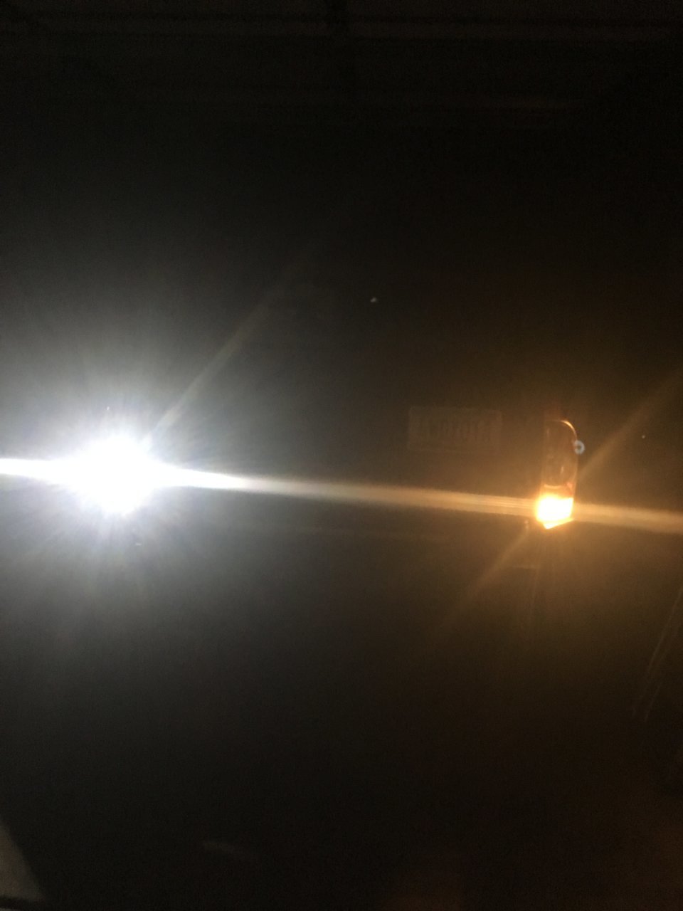

    sweet.
    You gonna leave it like that or add some sort of plexiglass or some sort of cover?
    I think it might be smart to add a resistor to the running light so you're not blinding people just driving around with your marker lights on :laugh: you can do that with the actual brake light one haha

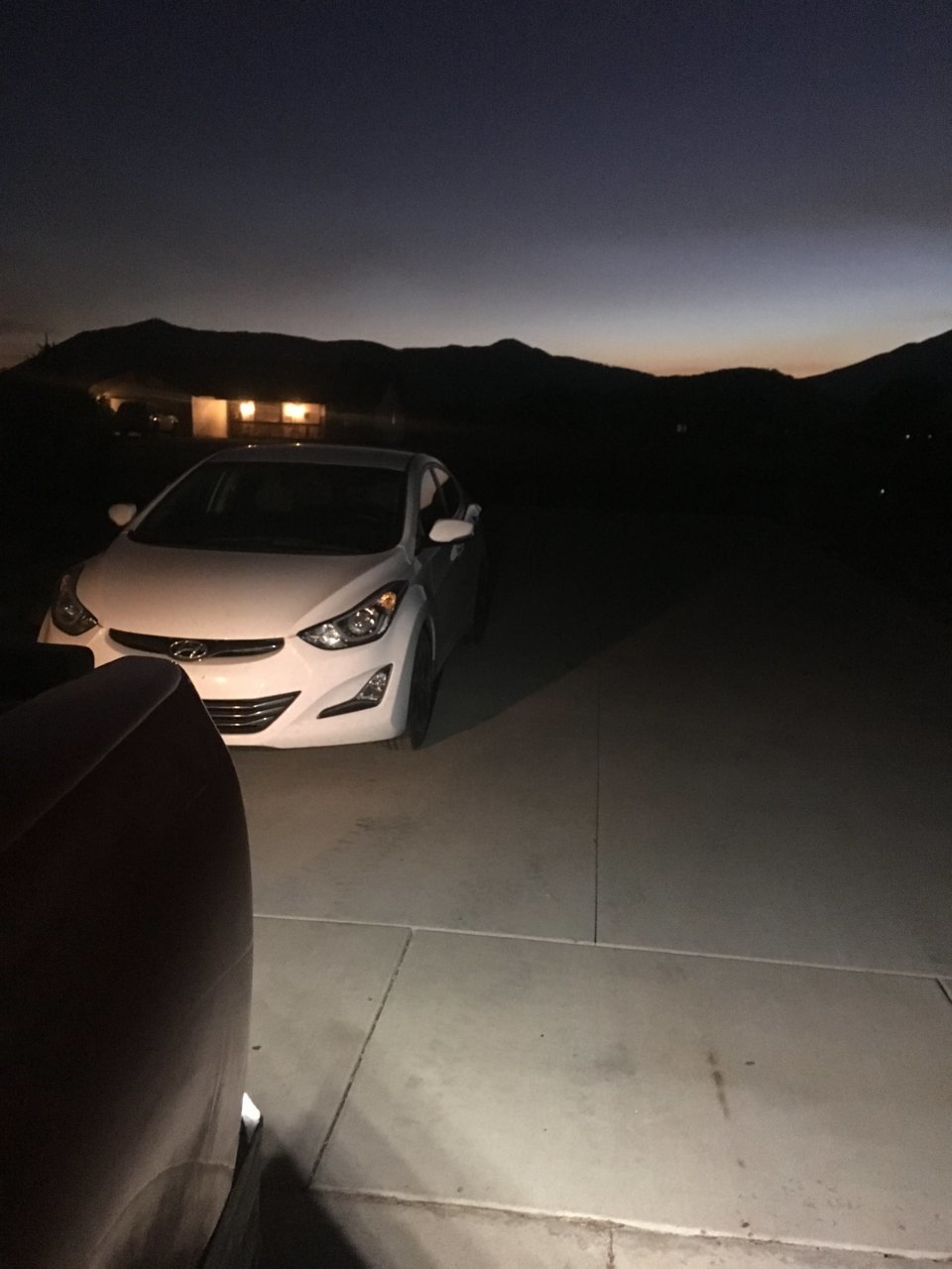

    We’re looking into possibly refitting the lens off the oem light since they should be close. But if it doesn’t work then oh well. As for the resistor, these are very bright, but they don’t throw very far so no one should be getting blinded by them.

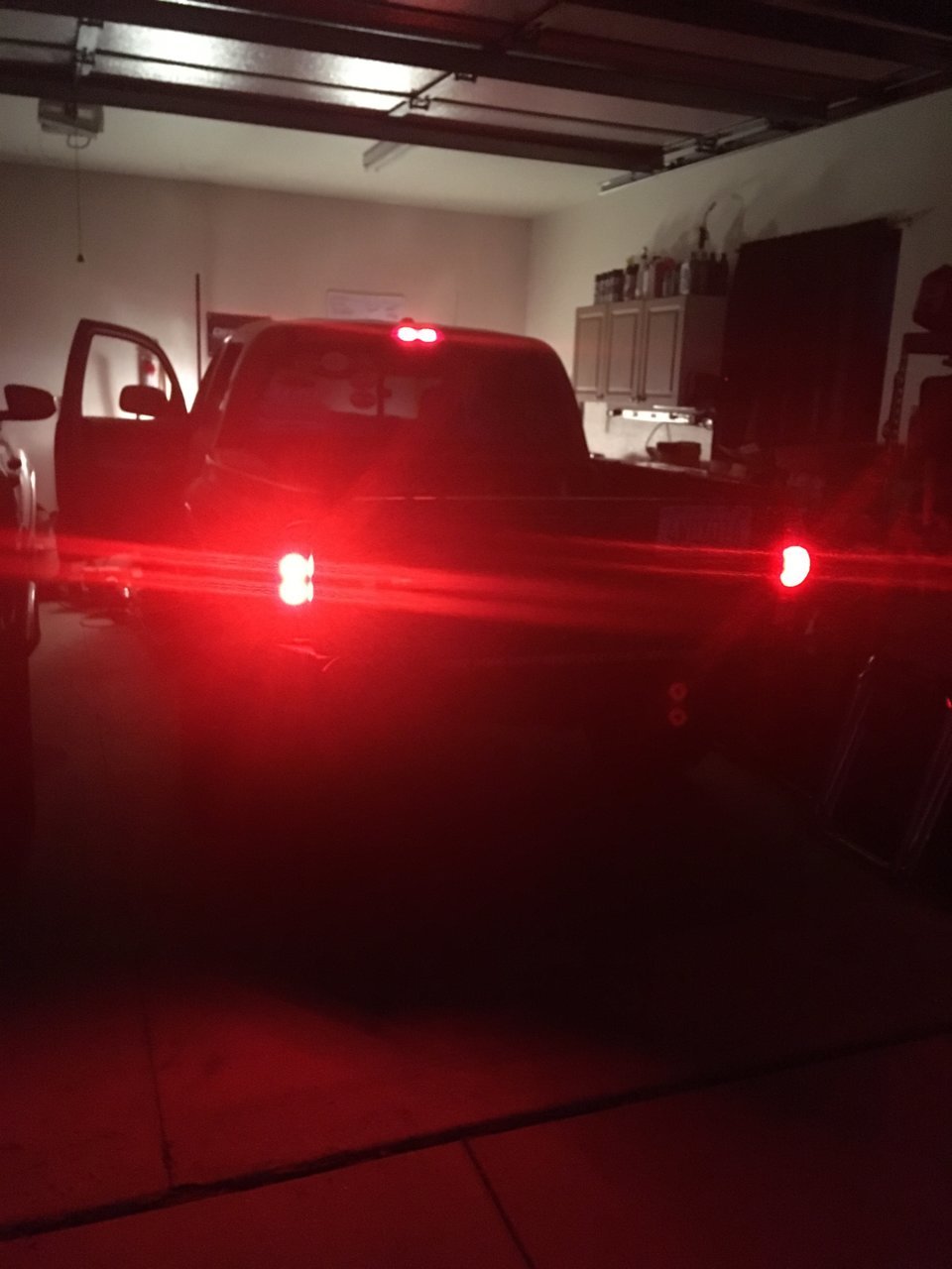

    Are you using one red as the taillight and one as brake?

    Yep

    Lights look good dude! U might want to lay some DOT reflective red and grey tape underneath since u dont have a reflective housing anymore and it's hard to see the light from the side...that's what I did...to be more cop friendly

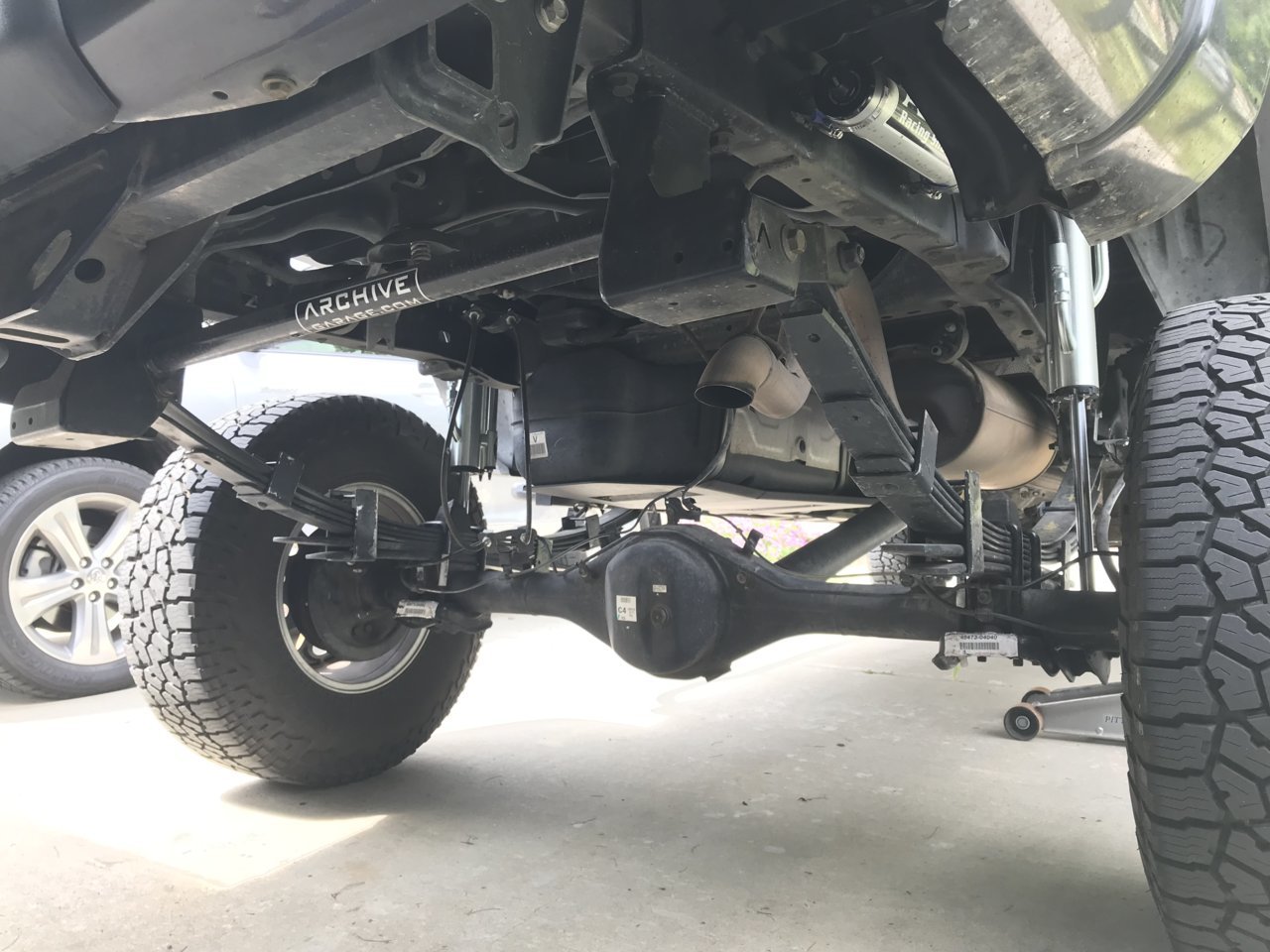

    Yeah, Eric at Archive originally designed the hangers and extended shackles for use with SUA, and he even makes a spring perch for the conversion. So it's just a matter of making it all work together. I'll probably message him too since he's a dealer for Deaver. The only issue I see is that most SUA kits angle the hanger more rear-ward than the Archive kit does so I'm not sure if that could pose problems.
    The hanger setup with shackle config was about $600 w/ cross tube that bolts from hanger-to-hanger. The 14" shock relocation towers were another $400. I have yet to buy the spring under conversion kit, and 2.0x2" hydro bumps are on order from Locked Offroad in Temecula (they offer 10% off for TW members). It's going to be a fun setup to tune.

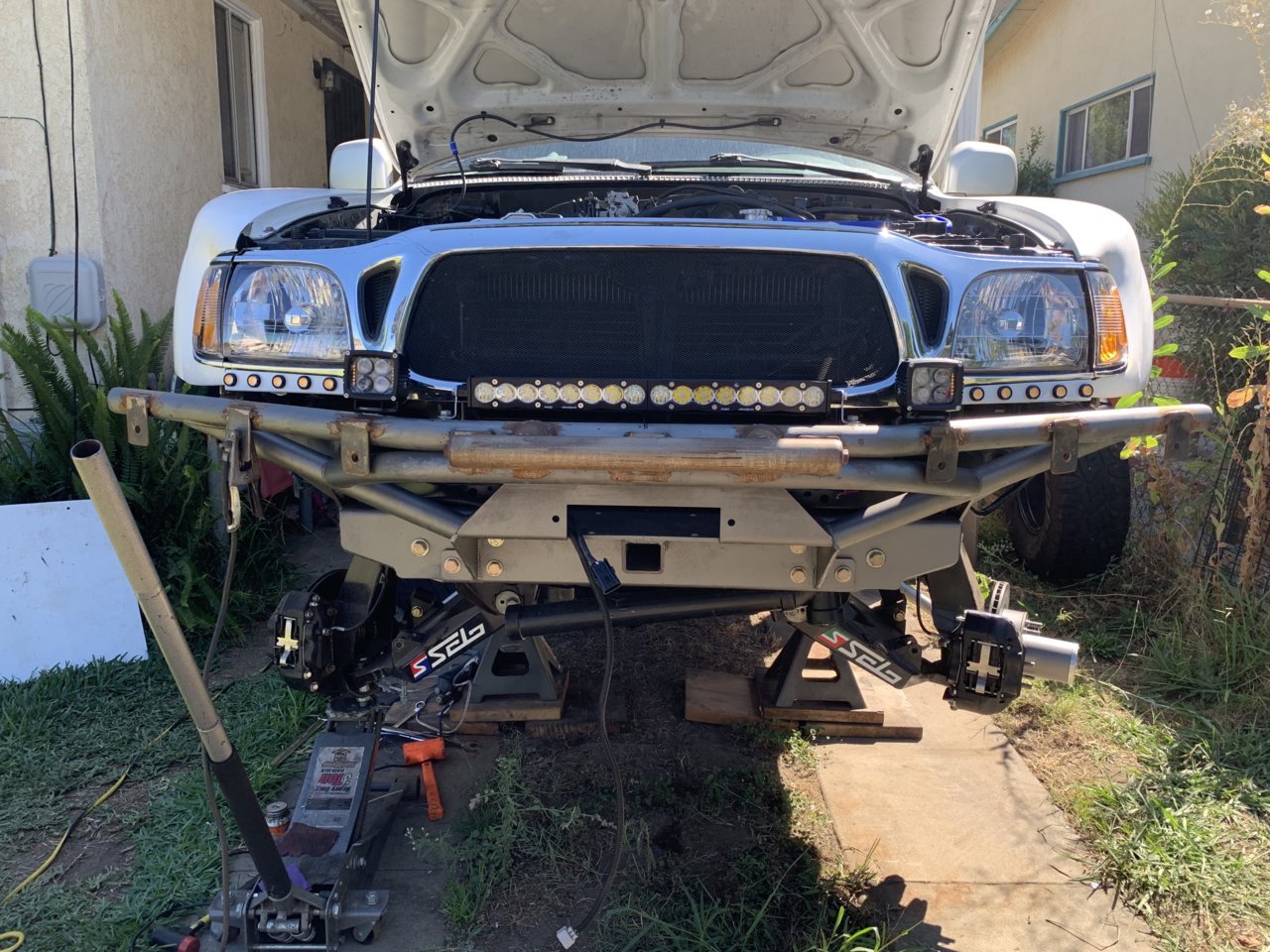

    Edit: Here is is jacked up with some cheap OME dakars and excluding a plate bumper I added: 5114E1E2-3F72-47D7-9F08-B83525E7F4DC.jpg

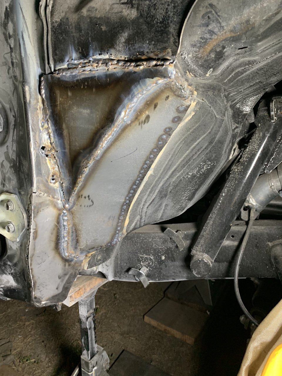

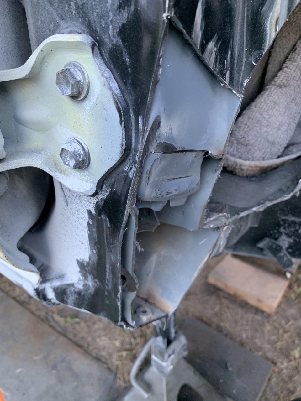

    Couple light fabrication things that may not be purdy but they’re sturdy! Been double and triple welding stuff sometimes for more connection and other times just to get better or experiment on unusual types of metal.
    Passenger side fits 35’s now.

    What thickness metal did you use for the firewall?

    I think we could separate my old lights and see if it’s worth using the reflective items from them? If not then the reflective tape could be an option.

    16 gauge but I used a little 1/8” for the body mount reinforcement.
