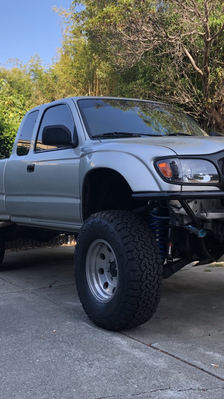

    AA4773A9-4285-4CF5-A4F9-E8BC9B70655E.jpg Speaking of fiberglass fenders...anyone happen to know what size these are or how to measure the size? Thanks

    looks like 4.5" Glassworks. and they measure from center line of the fender i believe
