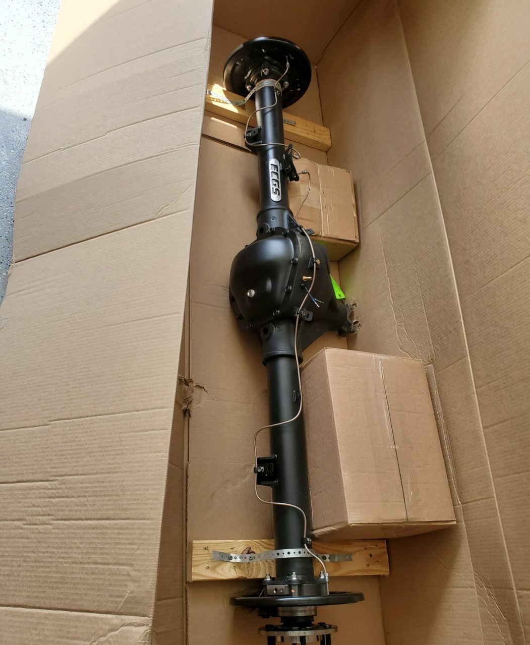

    why this axle? not saying its bad or anything lol. but what was the reasoning of that one?
    it looks like the 8.2 but hard to tell.
    why not got with a 9" or if wanting stupid duty a 14bolt?

    Its this one. 14 bolts are heavyyyyyy!!!!!!!!!!! Dana 60 is a bigger than 9" yet smaller than the 14 bolt and ECGS makes them so they are a true bolt in unlike the dynatrac.
    https://eastcoastgearsupply.com/i-23837729-2005-2015-toyota-tacoma-dana-60-bolt-in-rear-axle.html

    ahh, so you did get the 60? dont think you will be breaking that one lol.
    14bolts arnt bad once you ditch the drums and shave it. you get the ground clearance of a 9" and a FF setup :D I put one in my fj and love it. that 3rd bearing for the pinion is slick\
    a 9" can be made as strong as a 60 but will cost $$

    Yeah he got a 60, ECGS started doing complete bolt ins eariler this year, they make them for the 4runners too now. What's nice is they got all the bracketry etc that is stock so just swap your brakes over and bam in it goes.
    I'd love to stick a diamond axle 9" under my truck. 9" aren't that pricey since that is what circle track racing and drag racing uses there are a million companies out there making stuff for them plus the gear ratio assortment for them and widths etc is unreal. I've dreamed of putting a 9" IFS housing under the front too that would be pretty damn slick.
    On my old circle track car it was a FF 9 :D

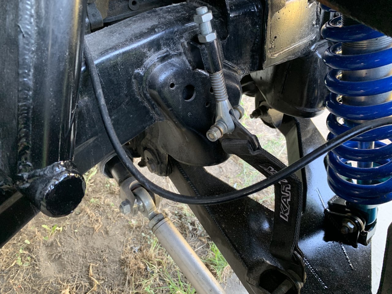

    I'm looking at setting up some limit straps in the front. Does anyone have a clevis mount they like? Something to attach the mounting clevis to the frame.

    Trail gear makes some. I got these at Kartek but it was just cuz I was there. Might save if you price shop. Poly performance sells them too I believe. I like them for working on the truck so I can shorten the droop length and not have to get sketchy with my jack / jack stands. They’re set to keep the shocks from limiting droop at the longest setting so I can shorten them when they stretch. Don’t mind the jam nuts right now.

    ty sir, will check out Trail Gear's
