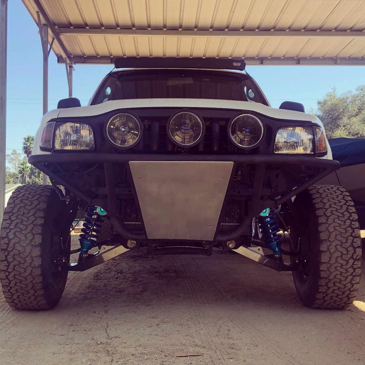

    What’s your ride height? Seems to sit a little high in the front.

    Didn’t measure. It is high though. I went a little high to compensate for my previous stink bug. I’m going to back it off and get it where I want. The ride quality was a little stiff with the preload
