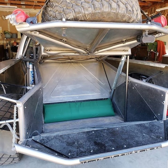

    Um...aren't wedge pillows made for a somewhat specific purpose?
    Oh man, the Buzz and Woody toys on the back are hilarious!
