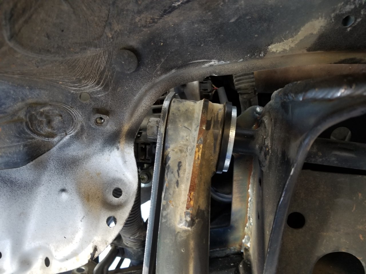

    552Jrider
    552Jrider Well-Known Member
    Jul 25, 2011
    #60537
    1,126
    Jeremy
    Norcal
    2002 DC 4x4
    So I picked up a used older style camburg 2wd kit for my 02 and was planning on just moving the shock mounts since my truck is 4wd. I went to mock up the kit today and found out the camburg ucas are wider than my TC stock length ucas. So my options here would be to cut out the uca double shear brackets and get a new set and weld them in for the camburg ucas, cut the bushings off and go heims, or machine down the uca to the size of the TC uca to allow room for the bushings.
    Thoughts on which option would be best?
  20. Sep 21, 2019 at 2:41 PM
    Dalandser
    Dalandser ¡Me Gustan Las Tacos-mas!
    Feb 19, 2015
    #149090
    17,674
    Anthony
    Downey
    08 PreRunner Regular Cab / 98 4x4 Extra Cab
    Empty Wallet Mod
    Just cut and re-weld the double shears
