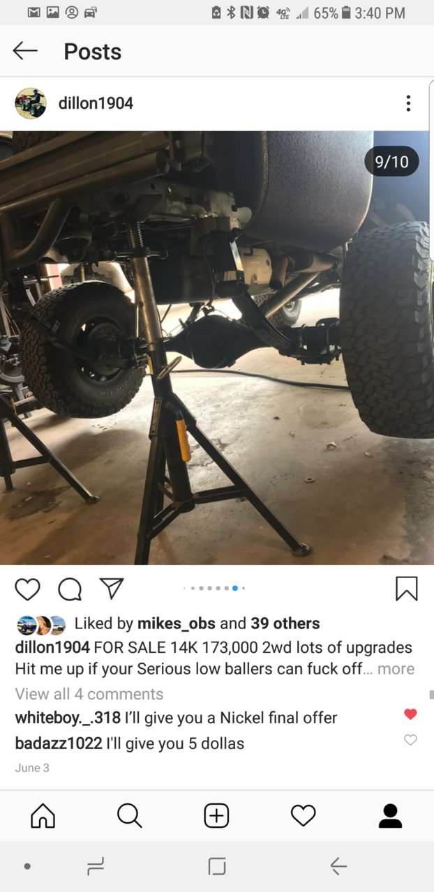

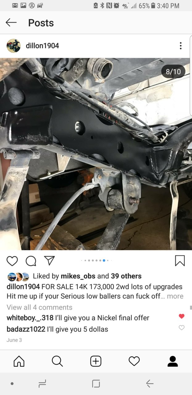

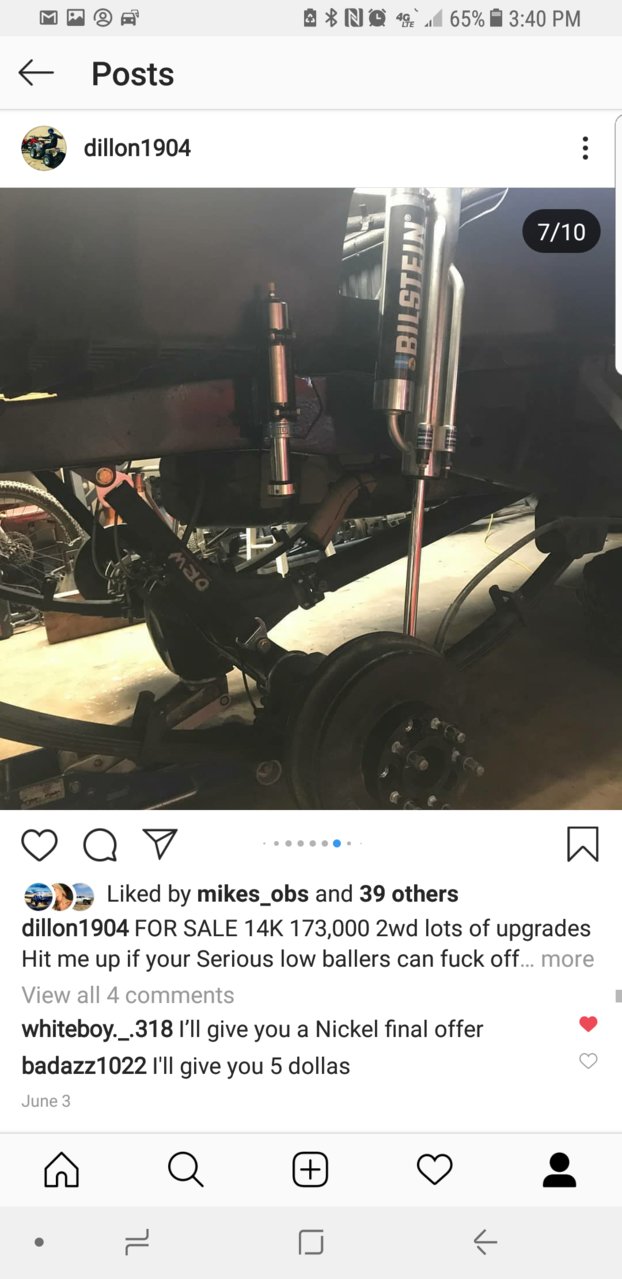

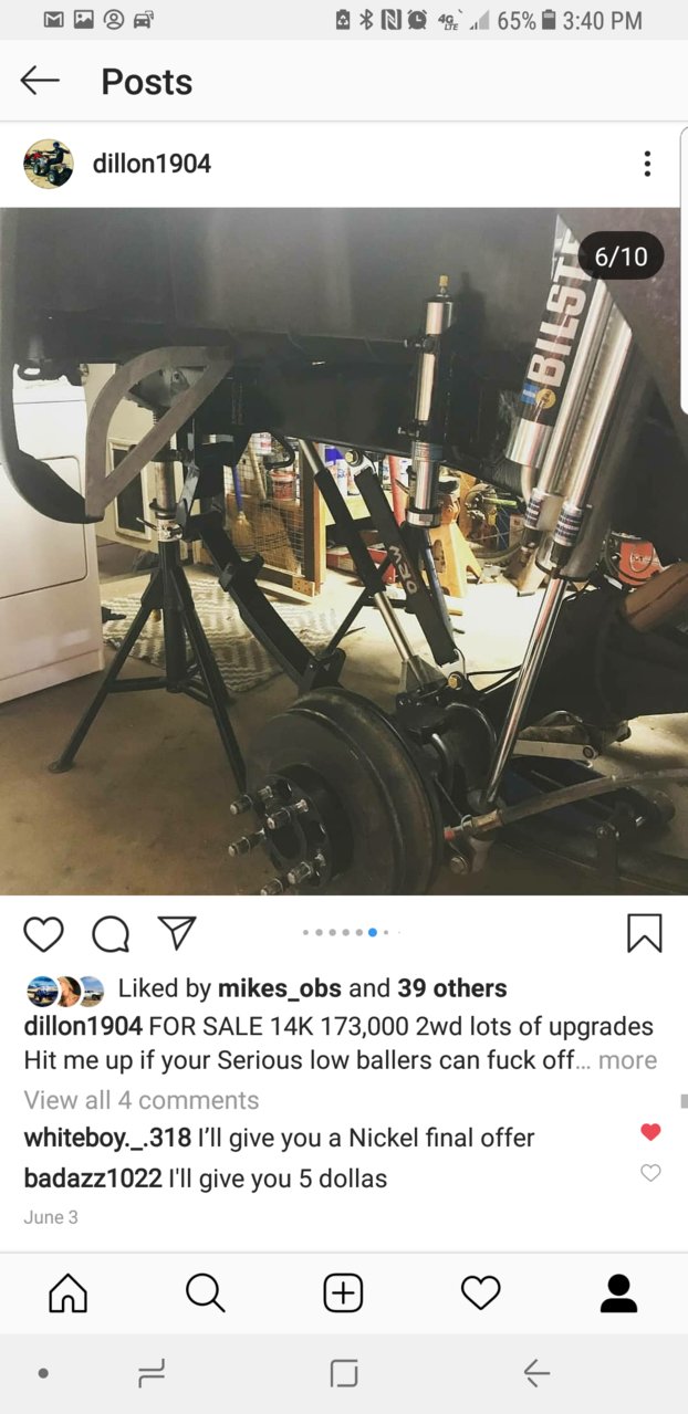

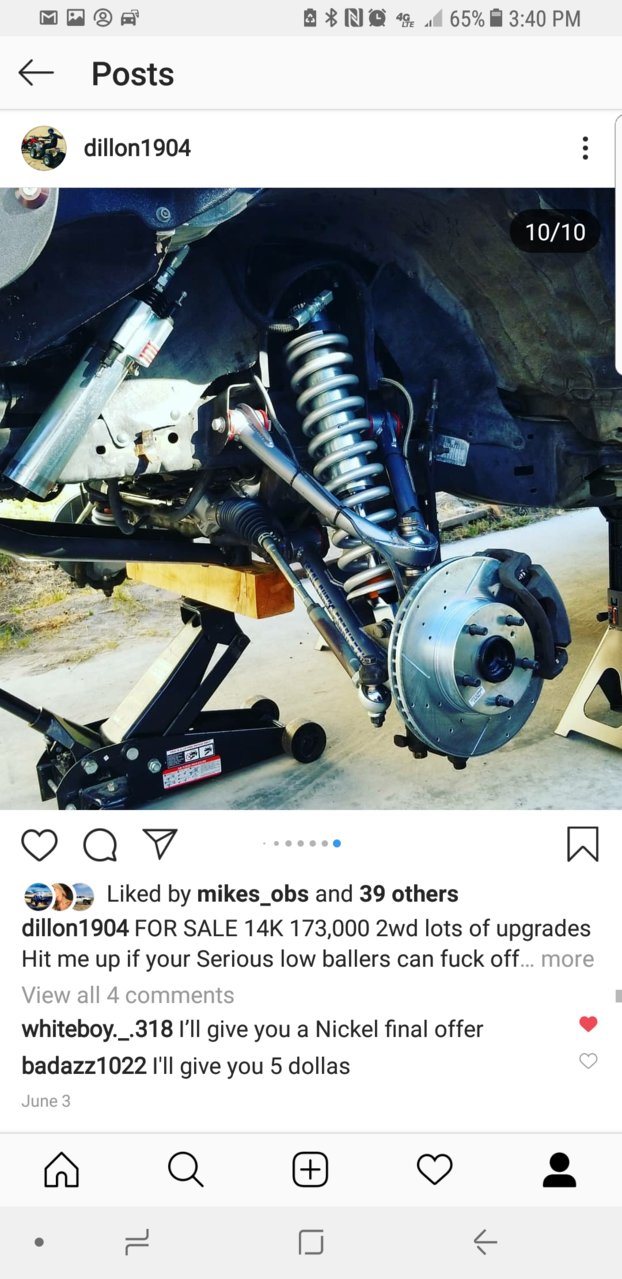

    Vehicle Modifications: TACOMA 2007 FRONT TOTAL CHAOS 5LUG ,LONG TRAVEL KIT 13" OF TRAVEL KING COIL OVER (550 POUND SPRING RATE) (18 INCH COIL) REAR BED CAGE 16" SMOOTH BODY FOX SHOCKS 2.5 2.0 / 2.5 BUMP STOPS FOX ICON ADD LEAF PACK WITH OEM SPRING 11" OF TRAVEL TRUCK COMES SPRING UNDER BY MANUFACTURE TOYOTA REGEAR TO 4.0 WITH AUBURN UNIT ENGINE 2TR-FE WITH AFE COLD AIR IN TAKE DOUG THORLEY HEADER MAGNAFLOW EXHAUST TIRE S NEW KO2 32/11.5 METHOD RIM 15" WITH -20MM OFF SET
    truck is still for sale 14k 173,000 in San Diego
    not trying to blow up this thread.

    Did this get fixed?
    Before selling it?

    Was thinking the same but I see a cross tube in there.

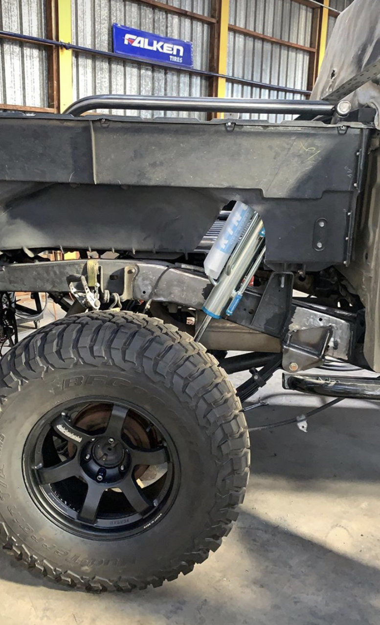

    Rear almost done....

    Someone please tell me I'm an idiot -- is it normal/right for the shocks to be at that severe of an angle (not in line with the axle movement vector)?]

    10* +/- full bump is a good estimate

    They did have to be slanted towards the cab because I had to go with 18”. Under a deadline and that’s all I could find in a type 1 bypass. I trust the shop doing the work, and they have been in contact with Tim @ DMZ while doing the rear. So fingers crossed
    Edit. Bypass style 1 not 2

    Cool! I don't doubt you or the shop, just curious. I was under the impression that it was best to have the shocks as in line with the direction of travel, but I also know LT throws some stuff out the window.
    Stoked to see it all together though!
