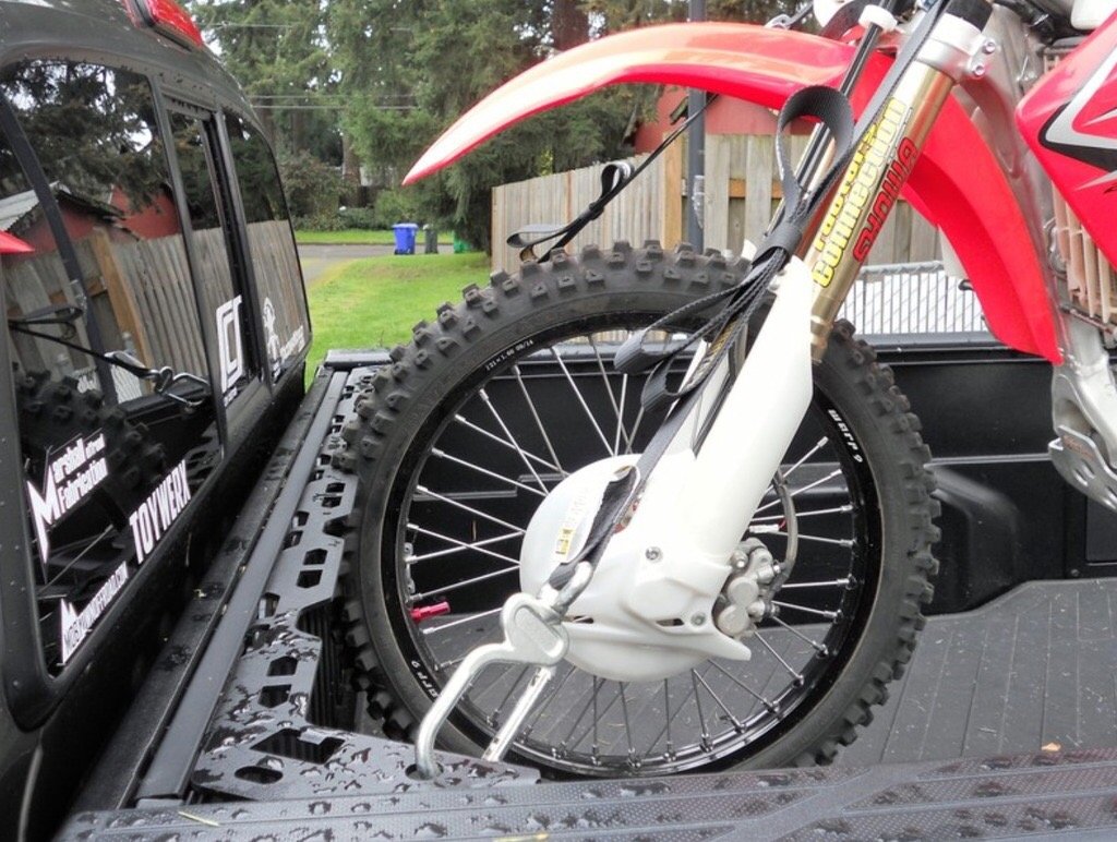

    Those who have bedsides... how do you strap your dirt bikes down cause I don’t trust the siderails or anything that attaches to them after installing my bedsides and seeing how small the screws are... or are they? I have a short bed so I don’t have those long bed hooks in the front of the bed which is annoying I just have 2 little d rings in the back of the bed.

    I’ve used the rails with tying down dirt bikes on my 6’ bed with the factory bed cleats. The rails do flex a bit if you really tighten it down but it holds.
    The side rails with the cleats or maybe D ring hooks on the rails are your best bet.

    Bed cleats work just fine. Like others have said they flex a little. Are you LT in the rear? If so just weld a couple tabs into the bed cage and go from there. That would be a super solid mount. I did that for a little while too but now made a hitch carrier and just use that if I need to haul the bike anywhere.

    https://ccrsport.com/ccr-sport-bed-buddy-motorcycle-tie-down-truck-rack-mid-size-57/
    What I have.
    Wheel chocks so the wheels don’t slip, and good tie down points for a moto bike

    @At The Helm makes a tire chock with tie downs
    https://athfab.com/product/front-bed-rail-tie-down-wheel-chock-system-for-05-15-toyota-tacoma/

    Check out L-track - lots of options with tying stuff straight to the bed floor.
