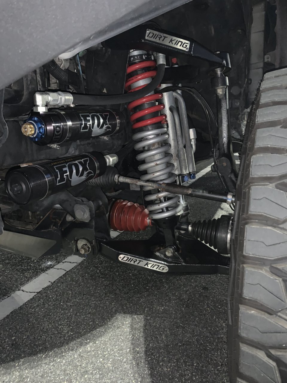

    Hey guys, Does anyone have experience with long travel and a drop bracket lift?
    I just bought this truck and it has both.
    All my trucks in the past have had drop bracket lifts, the last one I had I put through the ringer and it held up pretty nicely, definitely a few things that needed beefing up but still held. Im new to the long travel world and I’m trying to catch up on all the info this form has but at 4000 pages it’s going to take some time.
    The truck has dual spring rate coil overs , and triple bypasses , dirt logic long travel and pro comp 6 in lift, with 37’s for wheels.
    Once again I bought the truck with all this so asking why is probably going to be fallowed with me explaining how small my “package” is and that I’m trying to make up for it with this truck.....
    Any tips or tricks you got for me please send it.
    And...... truck porn: 2884A1BD-010F-48C1-A091-5A2B9357E685.jpg

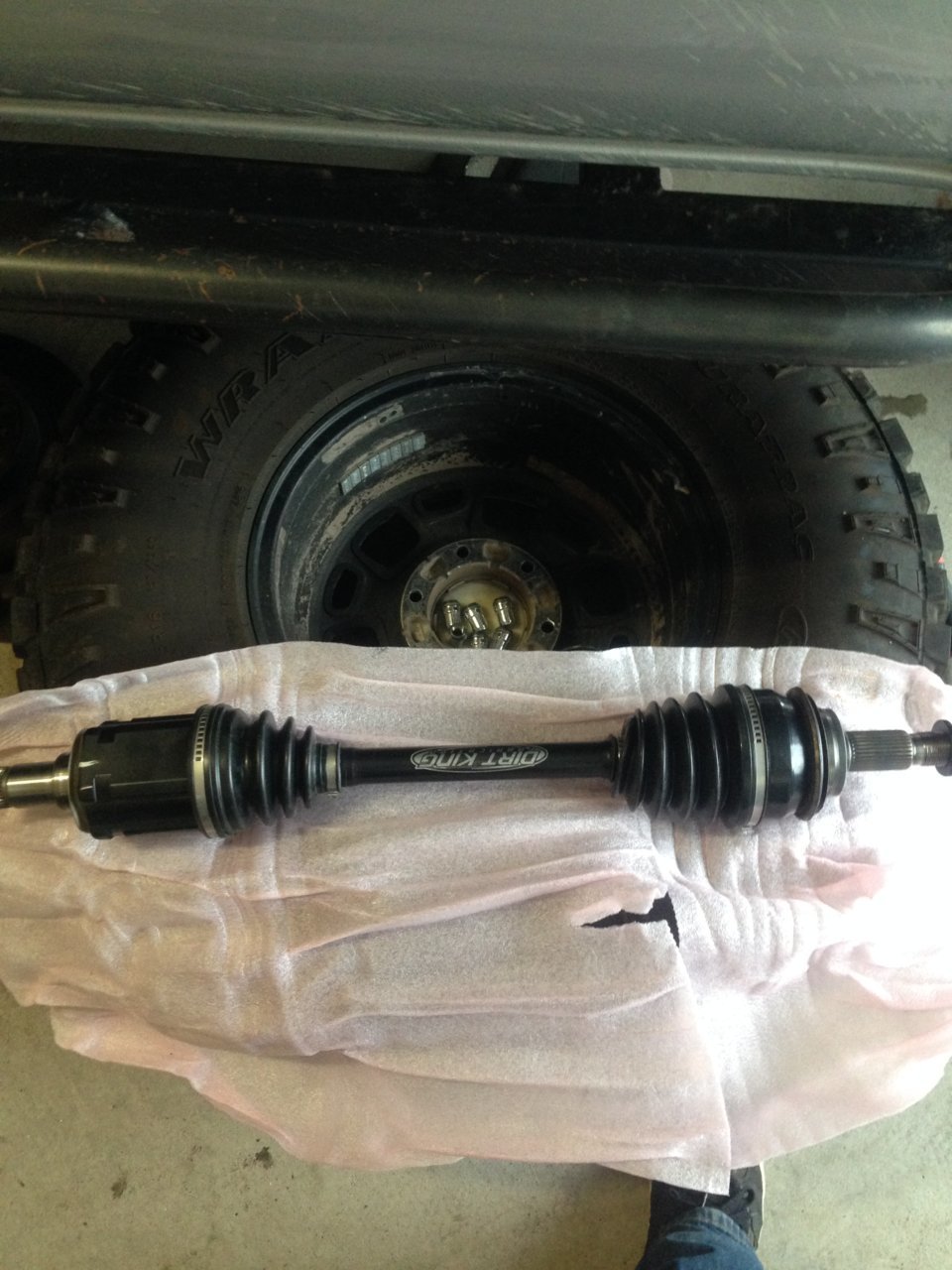

    As someone running the dirt king long travel kit, I am fairly certain that what you have is just their mid travel kit.
    Comparing your picture to what can be seen in mine, the change in angle of your lower control arm at the shock mounting point and mine is much different. And the amount of axle shaft showing between cv boots on yours is noticeably less than what is shown in mine. A few measurements could confirm this, but I’m 99% positive you are running their standard length mid travel kit paired with that drop bracket kit. That said, if the truck is working and performing to your liking, then run it and enjoy.
    004C0055-8313-454E-A8AA-2673975A98D8.jpg 6C0F2E53-0F02-47CC-8086-50FF24BE1ED1.jpg

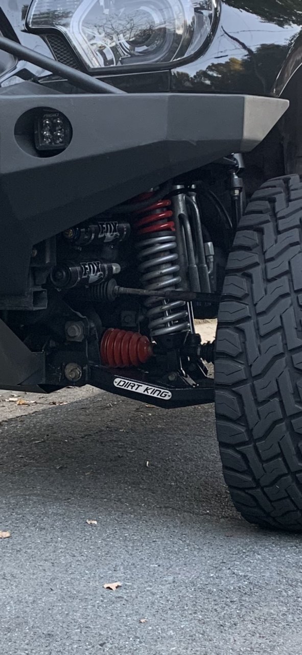

    How about from this angle?

    I think it might be the CVJ axle boots helping to give the illusion that it's just mid. Just by the visual.

    Is there a tierod extension? I recall seeing this build somewhere.

    Good points on the tie rod extension and different cv boot. Looks like there is some sort of tie rod extension or adapter in there.
    Either way, if you want to measure to be sure @Bfox I just measured mine from the lower control arm cam bolt to uniball and had about 18”
