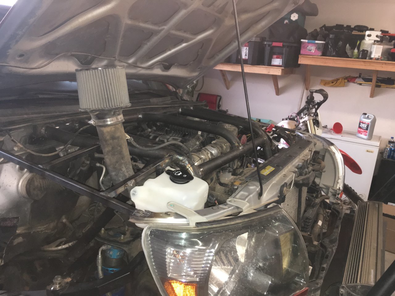

    So about my snorkel, do I just cut a hole in the hood and run it?

    Weld a can of baked beans to your hood for a cleaner install.

    Good idea, the welding process will help heat the beans up for maximum enjoyment.
