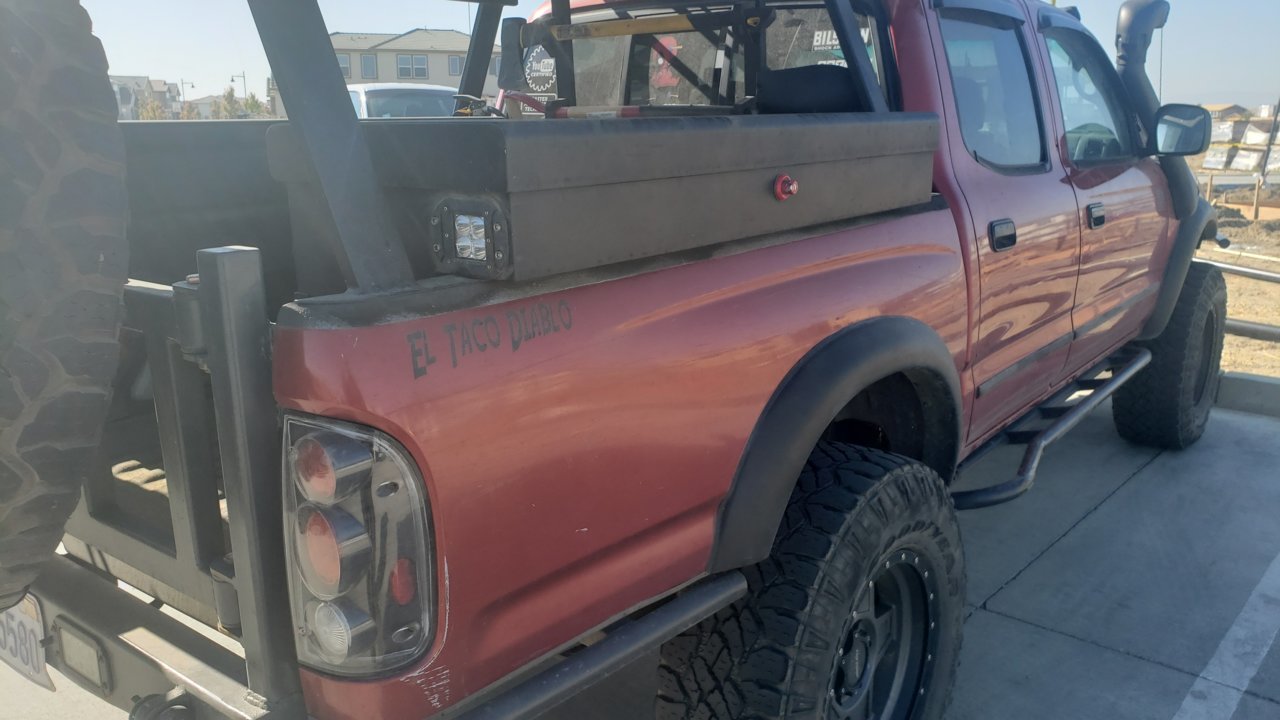

    maybe 63s with a healthy overload leaf or something could work good. just dont want it to be super bouncy for you cause thats all we experienced with them when we got some speed going.
    12s would work good with the 63s, could maybe even get away with 14s, depends if you want holes in the bed, but you can always make a nice cover for the holes if they end up going through.

    I'd be stoked to fit 12 inch in the back.

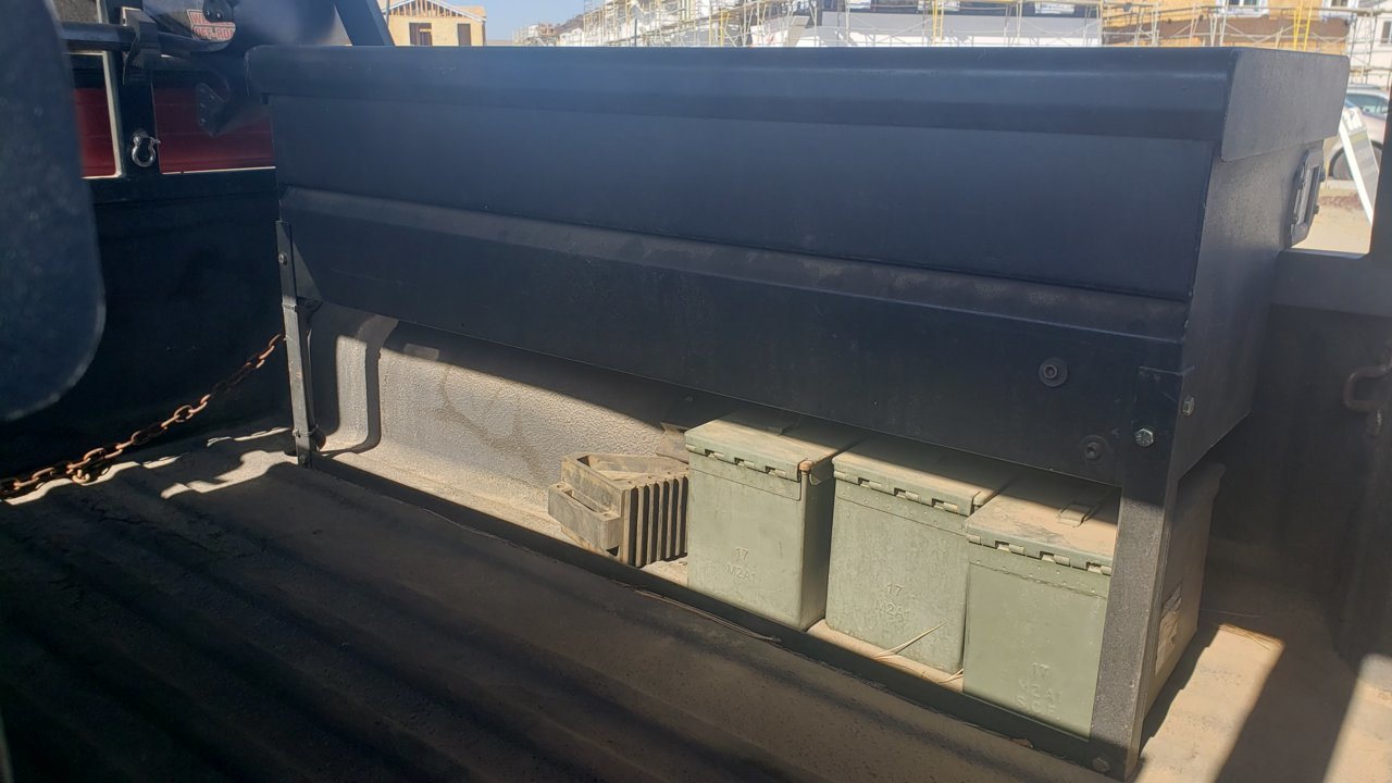

    I'm not opposed to cutting holes in the bed. But I just don't think it would work with my set up.20191015_104252.jpg 20191015_104321.jpg

    The ammo cans would be great covers welded in over the hoops.

    I have plenty of extras... that's an idea. The ones in the pic are full of trail spares and assorted shit I hope I never need.
