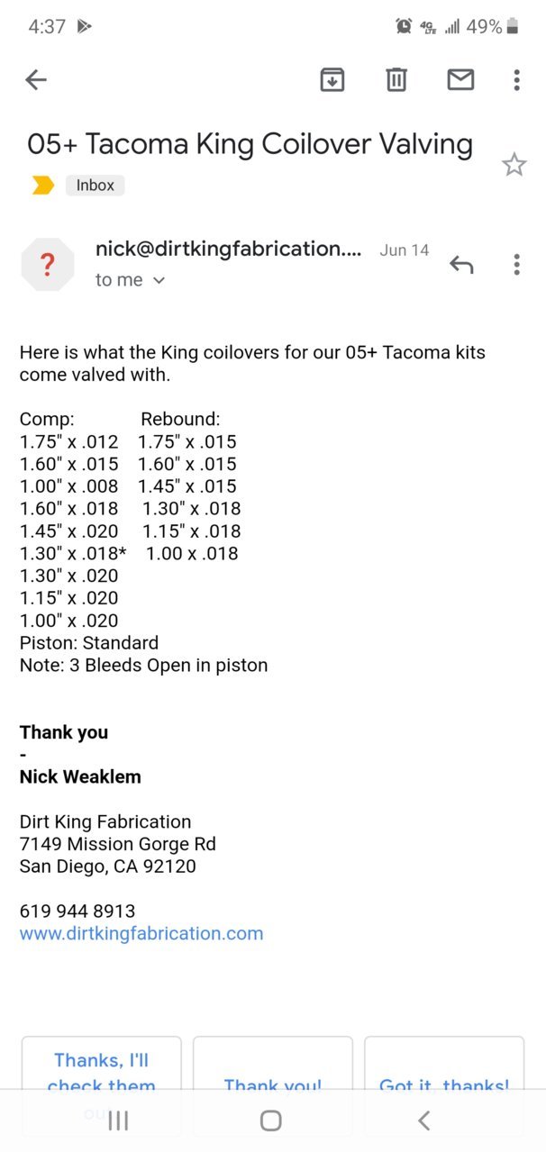

    @snowsk8air2 Do you happen to know what valving specs DK puts in for their 3.5 kit? Might have an opportunity to get in on a group buy. Or I might just get the 8” coilover and have @AccuTune Offroad tune it for me.

    @Supra4x4 see above. Looks like they updated their valving has changed some since I originally got mine. Knock out that 1.30x0.018 and leave all bleed holes open is what was in mine. But I’ve revalved twice now and it is way better. Latest is some top secret stuff my tuning help wouldn’t really give me specs for.
    Edit: rebound was a straight 15 stack when I got it and I’m at a straight 12 now I know.

    Good stuff, thanks guys. @snowsk8air2 Yeah I just want to get a baseline to start with. Accutune is about an hour drive away so If it isn't too my liking I can always have them help me out with either spring swaps or valving. I'm pretty much a noob when it comes to the shim stacks, I understand suspension cycle and shocks but how the oil works with the different shims and all that technology is new to me. Haven't gotten to crack anything open, but maybe eventually I'll be able to do my own rebuilds and valving.

    Well a good starting point would be what @Robertocritser posted. The only thing I’d change would be a straight 15 stack for rebound. That setup is basically what I had after my first revalve which I thought worked great until I started trying to keep up with linked trucks. Then 15/8 valving for rear bypasses. Nothing too fancy there
