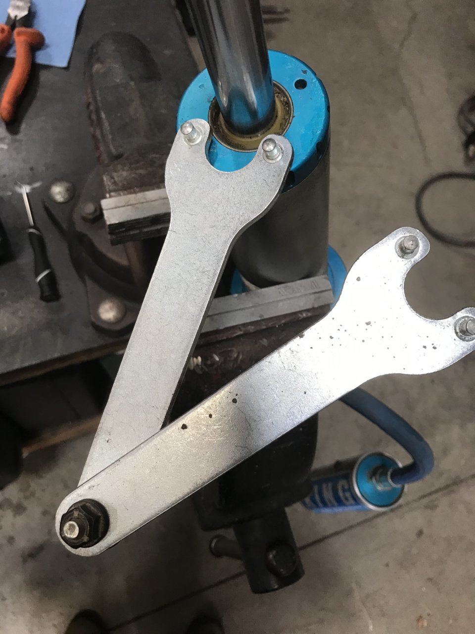

    I’m a cheap bastard. Didn’t buy the special spanner. Used two spanner’s from angle grinders. Straight pimpC1435CDA-B958-4623-BEC5-81809BA415BD.jpg
