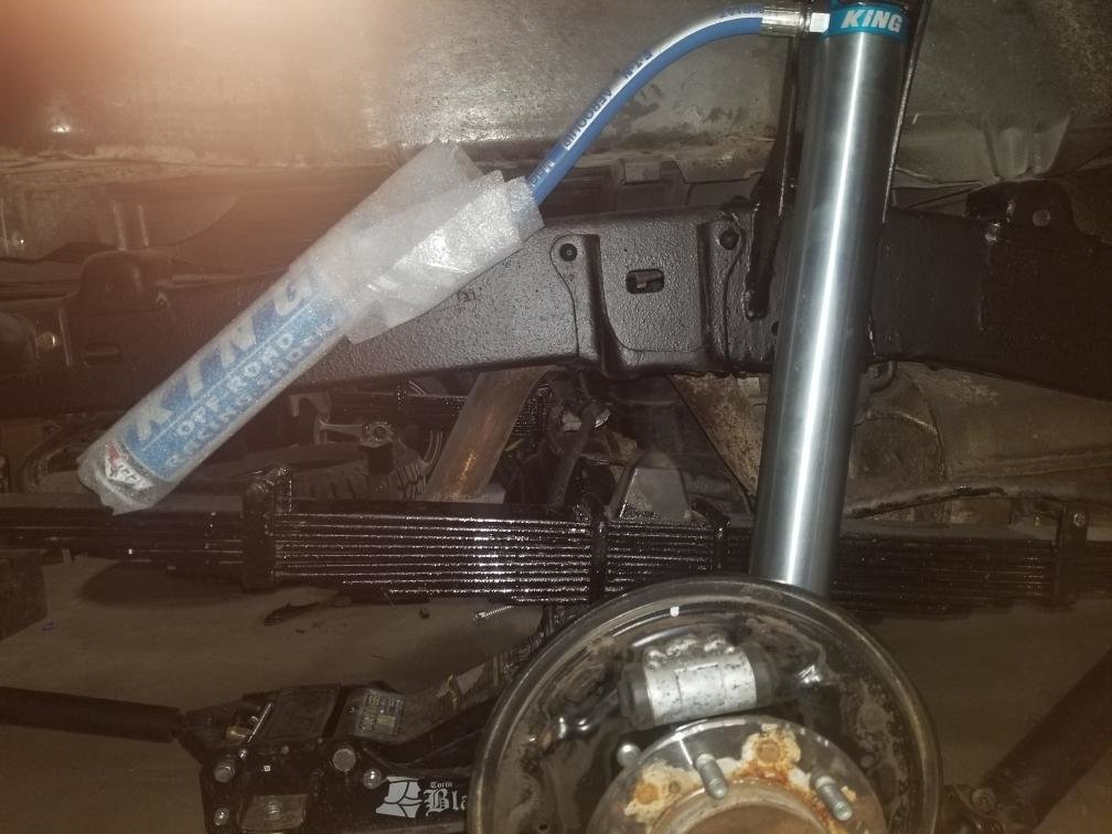

    dumb question -- how easy is it to rotate the hose fittings on king shocks? I'm getting my rears installed and the reservoir hose is inconvenient for mounting. It is easy to rotate/loosen at the shock head?

    New style with the o-ring is just loosening the nut and rotating them - releasing the pressure first would probably be a good idea.

    Have any pics? What type of fitting and how much do you need to rotate?

    I assume they're the new style -- <1 year old. Releasing the pressure by just leaving them full extension, or what?

    Sure, I'll snag some pics, standby

    Let the nitrogen out and then back off the nut enough to let the hose rotate. NPT fittings aren't put on Kings any more - not for awhile so you should be set.

    Cool, I'll try that. It would just be super convenient to spin those around. How much of a hassle is recharging it?

    If you have a nitrogen tank and a setup to recharge the shock (basically a regulator and no-loss schrader valve connection), it's super easy. If you don't, you'll need to take it somewhere to have them do it.

    I see. You have a relocation. Yes, as stated, release the nitrogen pressure and loosen the fitting enough to allow the resi to rotate. Just try to not loosen it too much as you may loose fluid.
