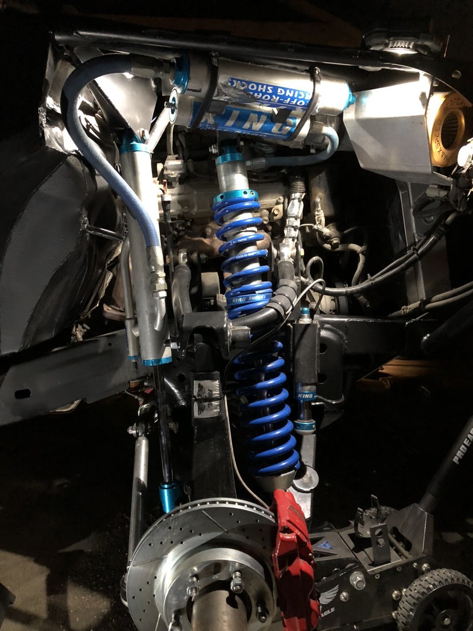

    Dual rate stop definitely looks like it should be lowered imo. In that pic, it looks like you'd hit coil bind in the 500 before the dual rate stop.
    You should also be able to adjust your bypasses super easily without anymore than just pulling a wheel.

    Do you know the current valving in the truck...front and rear?... are your tubes mostly closed or open front and rear?
    Dual shock setups typically the coilover is pretty light valved 10/8 or 10/10 or 12/8 with all the free bleeds in the piston open.
    Bypasses a decent start point for a linked truck is 20 stack on compression and like 10 or 12 on rebound with all the free bleeds closed. And start with all your tubes open and turn em in from there depending on how the truck is behaving.
    Air bumps at like 150psi
    That's a good start point
