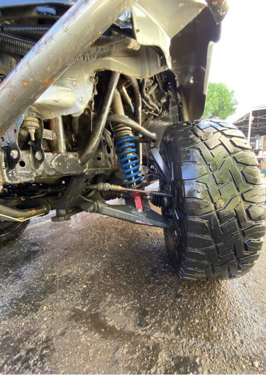

    why were the coil buckets cut out?

    Yes
    looks like they put a 10” dual rate CO on a +3.5” kit ?

    seems like a strange choice when all that work isnt necessary

    yeah even if the kit could cycle more travel that cv couldn’t pull any more than what an 8” CO on a 3.5” kit could pull

    Looks like alot of hack work. Shock is even king with sway away parts.

    That is a friend of my friends truck.
    I don’t know too much about it, but every time I’ve seen it, it’s been in rougher looking shape.
    Idk if it’s been beat on, or just kinda neglected in the cosmetic/ maintenance department. That just my impression of it.
    the stuff the guys done to it may be solid, but everything is just too messy for my tastes.

    Exactly, lots of stuff on this truck is mis matched to make things work

    Friend didn’t end up getting it. It was in pretty rough shape. Needed a lot work. the cage was not done right. It was pretty cheap but just wasn’t for my friend
