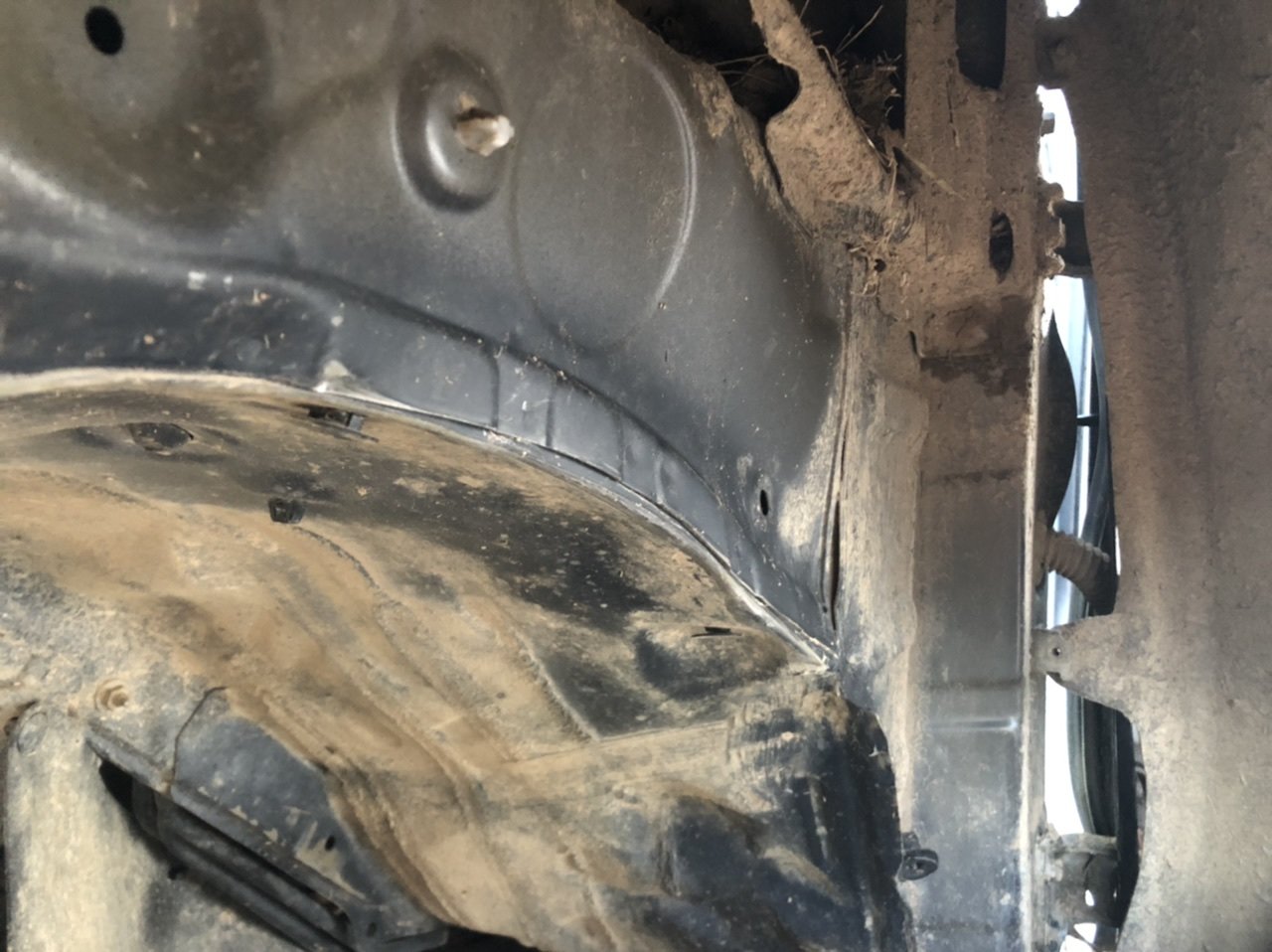

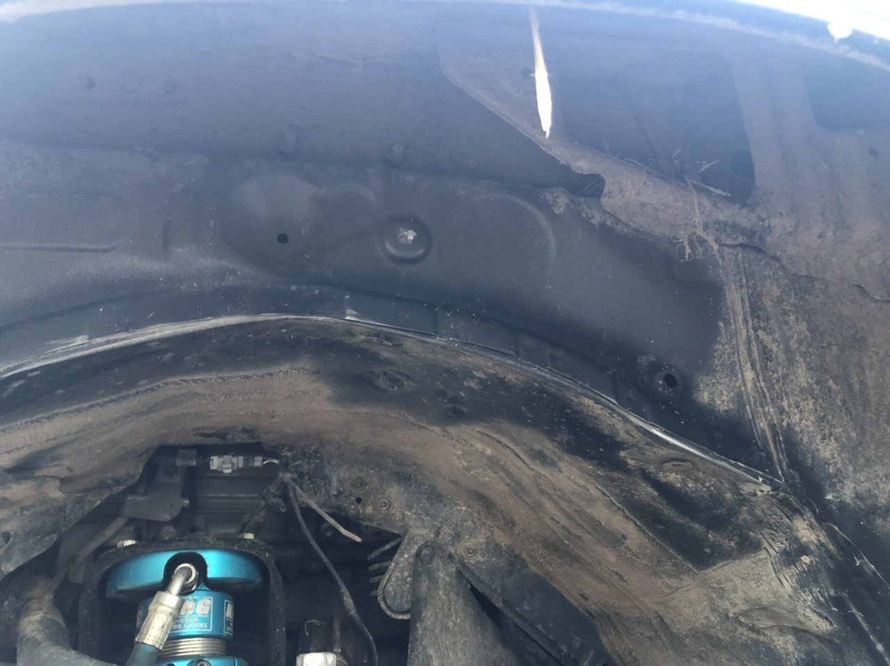

    i just extended my bumps a touch for now to stop it. Mine buckled so bad it pulled my fender away from the hood. I have a decent gap on the passenger side now compared to driver.

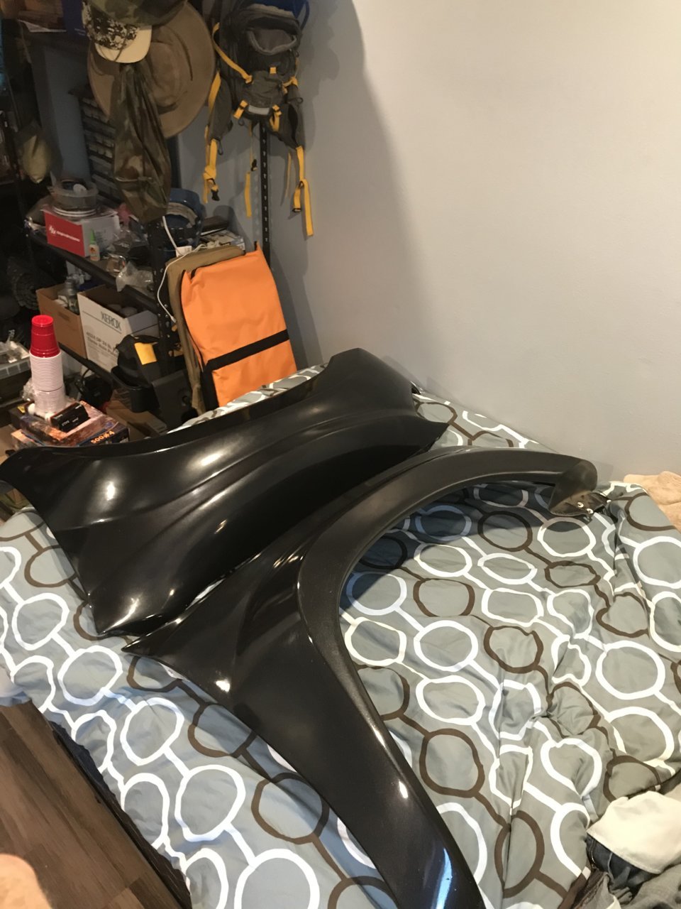

    F*** yeah. Pick up some used glassworks fenders over the weekend from another member. It's quite exciting, just another peice to the puzzle. So glad they're already painted, I think I'll probably run the black for while, should look too out of place with a MGM truck.

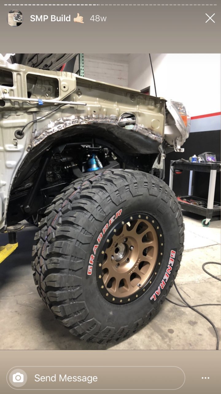

    Cage all the things. And replace that sheet metal with tube.
    Somewhat more seriously, check your rad support under the headlights for cracks too.

    cut it out and tube the front core support, or you can cut and clear the sheet metal support, and weld back some plates to connect again like @lt_yota did. Here’s a pic, but there’s more on his instagram.
