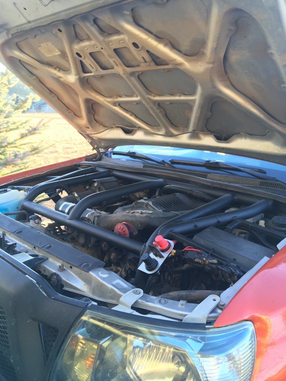

    The sheer amount of wiring going to the fuse box makes it very difficult to move from the stock location. I just finished my engine cage a few weeks ago and dealing with that was one off the bigger pita for the process. Just tuck it up as high as you can. Also if you’re keeping your wiper motor and wipers, grab a 1st gen washer fluid reservoir and pump. I think there’s 2 different sizes so get the smaller one. Much easier to mount than the 2nd gen gigantic one.
    Here’s the only pic I got on my phone of my setup.
    Edit: superchargers are stupid and take up way too much room. Without one you’ll have a lot more room to build and design your cage.

    Looks like a PITA to change plugs, probably take the SC off anyway during that process?

    With enough extensions and Wobblies it can be done without removing the sc and wouldn’t be too bad now that I don’t have inner fenders.
